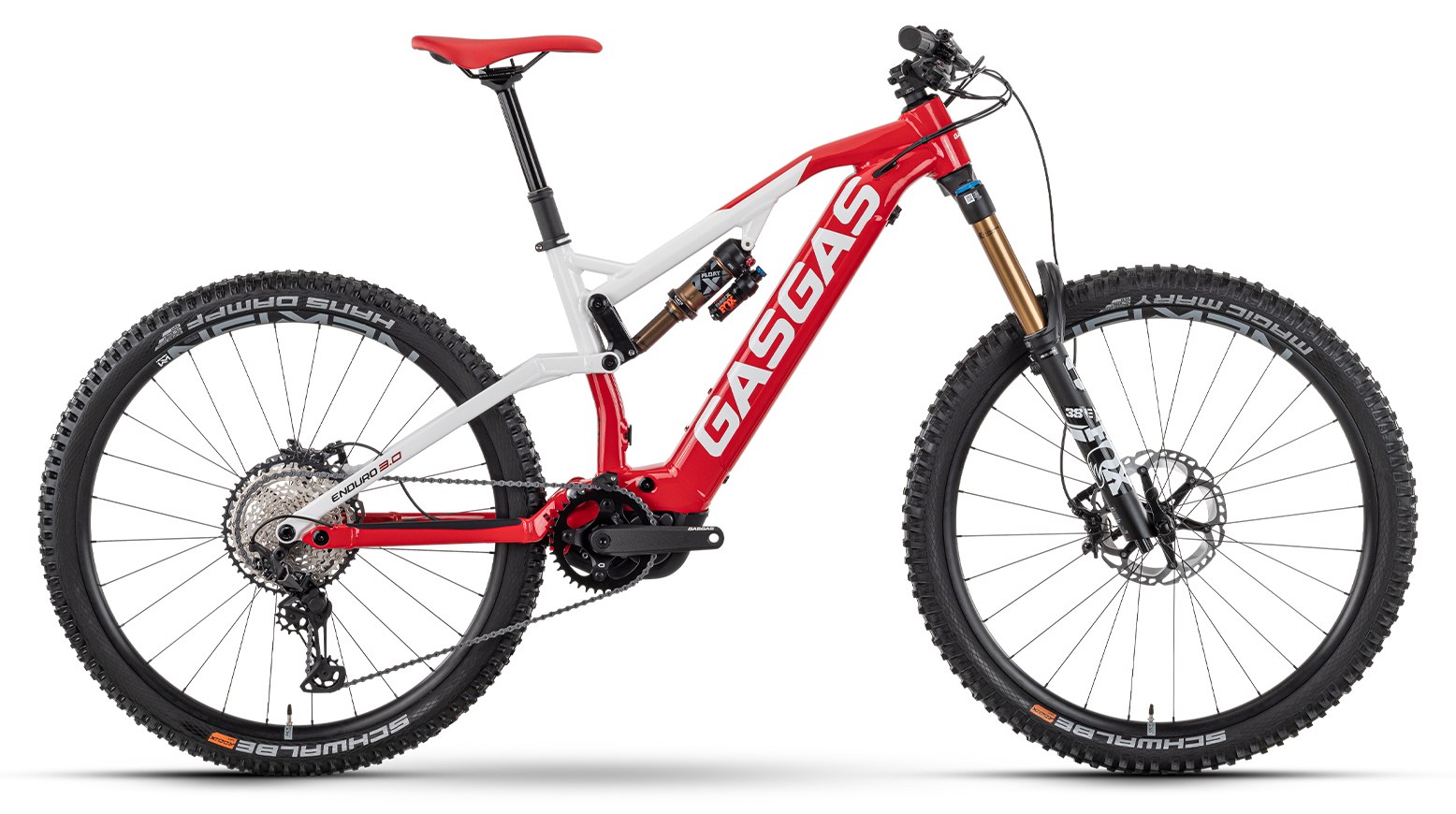

The GasGas G Enduro was the eMTB arm of the KTM-group brand's first bicycle push, and it is Yamaha-powered rather than Bosch. The flagship 3.0 ran a Yamaha PW-X3 motor (85Nm, six modes) and a 720Wh Simplo battery in an aluminium frame with 170mm up front and 160mm at the rear, a slack 64-degree head angle and short 460mm chainstays on 29in wheels.
Trim separation was clear. The 3.0 (£5,299) got FOX Float 38 Factory / Float X Factory suspension and SRAM GX Eagle. The 2.0 (£4,199) shared the same frame and geometry but stepped to RockShox Domain R and a Shimano Deore drivetrain. The entry 1.0 (£3,999) dropped to a Yamaha PW-X2 (80Nm), a 630Wh battery, 160mm RockShox 35 Silver R coil fork and a mixed-wheel 29F/27.5R layout with a steeper 68-degree head angle on the medium.
It is honest, hard-wearing kit rather than boutique, with own-brand GASGAS finishing parts throughout and a claimed weight around 26.3 to 26.4kg on the alloy builds. This model has been discontinued, so any examples are now end-of-line or used stock.
