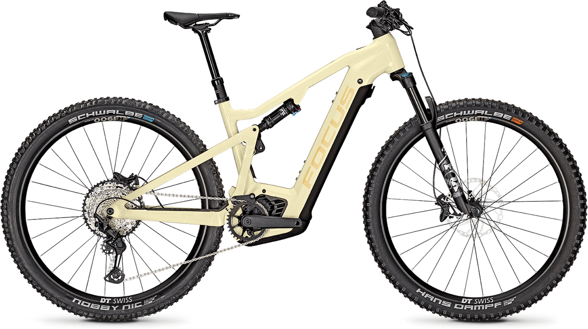

The 2023 Focus THRON² was the brand's affordable do-it-all aluminium trail and touring e-MTB: a 7005 hydroformed alloy frame with 130mm of F.O.L.D. rear travel, 29in wheels and a Bosch Performance CX Gen 4 motor (85 Nm, 250 W) fed by a removable PowerTube battery (750Wh on most builds, 625Wh on the size S and on the entry 6.7). A relaxed 66 degree head angle, 75 degree seat angle and a long 455mm chainstay across every size give it a stable, comfortable touring stance rather than an aggressive trail attitude, with reach growing sensibly from 415mm (S) to 500mm (XL).
The six-bike range split into plain trail builds (6.7, 6.8, 6.9) and fully equipped EQP versions with rack, fenders, lights and kickstand (6.7 EQP, 6.8 EQP and the 6.9 EQP ABS). The 6.7 (£4,399) paired an SR Suntour Zeron fork with Shimano Deore 11-speed and Maxxis Minion DHF rubber; the 6.8 (£5,099) stepped up to a 130mm SR Suntour Aion 35 fork, SRAM DB8 four-piston brakes and Shimano XT 12-speed; and the range-topping FOX 34-equipped 6.9 (£5,599) added DT Swiss H1900 wheels and Schwalbe Hans Dampf and Nobby Nic tyres. The EQP models swap to commuter Smart Sam tyres, with the 6.9 EQP ABS adding a Magura CT-ABS anti-lock braking system and SR Suntour Mobie fork.
Claimed weights ran from 25.8kg on the 6.7 up to 28.6kg on the loaded 6.8 EQP. Every build kept the same alloy frame, F.O.L.D. linkage and Bosch Gen 4 drive, so the differences were almost entirely fork, brake, drivetrain and equipment level.
This generation of THRON² is discontinued. Focus carried the model forward into 2024 with the same Bosch Smart System Gen 4 platform before later moving it onto the newer Bosch generation with 600/800Wh batteries and the PowerMore range extender, making the 2023 bike an early year of the Smart System era.
