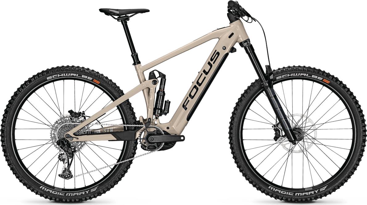

The 2023 Focus SAM2 was the brand's aluminium e-enduro, rebuilt around the F.O.L.D. linkage with 170 mm of travel front and rear on 29in wheels and a Bosch Performance Line CX motor (85 Nm) fed by an integrated, removable 625 Wh PowerTube. Focus kept the cockpit deliberately simple, specifying Bosch's pared-back Purion display across the whole range. The geometry was firmly descent-focused, with a slack head angle, a long wheelbase and a FOCUS Flip Chip that switches between a 64.1 degree high setting (29in, 450 mm chainstays) and a 64.8 degree low setting (430 mm chainstays) and also allows a 27.5in mullet rear wheel.
The 2023 launch range ran three aluminium builds, all on the 625 Wh Purion package. The 6.7 was the value pick with a RockShox Domain R fork, RockShox Deluxe Select shock, SRAM NX Eagle shifting and SRAM Guide T brakes at a claimed 25.3 kg. The mid 6.8 stepped up to a RockShox ZEB fork with a Super Deluxe Select+ air shock, SRAM GX Eagle and SRAM Code R brakes on Schwalbe Magic Mary rubber. The flagship 6.9 added a FOX 38 Factory Grip 2 fork in Racing Orange, a FOX Van Performance coil shock, Shimano XT shifting and XT four-piston brakes, weighing a claimed 26.2 kg.
At UK launch the SAM2 started from 4,699 GBP for the 6.7, with the 6.8 at 5,199 GBP, undercutting much of the direct-sales competition for a full-power 170 mm e-enduro. It is now discontinued. It was superseded within the same model name by a revised SAM2 that moved to Bosch's Smart System, gained a 180 mm fork and 750 Wh battery option, switched the Flip Chip for an angle-adjust headset, and later added a Bosch CX Race flagship.

MotorBosch Performance Line CX Gen 4 · 85 Nm · all trims
BatteryBosch PowerTube 625 · 625 Wh · all trims
Travel F/R170/170 mm · all trims
FrameAluminium · all trims
ForkRock Shox Domain R 29, 110x15 mm, 44 mm rake, 170 mm travelRock Shox ZEB 29 Boost, Charger R, DebonAir, 110x15 mm, 44 mm rake, 170 mm travelFOX 38 Float Factory 29, E-Bike, Grip 2, 110x15 mm, 44 mm rake, 170 mm travel (Racing Orange)
ShockRock Shox Deluxe Select, 230/65 mm, hardware: 25.0 x 8.0 mmRock Shox Super Deluxe Select+, 230/65 mm, hardware: 25.0 x 8 mmFOX Van Performance Coil, 230/65 mm, hardware: 25.0 x 8 mm
HeadsetACROS ZS56/ZS56 (ICR), FOCUS C.I.S. Integrated · all trims
StemFOCUS C.I.S. integrated, 50 mm, 0 deg, 35 mm, aluminium · all trims
HandlebarAluminium, 800 mm, rise: 30 mm, backsweep: 9 degAluminium riserbar, 780 mm, rise: 30 mm, backsweep: 9 degRaceFace Chester 35, aluminium, 780 mm, rise: 35 mm, backsweep: 8 deg
GripsFOCUS Locker SLRaceFace Getta Grip
SaddleFOCUS Trail SLFOCUS Trail SLProxim W350
SeatpostPost Moderne dropper post PM-MT171, 31.6 mmPost Moderne dropper post PM-171, 31.6 mmPost Moderne dropper post PM-171, 31.6 mm
BrakesSRAM Guide T, hydraulic disc (220 mm rotors, front and rear)SRAM Code R, hydraulic disc, post mount; 220 mm rotors per the 6.8 product-page features text (frame is post mount 203 mm)Shimano XT M8120, 4 piston (front and rear); rotor size not stated on the product page (frame is post mount 203 mm)
Rear derailleurSRAM NX Eagle, 12-speedSRAM GX Eagle, 12-speedShimano Deore XT M8100, 12-speed
CrankSamox EC40 ISIS (front: 34T, rear: 11-50)Samox EC40 ISIS (front: 34T, rear: 10-50)Samox EC40 ISIS (front: 34T, rear: 10-51)
ShiftersSRAM SX Eagle, 12-speedSRAM GX Eagle, 12-speedShimano Deore XT M8100, 12-speed
CassetteSRAM PG-1230 Eagle, 12-speedSRAM PG-1230 Eagle, 12-speedShimano SLX M7100, 12-speed
ChainSRAM SX Eagle, 12-speedSRAM NX Eagle, 12-speedShimano SLX CN-M7100, 12-speed
DrivetrainSRAM NX Eagle, 12-speed; Samox EC40 ISIS (front: 34T, rear: 11-50); SRAM SX Eagle, 12-speed; SRAM PG-1230 Eagle, 12-speed; SRAM SX Eagle, 12-speedSRAM GX Eagle, 12-speed; Samox EC40 ISIS (front: 34T, rear: 10-50); SRAM GX Eagle, 12-speed; SRAM PG-1230 Eagle, 12-speed; SRAM NX Eagle, 12-speedShimano Deore XT M8100, 12-speed; Samox EC40 ISIS (front: 34T, rear: 10-51); Shimano Deore XT M8100, 12-speed; Shimano SLX M7100, 12-speed; Shimano SLX CN-M7100, 12-speed
WheelsRODI TRYP30, 30-622; Novatec D041 front (15x110 mm) / Novatec D462 rear (12x148 mm) hubsRODI TRYP30, 30-622; Novatec D041 front (15x110 mm) / Novatec D162 Disc rear (12x148 mm) hubsRaceFace AR30 Offset; Novatec D041 front (15x110 mm) / Novatec D162 Disc rear (12x148 mm) hubs
TyresMaxxis Minion DHF, EXO, 63-622 (front and rear)Schwalbe Magic Mary 2.6 Super Trail Soft (front) / Schwalbe Magic Mary 2.6 Super Gravity Soft (rear), 65-622Schwalbe Magic Mary 2.6 Super Trail Soft (front) / Schwalbe Magic Mary 2.6 Super Gravity Soft (rear), 65-622
Weight25.3 kg25.8 kg26.2 kg
Price£4,699£5,199
