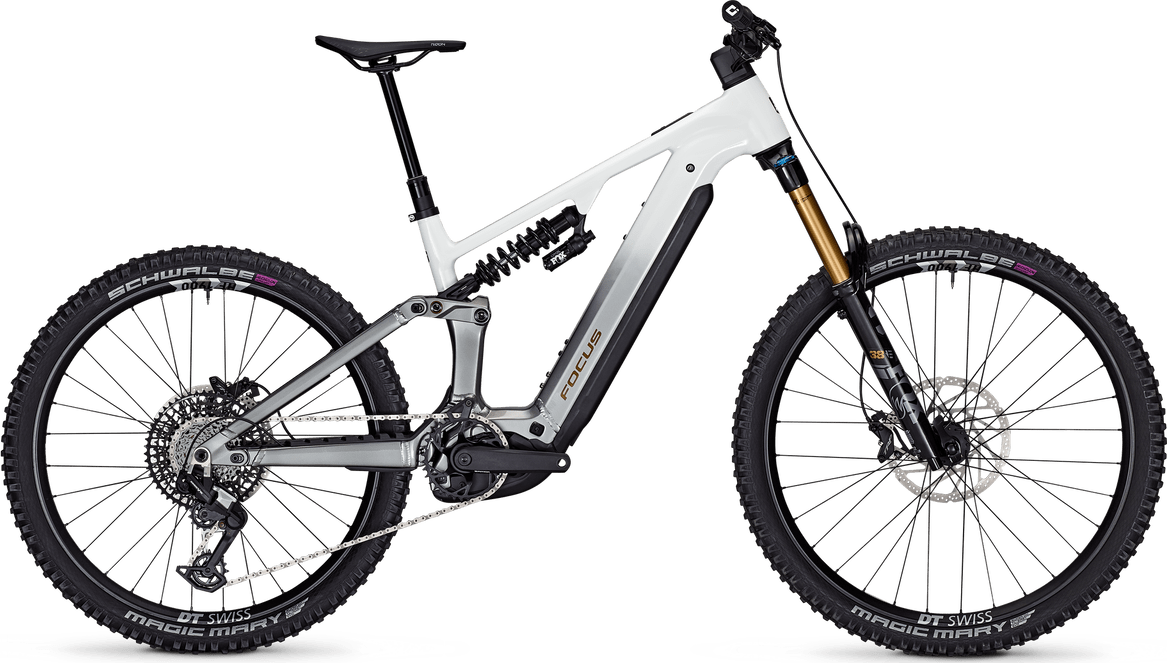

The SAM² is Focus's full-power enduro eMTB, and the current generation is a ground-up redesign over the older 180/170mm 29er. It now runs 170mm of fork travel and 165mm at the rear through the F.O.L.D. Gen2 linkage, a dedicated mullet wheel setup and a 7005 aluminium frame. Power comes from the Bosch Performance Line CX Gen 5 with a removable PowerTube, available as a 600Wh or 800Wh pack and extendable with a 250Wh range extender.
Adjustability is a core part of the package: a two-position angle-adjust headset shifts the head angle between 63.5 and 64.5 degrees, and a rear flip-chip swaps the chainstay between 441mm and 448mm. Geometry is squarely enduro, with a 77.5 degree effective seat angle and reach running from 435mm on the S to 520mm on the XL across four sizes.
Three builds are offered in the UK. The 6.8 at £6,299 pairs a Fox 38 Rhythm fork and DHX coil with Shimano Deore four-piston brakes and a mixed Maxxis Assegai/Minion DHR II tyre set. The 6.9 at £7,899 steps up to a Fox 38 Factory Grip X2, SRAM Eagle 90 Transmission, TRP EVO Pro brakes and DT Swiss HF 1900 wheels. The 6.0 flagship at £8,999 runs a RockShox ZEB Ultimate, Vivid coil, SRAM GX Transmission AXS and Maven brakes, and is the lightest at a claimed 25.8kg with the 600Wh pack.
All three carry coil shocks as standard and four-piston brakes on 220mm rotors front and rear, so the range is consistently set up for sustained descending rather than all-day pedalling efficiency.

| Fork | Fox 38 Rhythm, Grip 3-Position, 170 mm | Fox 38 Factory, Grip X2, 170 mm | RockShox ZEB Ultimate, DebonAir+, Charger 3.1 RC2 with ButterCups, 170 mm |
| Shock | Fox DHX Performance, Coil, 350/450/500/600 lbs (S/M/L/XL), 165 mm | Fox DHX Performance, Coil, 350/450/500/600 lbs (S/M/L/XL), 165 mm | RockShox Vivid Ultimate, Coil, 350/450/500/600 lbs (S/M/L/XL), 165 mm |

| Wheels | WTB STi30 TGH alloy, mullet (29" front / 27.5" rear); hubs Formula DC-611 (F) / DC-648 (R) | DT Swiss HF 1900 alloy, mullet (29" front / 27.5" rear) | DT Swiss HFR 1700 alloy, mullet (29" front / 27.5" rear) |
| Tyres | front Maxxis Assegai DoubleDown 29x2.5" / rear Maxxis Minion DHR II 27.5x2.5" | Schwalbe Magic Mary, Super DH casing, ADDIX Ultra Soft; front 29x2.4" / rear 27.5x2.4" | Schwalbe Magic Mary, Super DH casing, ADDIX Ultra Soft; front 29x2.4" / rear 27.5x2.4" |
