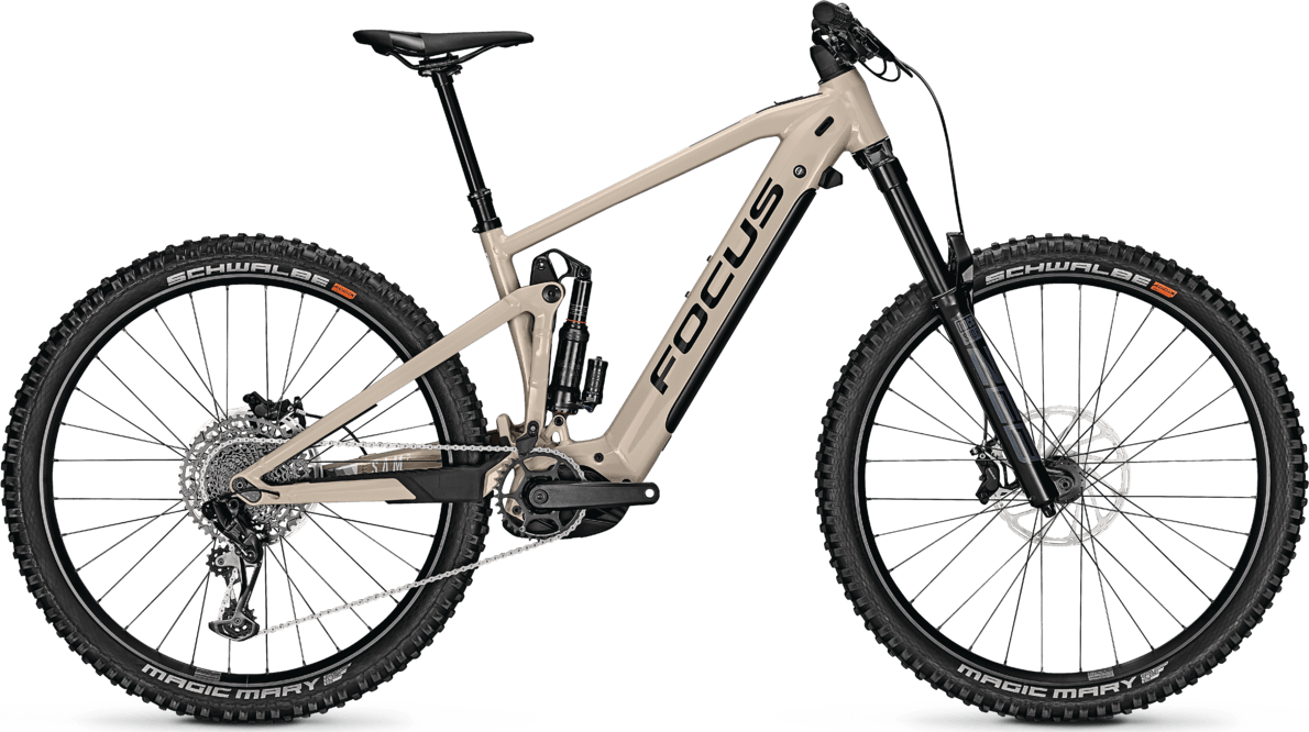

The Focus SAM² (2022) was the German brand's full-fat enduro e-MTB, built around a 7005 hydroformed aluminium frame with 170 mm of F.O.L.D. travel front and rear, 29in wheels and a Flip Chip that drops the chainstays to 430 mm and slackens the head angle for a 27.5in or mullet 'Drifter' setup. Power comes from the Bosch Performance Line CX Gen 4 (85 Nm) fed by a removable 625 Wh PowerTube and run through the slick C.I.S. integrated cockpit.
Three trims made up the UK range. The 6.7 (around £4,699) paired a RockShox Domain fork with SRAM NX/SX Eagle and Guide T brakes; the 6.8 (around £5,199) stepped up to a RockShox ZEB, Super Deluxe shock and SRAM GX Eagle with Code brakes; and the flagship 6.9 (listed at €6,699) ran a FOX 38 Factory fork, FOX Van coil shock and a Shimano XT 1x12 drivetrain with four-piston XT brakes. Claimed weights ranged from 25.3 kg to 26.2 kg.

MotorBosch Performance Line CX Gen 4 · 85 Nm · all trims
BatteryBosch PowerTube 625 · 625 Wh · all trims
Travel F/R170/170 mm · all trims
FrameAluminium · all trims
ForkRock Shox Domain R 29, 110x15 mm, 44 mm rake, 170 mm travelRock Shox ZEB 29 Boost, Charger R, DebonAir, 110x15 mm, 44 mm rake, 170 mm travelFOX 38 Float Factory 29, E-Bike, Grip 2, 110 x 15 mm, 44 mm rake, 170 mm travel
ShockRock Shox Deluxe Select, 230/65 mm, hardware: 25.0 x 8.0 mmRock Shox Super Deluxe Select+, 230/65 mm, hardware: 25.0 x 8 mmFOX Van Performance Coil, 230/65 mm, hardware: 25.0 x 8 mm
HeadsetACROS ZS56/ZS56 (ICR), FOCUS C.I.S. Integrated · all trims
StemFOCUS C.I.S. integrated, 50 mm, 0°, 35 mm, aluminium · all trims
HandlebarAluminium, 800 mm, rise: 30 mm, backsweep: 9°Aluminium, riserbar, 780 mm, rise: 30 mm, backsweep: 9°RaceFace Chester 35, aluminium, 780 mm, rise: 35 mm, backsweep: 8°
GripsFOCUS Locker SLRaceFace Getta Grip
SaddleFOCUS Trail SLFOCUS Trail SLProxim W350
SeatpostPost Moderne dropper post PM-MT171, 31.6 mmPost Moderne dropper post PM-171, 31.6 mmPost Moderne dropper post PM-171, 31.6 mm
BrakesSRAM GUIDE TSRAM Code RShimano XT M8120, 4 piston
Rear derailleurSRAM NX Eagle, 12-speedSRAM GX Eagle, 12-speedShimano Deore XT M8100, 12-speed
CrankSamox EC40 ISIS (front 34T) · all trims
ShiftersSRAM SX Eagle, 12-speedSRAM GX Eagle, 12-speedShimano Deore XT M8100, 12-speed
CassetteSRAM PG-1230 Eagle, 12-speed (10-50)SRAM PG-1230 Eagle, 12-speed (10-50)Shimano SLX M7100, 12-speed (10-51)
ChainSRAM SX Eagle, 12-speedSRAM NX EagleShimano SLX CN-M7100, 12-speed
DrivetrainSRAM NX Eagle, 12-speed; Samox EC40 ISIS (front 34T); SRAM SX Eagle, 12-speed; SRAM PG-1230 Eagle, 12-speed (10-50); SRAM SX Eagle, 12-speedSRAM GX Eagle, 12-speed; Samox EC40 ISIS (front 34T); SRAM GX Eagle, 12-speed; SRAM PG-1230 Eagle, 12-speed (10-50); SRAM NX EagleShimano Deore XT M8100, 12-speed; Samox EC40 ISIS (front 34T); Shimano Deore XT M8100, 12-speed; Shimano SLX M7100, 12-speed (10-51); Shimano SLX CN-M7100, 12-speed
WheelsRODI TRYP30, 30-622RODI TRYP30, 30-622RaceFace AR30 Offset
TyresMaxxis Minion DHF, EXO, 63-622Schwalbe Magic Mary, front 2.6 Super Trail Soft / rear 2.6 Super Gravity Soft, 65-622Schwalbe Magic Mary, front 2.6 Super Trail Soft / rear 2.6 Super Gravity Soft, 65-622
Weight25.3 kg25.8 kg26.2 kg
Price£4,699£5,199€6,699
