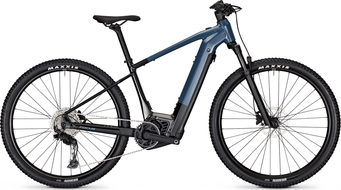

Focus Jarifa² 6.7
Focus
Jarifa² 6.7 2024
DiscontinuedTrail eMTBLegacy · 1.6/10iFreshness 1.6/10
Travel F/R
100mm / —
Wheels
29F / 29R
Frame
Aluminium
Weight
23.5 kg
Price
From £3,399
View the Focus Jarifa² 6.7 on Focus’s site
Focus Jarifa² 6.7 2024
From £3,399
EMTB Forums verdict
The Focus Jarifa² was the brand's Bosch-powered aluminium e-hardtail, pitched as a crossover machine with mountain-bike DNA for commuting, fitness rides and light trails rather than technical descents. For 2024 it ran the Bosch Performance Line CX motor (85 Nm) with a removable PowerTube battery, a 100 mm SR Suntour fork up front and a 150 kg permissible system weight, with mounting points for racks, mudguards and trailers built into the 7005 hydroformed alloy frame.
Three trims were offered. The 6.7 (£3,399) is the value entry point with a 625 Wh battery, a coil SR Suntour XCR 34 fork and a Shimano CUES 1x10 drivetrain on a KMC chain. The 6.8 (£3,899) steps up to a 750 Wh battery (625 Wh in XS and S), an air-sprung XCR 34 LOR fork, CUES 1x11 shifting and the Kiox 300 display. The 6.9 (£3,999) is the most trail-capable, adding a Raidon air fork, Shimano Deore/XT 12-speed gearing, four-piston MT420 brakes with a 203 mm front rotor, Schwalbe Smart Sam tyres and a tidier C.I.S. integrated stem.
Geometry is upright and stable rather than aggressive: a 67 to 68 degree head angle, 74 degree seat angle and reach from 390 mm (XS) to 470 mm (XL), with size XS riding on 27.5in wheels and the rest on 29in. There is no flip chip, so the handling is fixed. It suits riders wanting a planted, comfortable e-MTB for mixed terrain over a playful trail bike.
This 2024 Jarifa² is discontinued. Focus has since relaunched the Jarifa² as a longer-travel 120 mm trail hardtail with the Smart System Bosch platform and an 800 Wh battery option, moving the range further towards genuine trail use.

MotorBosch Performance Line CX Gen 4 · 85 Nm · all trims
BatteryBosch PowerTube 625 · 625 Wh · all trims
Travel F/R100/? mm · all trims
Frame7005 hydroformed aluminium, 3D forging, 148x12 mm thru axle, post mount 180 mm · all trims
ForkSR Suntour XCR 34 LO Coil, 15x110 mm, 100 mm travelSR Suntour XCR 34 LOR, 110x15 mm QR, 100 mm travelSR Suntour Raidon 34 LOR AIR, 110x15 mm, 100 mm travel
HeadsetACROS ZS56/ZS56 (ICR), FOCUS C.I.S. Integrated · all trims
StemAluminium, 70 mm, 35 degreeAluminium, 70 mm, 35 degreeFOCUS C.I.S. integrated, 60 mm, 30°, 35 mm, aluminium
HandlebarAluminium, 760 mm, flatbar, backsweep 9°, 35.0 mm · all trims
GripsHerrmans Click · all trims
SaddleSelle Royal TCMSelle Royal VivoSelle Royal Vivo
SeatpostAluminium, 31.6 mm · all trims
BrakesShimano MT200Shimano MT200Shimano MT420 (front and rear)
Rear derailleurShimano CuesShimano CuesShimano Deore XT M8100, 12-speed
CrankFSA CK-320, aluminiumFSA CK-320, aluminiumFSA CK-320, aluminium (front 36, rear 10-51)
ShiftersShimano CuesShimano CuesShimano Deore M6100, 12-speed
CassetteShimano Cues (1x10; transmission front 34, rear 11-48)Shimano Cues, 1x11Shimano Deore CS-M6100, 12-speed
ChainKMC X10, 10-speedShimano CN-HG601, 11-speedShimano Deore CN-M6100, 12-speed
DrivetrainShimano Cues; FSA CK-320, aluminium; Shimano Cues; Shimano Cues (1x10; transmission front 34, rear 11-48); KMC X10, 10-speedShimano Cues; FSA CK-320, aluminium; Shimano Cues; Shimano Cues, 1x11; Shimano CN-HG601, 11-speedShimano Deore XT M8100, 12-speed; FSA CK-320, aluminium (front 36, rear 10-51); Shimano Deore M6100, 12-speed; Shimano Deore CS-M6100, 12-speed; Shimano Deore CN-M6100, 12-speed
WheelsRODI TRYP25, 25-622RODI TRYP25, 25-622Shimano WH-MT501, 24-622, 15x110 mm / 12x148 mm
TyresMaxxis Rekon, 61-622 (front and rear)Maxxis Rekon, 61-622 (front and rear)Schwalbe Smart Sam, 57-584 (XS 27.5") / Schwalbe Smart Sam 2.25, 57-622 (29")
Weight23.5 kg24.2 kg24.5 kg
Price£3,399£3,899£3,999
