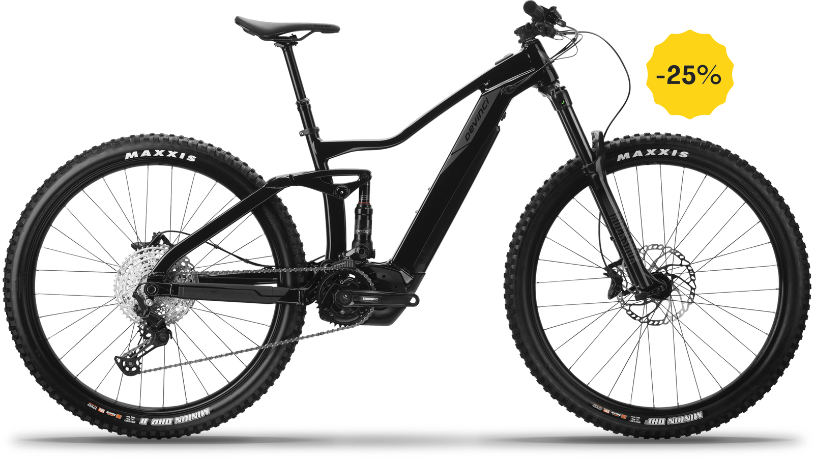

The Devinci EP is the Canadian brand's aluminium e-trail platform, built around a handcrafted 6066-T6 frame with 130mm of Split Pivot rear travel and a 140mm RockShox 35 Silver fork. It sits below the burlier E-Troy and E-Spartan in Devinci's 2024 range, pitched at rolling, technical trail riding rather than full enduro.
For 2024 it was offered as a single build, the EP Deore 12S, at US$5,999. The kit is sensibly chosen rather than flashy: a full Shimano Deore M6100 12-speed drivetrain on a Sunrace 11-51T cassette, four-piston Magura MT30 brakes with 203mm rotors front and rear, and grippy Maxxis Minion DHF/DHRII 2.6in tyres. The Shimano STEPS E7000 motor delivers 60Nm through a 504Wh E8035 battery, a modest mid-power setup that prioritises a natural ride feel over outright torque.
Geometry is adjustable via Devinci's FRG flip-chip. In the LO position a size M runs a 66.5 degree head angle, 76.5 degree effective seat angle and 455mm reach; flipping to HI steepens both angles half a degree and lifts the bottom bracket 6mm, trading a touch of stability for quicker, more upright handling. Chainstays are a consistent 470mm across sizes.
The EP is discontinued as a 2024 model year bike. Buyers should treat it as last-generation stock, and cross-check the 60Nm E7000 drive unit against Devinci's later, higher-torque e-mountain offerings if outright climbing assistance is a priority.
