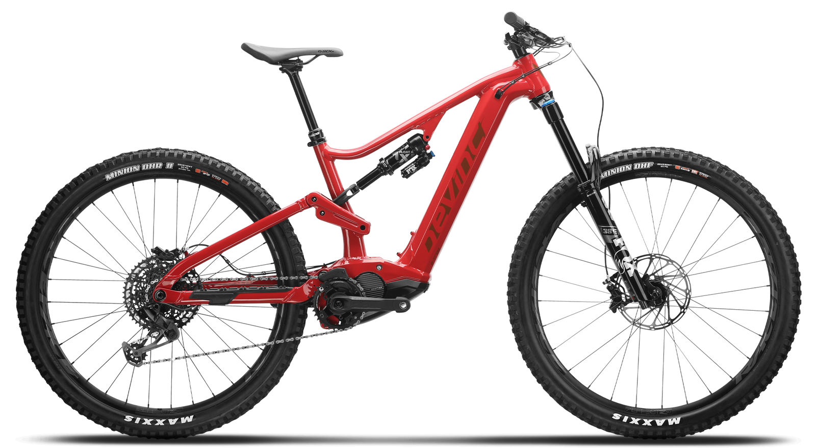

Devinci E-Troy 2023
EMTB Forums verdict
The 2023 Devinci E-Troy is the Canadian brand's full-power E-All Mountain platform, now discontinued. Built around a 6061-T6 Aluminum (Optimum G04) frame with 150mm of rear travel and a 160mm fork on 29in wheels, it pairs a Shimano STEPS EP800 motor (250W, 85Nm) with a sizeable 725Wh BMZ battery. Designed and assembled in Canada, it is a do-everything trail and all-mountain machine rather than a lightweight assist bike.
Two builds were offered. The GX (US$8,529) leans aggressive with a Fox 38 Performance Elite fork, Fox Float X Performance Elite shock, SRAM Code R four-piston brakes, SRAM GX Eagle 12-speed, RaceFace Aeffect R30 wheels and a claimed 24.70kg weight. The Deore (US$7,599) drops to a Fox 36 fork, Fox Float X Performance shock, Shimano four-piston brakes and a Shimano Deore M6100 12-speed drivetrain on house-brand V2 Comp wheels, making it the value-focused option.
Geometry is consistent and modern across all four sizes (S to XL), with a 64.8 degree head angle, steep effective seat angles of 77.7 to 78.1 degrees, a 455mm chainstay and reach growing from 445mm (S) to 510mm (XL). Note this is the full-power E-Troy, not the lightweight E-Troy Lite, which is a separate model. As a discontinued bike there is no current owner data here, so cross-check spec and pricing against a dealer before buying used.
