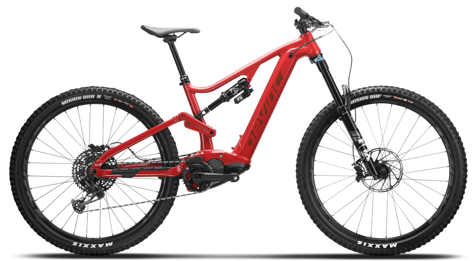

Devinci E-Troy 2022
EMTB Forums verdict
Launched on 25 May 2022, the all-new Devinci E-Troy is a 29in all-mountain eMTB built around 150mm of Split Pivot rear travel and a 160mm fork. The 6061-T6 aluminium frame (Optimum G04) carries Shimano's EP8 motor (85Nm) and a sizeable 725Wh BMZ battery, with moulded frame, motor and battery protection. It slots below the longer-travel E-Spartan (170mm rear / 180mm front) as Devinci's do-it-all electric trail bike.
Geometry is modern but not extreme: a 64.8-degree head angle across all four sizes, steep 77.7 to 78.1-degree seat angles for climbing, a consistent 455mm chainstay and a 347mm BB height, with reach growing from 445mm (S) to 510mm (XL). Wheelbase spans 1227mm to 1305mm. There is no flip chip, so the geometry stays fixed.
Two builds were offered, both on the alloy frame. The Deore 12S EP8 (US$7,599, 24.9kg) pairs a Fox 36 fork and Fox Float X with a full Shimano Deore drivetrain and MT520 four-piston brakes. The GX 12S (US$8,529, 24.7kg) steps up to a Fox 38 Performance Elite fork, SRAM GX Eagle, SRAM Code R brakes and RaceFace Aeffect wheels, making it the stronger pick for riders chasing the burlier chassis.
