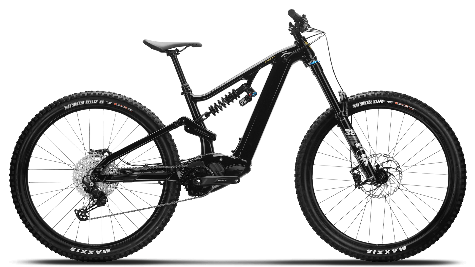

Devinci E-Spartan 2023
EMTB Forums verdict
The Devinci E-Spartan (2023, now discontinued) was the Canadian brand's full-power enduro eMTB, the e-equipped sibling of the analogue Spartan. It pairs 170mm of rear travel with a 180mm Fox 38 fork on a 29in wheelset, hung off an aluminium Optimum G04 (6061-T6) frame using Devinci's Split Pivot suspension layout. A slack 64.0 degree head angle and steepening seat tube angle (77.3 to 77.0 degrees across the range) mark it firmly as a descending-focused machine.
Power comes from a Shimano STEPS EP800 (EP8) drive unit rated at 250W and 85Nm, fed by a 725Wh BMZ battery in the downtube, with Boost, Trail, Eco and Walk modes via the EM800 computer. Devinci offered a single Deore 12S build at US$6,999: a Shimano Deore M6100 1x12 drivetrain, Shimano XT four-piston brakes on 203mm rotors, and Maxxis Minion DHF/DHRII tyres (DoubleDown rear). Claimed weight is 25.0kg for a medium.
Geometry runs S to XL with reach from 440mm to 505mm and a consistent 455mm chainstay and 354mm BB height across all sizes. As a discontinued model, spec is fixed at the 2023 build and there is no current owner-feedback data to draw on here, so the assessment above is grounded in published figures only.

Deore 12S
MotorShimano EP8 (DU-EP800) · 85 Nm
BatteryBMZ 725Wh · 725 Wh
Travel F/R180/170 mm
FrameAluminum Optimum G04 (6061-T6)
ForkFox 38 Performance E-Bike Grip 180 | 44 Offset
ShockFox DHX2 Performance Elite | 230x65
HeadsetFSA SX Pro | 1.5
StemV2 Pro | B:35mm | L:40mm | 0°
HandlebarV2 Pro | B:35mm | R:25mm | W:780mm
GripsDevinci Performance | w/lock-on
SaddleSDG BELAIR Max eMTB
SeatpostTranzX | 34.9mm | 1x Lever
BrakesFront: Shimano XT M8120/M8100 | 4 Pistons; Rear: Shimano XT M8120/M8100 | 4 Pistons
Rear derailleurShimano Deore M6100 | 12s
CrankShimano STEPS EM600 (Chainring: Shimano SM-CRE80 34T)
ShiftersShimano Deore M6100 | 12s
CassetteShimano M6100 | 12s | 10-51T | Microspline
ChainShimano Deore M6100 | 12s
DrivetrainShimano Deore M6100 | 12s; Shimano STEPS EM600 (Chainring: Shimano SM-CRE80 34T); Shimano Deore M6100 | 12s; Shimano M6100 | 12s | 10-51T | Microspline; Shimano Deore M6100 | 12s
WheelsV2 Comp | 29mm inner | TR
TyresFront: Maxxis Minion DHF | 29x2.5wt | 3C MaxxTerra Exo+ TR; Rear: Maxxis Minion DHRII | 29x2.4wt | 3C MaxxGrip DoubleDown TR
Weight25 kg
