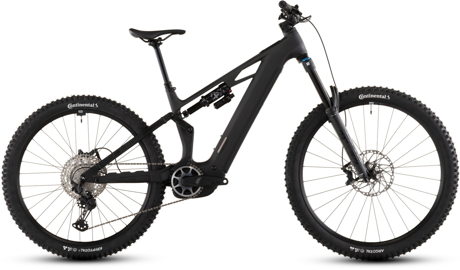

The Stereo Hybrid One77 is Cube's gravity-focused full-power eMTB, sitting above the One55 with 170mm of travel front and rear, a mullet wheel package (29in front, 27.5in rear) and a C:62 carbon front triangle paired to a 6061-T6 alloy rear. An angle-adjustable ACROS headset gives two settings, dropping the head angle from a moderate 64.4 degrees to a slack 63.8, with reach running from 425mm in S to 506mm in XL. The slack figures and long 1269-1305mm wheelbase on the larger sizes point firmly at high-speed descending rather than tight, twitchy trail riding.
All five 2025 trims share the Bosch Performance Line CX Gen 5 (BDU38) motor and a removable 800Wh PowerTube, with a PowerMore 250 range extender option. The motor launched at 85Nm, with a July 2025 Flow app update raising output to 100Nm and up to 750W; the TM, AT and SLT shipped already running the 100Nm tune.
Value sits at the lower end of the range. The 3,999 GBP Race delivers the full carbon frame, motor and battery with SR Suntour suspension, Magura MT Thirty brakes and a Shimano Deore drivetrain, while the 4,499 GBP SLX is the sensible step up: Fox 38 Rhythm and Float X, Shimano XT shifting and braking for 500 GBP more. Above that the TM, AT and SLT move to SRAM AXS wireless shifting, progressively higher Fox tiers and, on the SLT, Magura Gustav PRO brakes and Newmen Phase 30 carbon wheels to bring claimed weight to 24.3kg.
The Race and SLX are the heaviest at 25.2kg and 24.6kg respectively, so most of the price premium higher up buys electronic shifting, factory suspension and carbon wheels rather than dramatic weight savings on a bike that is built for descending regardless.
