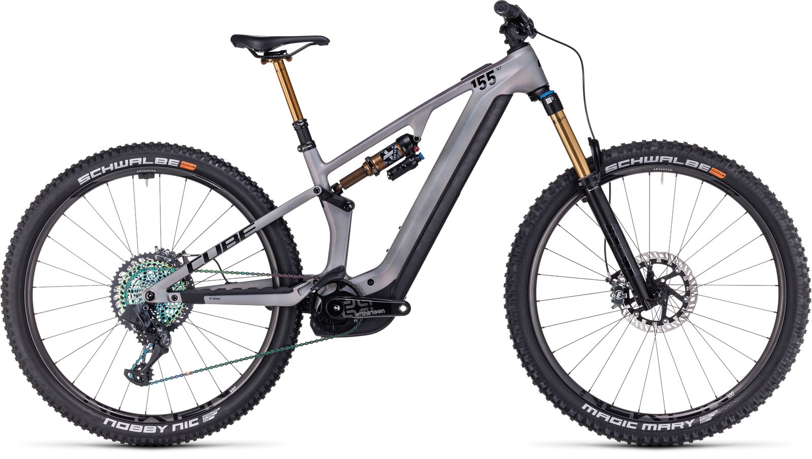

Cube Stereo Hybrid ONE55 C:68X 2025
From £5,999
EMTB Forums verdict
The Stereo Hybrid ONE55 C:68X is Cube's lightweight full-power enduro platform, built around their premium C:68X carbon frame with 160mm up front, 150mm of FSP 4-Link travel at the rear and a fully integrated Bosch 750Wh battery driving a fourth-generation Performance Line CX motor. The Agile Trail geometry runs slack at 64.4 degrees with a 75.7-degree effective seat angle and 454mm chainstays across all sizes, plus an angle-adjustable headset, so it reads as a descent-focused all-rounder rather than a pure climber.
Three trims share the identical frame, geometry and Bosch drive unit, so the choice is purely about kit. The SLX 750 at £5,999 pairs a RockShox Lyrik Select+ and Super Deluxe Select+ with a SRAM GX Eagle mechanical drivetrain and Cube's own dropper, making it the value pick at a claimed 22.6kg. The TM 750 at £6,999 steps up to a burlier Fox 38 Factory fork, Float X2 Factory shock and a Shimano XT groupset on aluminium Newmen wheels, the most gravity-biased build at 22.9kg. The flagship SLT 750 at £8,999 is the lightest at 21.9kg, with a Fox 36 Factory, wireless SRAM XX1 Eagle AXS, carbon Newmen wheels and a Fox Transfer dropper.
Braking is consistent and generous throughout: every trim runs Magura MT7 or Shimano XT four-piston stoppers on 203mm rotors front and rear. Tyre specs differ by build, with the SLT on a Schwalbe Magic Mary and Nobby Nic combination while the TM and SLX run a grippier Maxxis Assegai and Minion DHR II pairing. All three are 29in front and rear with no factory mullet option.
