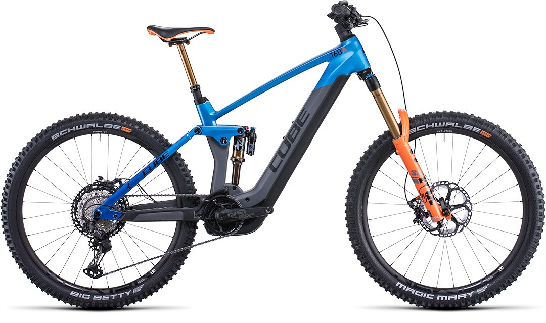

EMTB Forums verdict
The 2022 Cube Stereo Hybrid 160 was Cube's enduro flagship eMTB - billed as "The Racer" - built on a fully carbon HPC chassis (C:62 Monocoque Advanced front triangle, 6061 alloy rear triangle) with 170mm up front, 160mm out back and a 27.5in wheelset front and rear. It ran the Bosch Performance Line CX Gen 4 motor (85Nm) with the Smart System and a fully integrated 750Wh PowerTube on the four top trims.
Every 2022 Stereo Hybrid 160 was carbon - there was no HPA alloy version that year, so the trim ladder is really about kit. The flagship SLT (around 8,499 GBP) brought Fox Factory 38 GRIP2, a Float X Factory shock, SRAM XX1 Eagle AXS wireless and Newmen carbon wheels; the marquee Action Team (around 6,499 GBP) swapped to Shimano XT and Fox Factory; the TM and SL sat in the middle on Fox Performance or RockShox ZEB; and the entry Race (around 4,499 GBP) dropped to a 625Wh battery, RockShox Domain fork, Bosch Purion display and Shimano Deore.
Geometry is enduro-capable but, by 2022 standards, fairly measured: a 65-degree head angle across the board, around 441mm chainstays and reach figures in the mid-450s to low-500s on the carbon 750 frame (the Race frame is published a touch shorter). The 27.5in wheels and lively FSP four-bar suit playful, technical riding more than outright high-speed stability.
It is discontinued: Cube replaced the dedicated 160 enduro platform in the following model years, with the enduro role passing to the newer Bosch Smart System Stereo Hybrid range. As a used buy the Action Team remains the collectible colourway, while the Race offers the most affordable route onto the carbon chassis.
