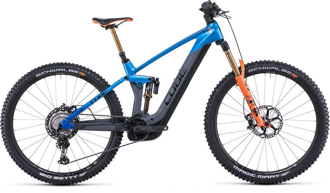

The 2022 Cube Stereo Hybrid 140 was Cube's carbon all-mountain workhorse, built around a 140mm-travel FSP four-bar rear end and the 85Nm Bosch Performance Line CX Gen 4 motor. The HPC carbon range documented here splits cleanly into two camps: 625Wh trims (Pro, Race) run a 140mm fork and a mullet-style split-size wheel layout (27.5in on XS/S, 29in on M/L/XL), while the all-new 750Wh trims (SL, Actionteam) step up to a 150mm fork, full 29in wheels, a UDH dropout and the Bosch Smart System with a Kiox 300 display.
Value sits at the lower end of the range. The Pro 625 (£4,199) and Race 625 (£4,599) deliver carbon frames, Bosch CX power and dropper posts at a keen price, albeit with workmanlike Shimano Deore/XT mixed drivetrains and entry RockShox 35 Silver or Recon dampers. The SL 750 (£4,899) is arguably the sweet spot, adding the bigger 750Wh battery, Fox 34 Rhythm fork and Shimano XT brakes. The Actionteam 750 (£6,399) is the no-compromise flagship with Fox 36 Factory and Float X Factory Kashima suspension, full Shimano XT and a Fox Transfer Factory dropper.
Geometry is moderate-progressive for its era: a 66 degree head angle across all sizes, roughly 75.2 to 75.5 degree seat angle, 457mm chainstays on the 29in sizes and reach growing from about 436mm (M) to 476mm (XL) on the 625 frame, or 447mm to 497mm on the longer 750 frame. It is stable and confidence-inspiring rather than ultra-aggressive.
This 2022 model is discontinued. Cube has since moved the Stereo Hybrid 140 line on to newer Bosch Smart System hardware and later introduced ABS-equipped variants, so the 2022 bikes now live on the used market as well-specced, carbon-framed all-mountain bargains.
