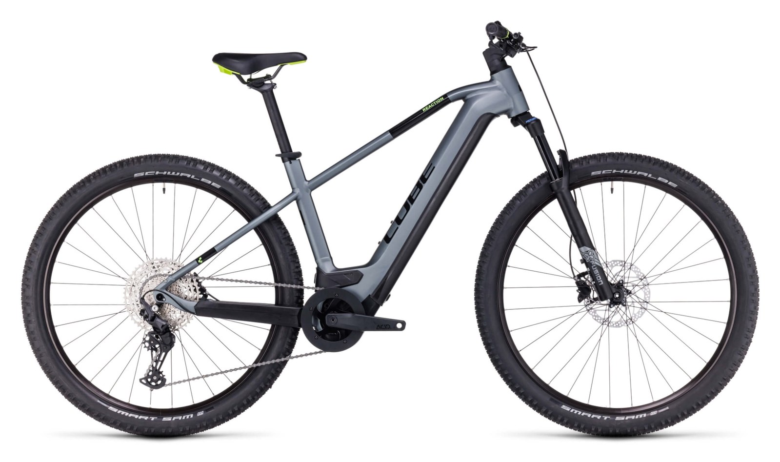

Reaction Hybrid 2024
The 2024 Cube Reaction Hybrid is the brand's mainstream aluminium hardtail eMTB, built around the 85Nm fourth-generation Bosch Performance Line CX motor and Smart System electronics. It is a do-everything trail and fitness hardtail rather than a technical descender, with a 120mm fork, a 67 to 68 degree head angle and a 74 degree seat angle across the range. Size S runs 27.5in wheels while M to XXL move to 29in, and the chainstays are a long 460mm on the 29er sizes, so the fit is stable and roll-happy rather than playful.
The three UK builds we read climb in a logical ladder. The Pro 625 at £2,799 pairs a 625Wh PowerTube battery, an X-Fusion MIG32 fork and Shimano Deore 11-speed with basic BR-MT200 brakes on 180mm rotors. The Pro 750 at £2,999 is the same bike with a larger 750Wh battery for extra range. The Race 750 at £3,499 is the clear pick of the three for keen riders, stepping up to a RockShox Judy Silver fork, Shimano XT 12-speed, more powerful four-piston BR-MT420 brakes on 203mm rotors, Cube EX30 rims and the Kiox 300 display. The £500 jump from Pro 750 to Race 750 buys a meaningful upgrade in braking, gearing and fork.
