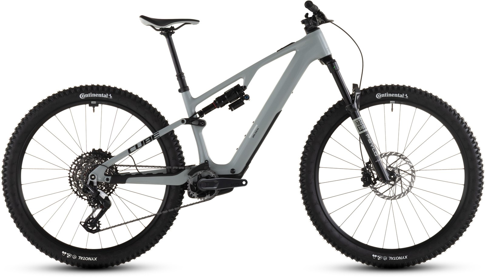

The Cube AMS Hybrid One44 is a lightweight, carbon-framed, full-suspension trail bike built around the Bosch Performance Line SX motor — a 55 Nm, 250 W rated unit with a manufacturer-claimed peak of 600 W, housed in a 2.0 kg motor body. Paired with a 400 Wh integrated battery and 140 mm of travel front and rear on 29-inch wheels, it tips the scales from 16.2 kg (top SLT trim) to 18.7 kg depending on build. The community consensus is consistent: this is a bike you ride mostly without the motor, and that's the point.
