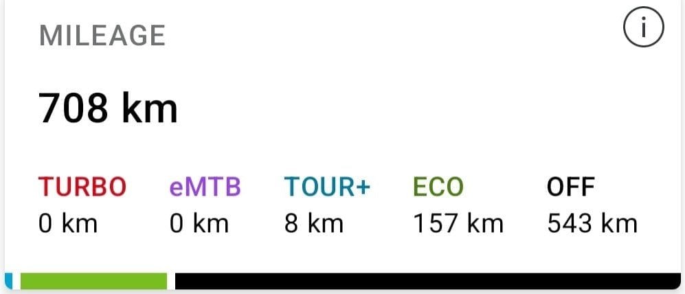

Well, after a long period of consideration, I switched to an e-bike, concretely the Cube AMS Hybrid One44 C:68X SLX. I've got it for more than 2 months, driven over 700 km, and I'm still delighted with it. The bike feels very light (officially 17.2 kg) what results to the fact that I only use motor support for ascending - statistically in less than 25% of the distance driven. According to the Flow app statistics, up to 75% of driven distance is without the motor, 22% on ECO, and 3% on TOUR+ mode. I don't use the other modes at all. Thus, I can drive more than 120km on a single charge (so far I’ve done max. 137km). Riding without a motor feels the same as on a classic bicycle, the drive does not put any additional resistance. I bought me also the 250Wh Range Extender, but there was no need to use it yet.

According to the Flow application statistics,
- 77,7% of my ride time was without any e-support,
- 22,3.% with the e-support.
Of this, 20,85% was in ECO mode, 1.45% in other modes of which TOUR+ was 1,16%. eMTB 0.23% and Turbo 0.06%. The most powered modes (eMTB and Turbo) were mainly activated by an accidental switch.
