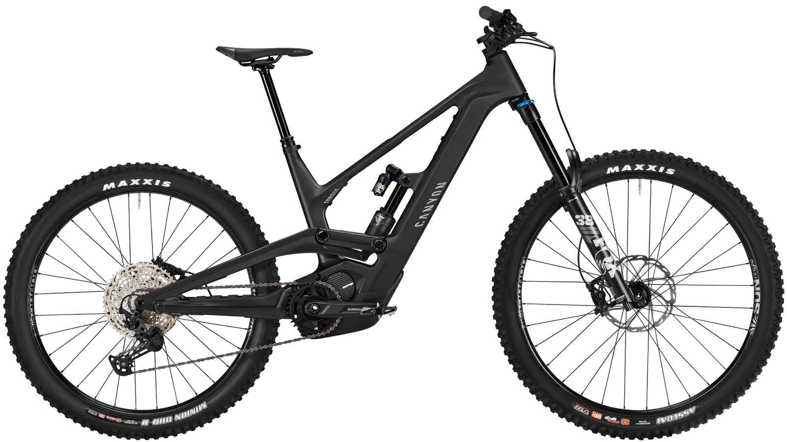

EMTB Forums verdict
The 2023 Canyon Torque:ON was the brand's heaviest-hitting bike-park and freeride e-MTB, pairing 180 mm of fork travel with 175 mm out back on a DH-rated Triple Phase Suspension chassis. A slack 63.5-degree head angle and long, stable wheelbase mark it out as a gravity machine rather than an all-day all-rounder. The carbon CF frames run a 29in front / 27.5in rear mullet setup with a steep 77.5-degree seat angle, while the alloy Torque:ON 7 and 9 keep full 27.5in wheels and a more relaxed 74-degree seat angle.
The range split by frame and battery. Carbon CF models (CF 8 from 5,749 pounds, CF 9 at 7,149 pounds, and the range-topping SRAM X0 AXS Transmission Roczen signature edition at 8,599 pounds) carry Canyon's own 720 Wh or 900 Wh pack for big-day range. The alloy Torque:ON 7 (4,299 pounds) and Torque:ON 9 (5,749 pounds) use Shimano's lighter 504 Wh BT-E8035 battery to keep weight down for shuttle-style party laps. Every trim runs the proven Shimano EP8 motor with 85 Nm and an SC-E7000 display.
Components scale sensibly with price: from Shimano Deore four-pots and a RockShox ZEB R on the alloy 7, through SLX and XT mixes on the CF 8 and CF 9, up to a coil-sprung ZEB Ultimate and wireless AXS on the Roczen. All bikes pair big 220 mm front rotors with burly Maxxis Assegai / Minion DHR II rubber, leaving no doubt about the intended terrain.
This generation is now discontinued. Canyon kept the Torque:ON name into later model years before the lineage moved to a Shimano EP6 (DU-EP600) platform in 2025, so anyone hunting one of these will be buying used.

Bike geometry diagram
Flip-chip position
geometry changes with the chip
SMLXL
Reach435 mm460 mm485 mm510 mm
Stack616 mm625 mm634 mm643 mm
Seattube440 mm440 mm460 mm500 mm
Chainstay430 mm430 mm430 mm430 mm
Headtube Angle63.5°63.5°63.5°63.5°
Seattube Angle (eff)74°74°74°74°
Wheelbase1214 mm1244 mm1273 mm1302 mm
Headtube115 mm125 mm135 mm145 mm
BB Height340 mm340 mm340 mm340 mm
Standover777 mm780 mm786 mm790 mm
Front Centre784 mm*814 mm*843 mm*872 mm*
FC:RC1.821.891.962.03
