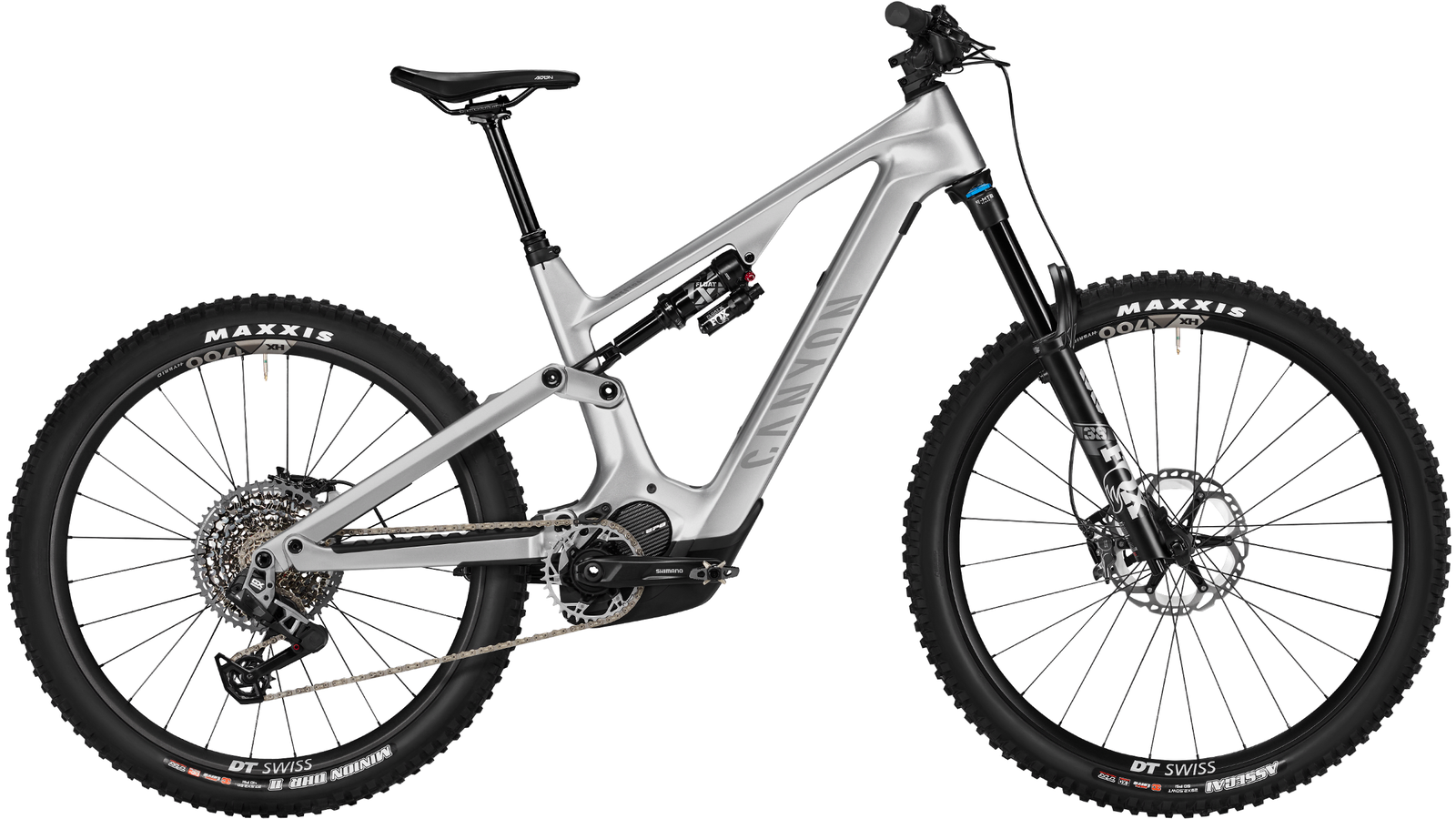

The 2023 Spectral:ON was Canyon's playful all-mountain mullet e-MTB and, for this generation, went fully carbon across the board. Both the CF and CFR frames pair a 29in front wheel with a smaller 27.5in rear, 160mm of fork travel and 155mm out back via Canyon's Triple Phase Suspension layout, driven by Shimano's 85Nm EP8 motor and Canyon's own high-capacity 900Wh battery (720Wh on size S and the CF 7).
Geometry is consistent across the five builds: a slack 65.5 degree head angle, a 76.5 degree effective seat angle and reach from 435mm (S) to 510mm (XL), aimed squarely at confident, centred descending while the mullet rear keeps things flickable. The range opens with the value-focused CF 7 at GBP 4,799 (RockShox Lyrik Select, Deore/XT mix) and climbs through the FOX 36 SLX-equipped CF 8 and the SRAM GX AXS Transmission CF 9, up to the XT Di2 CFR and the SRAM XX AXS, RockShox Flight Attendant equipped CFR LTD flagship at GBP 11,449.
This generation has since been discontinued and superseded by later Spectral:ON models, so the 2023 bike is now an end-of-line model. It remains a well-rounded, full-carbon mullet e-MTB with a wide spread of builds and Canyon's class-leading battery capacity.

Important safety note from Canyon: the Spectral:ON CF / CFR and Torque:ON CF models may have damage to the battery
639 replies · 151.3k views · last reply 4 weeks ago

50LEGACY (EP8/EP801 era, 2022-2025): battery recall - cracked casings on ALL 720/900Wh Spectral:ON CF/CFR batteries (Nov… · typical onset: Recall notice 2024-11-06.
12LEGACY (E8000 era, 2018-2021): shock-extension plastic bushings and budget pivot bearings fail early · typical onset: Bushings: 250-1,600km.
6LEGACY (E8000 + EP8 eras): lower headset bearing/cup encased Block Lock design, and 2023-era cups effectively glued in · typical onset: When the lower bearing dies - wet-climate bikes within 1-2 winters
16,000km Neuron:ON/Spectral:ON family bike still on its ORIGINAL shock bushings - owner washes the pivot area with a damp cloth only
