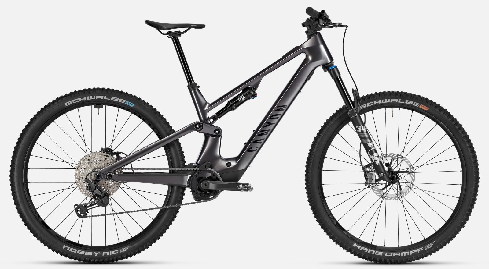

Frame
Full-carbon (CF) frame, 140mm rear travel (130mm XS), 29in wheels, integrated Bosch CompactTube 400Wh battery, sub-20kg-class lightweight eMTB platform.
