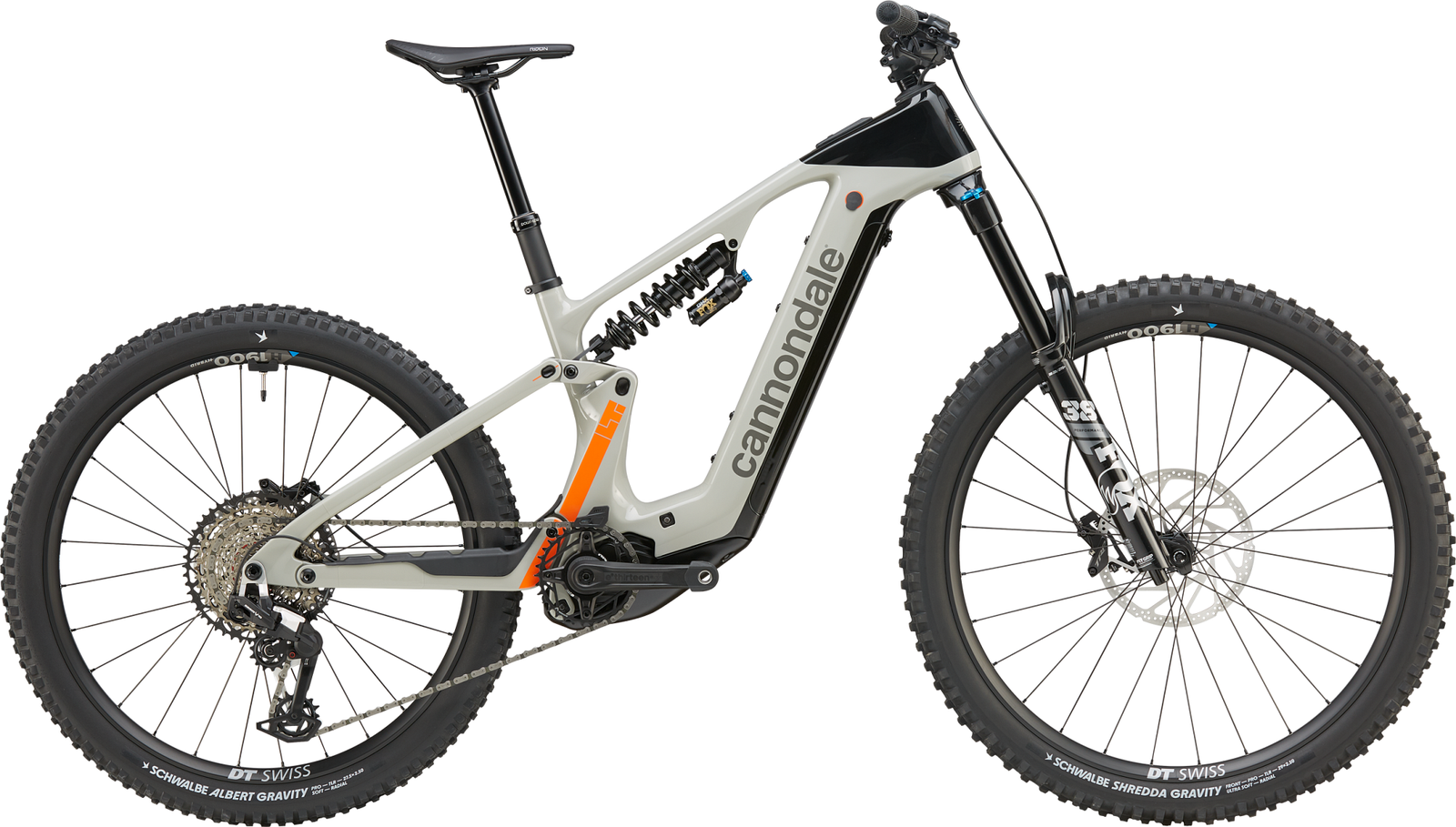

The Cannondale Moterra Neo LT 2025 is a full-power carbon enduro eMTB built around the Bosch Performance Line CX, with 170 mm of fork travel and 165 mm at the rear in a mullet wheel setup. Headline numbers: 26.4 kg claimed, an 800 Wh removable battery, a 64 degree head angle and reach stepping from 440 mm on S to 515 mm on XL. The community framing is unambiguous: the LT is the downhill-skewed Moterra, with @Wiltshire Warrior calling out how mullet plus the slack front end transforms its rough-trail composure.
Drive system and range. The Bosch Performance Line CX delivers 85 Nm and is the most service-supported motor in the eMTB market. @Amber Valley Guy reports 4500 trouble-free miles on the prior Moterra EP8 generation but flags hit-or-miss quality on earlier units, which is one reason the move to Bosch on the 2025 LT matters. @Spiff documented a Bosch Gen4 seal service after 7100 km with seals still in good condition, evidence of the long service intervals owners actually get. The 800 Wh battery is removable and Bosch PowerMore range-extender ready, although @Spiff warns that on certain Moterra frames the bottle-cage threaded inserts sit too low to physically mount the PowerMore due to a 90 mm clearance shortage. @Spiff also notes the bike requires a Cannondale-distributor LBS to flip the POWERMORE READY parameter from NO to YES via Bosch Diagnostic before the extender will pair. Plan ahead.
Geometry and handling. A 64 degree head angle is properly slack and bang on category norm for a long-travel enduro eMTB. Reach progresses 440 mm to 465 mm to 490 mm to 515 mm across S, M, L and XL with a fixed 458 mm chainstay and wheelbases climbing 1263 mm to 1338 mm. The fixed chainstay reads short on the XL relative to the long 515 mm reach but should be lively on the M and L. With 27.5 inch out back and 29 inch up front, the mullet brief is to keep the rear short for cornering, while the long-travel coil-shock spec biases the bike to point-and-shoot descending.
Build and value. Two trims. The LT 1 at £7850 brings a Fox Float Performance 38 with Grip damper, a Fox DHX Performance coil shock at 230x65 mm, TRP EVO Pro four-piston brakes on a 220 mm front and 203 mm rear rotor and a mechanical SRAM Eagle 90/70 T-Type Transmission. The Carbon LT 2 sits above with a kit step-up. Spec highlights are the coil shock as standard, which is unusual on a carbon-frame bike at this money, and the heavy-duty 2.3 mm rotors paired with TRP four-piston calipers. Value pick is the LT 1: same frame, same motor, same 165 mm of travel, same coil shock.
Community-verified strengths. Owners praise three things. The fork-and-coil combination on the LT and Bosch motor smoothness, with the latter described as quiet and consistent. @Wiltshire Warrior calls a 160 mm fork upgrade "transformed rollover ability" on the prior LT1, supporting the case for the stock 170 mm 38 on the 2025. @Rhitter highlights a clever touch on the Moterra family: the display can be disconnected and the bike used on just the top-tube mode switch.
Caveats and known gripes. Three honest flags. @Wiltshire Warrior needed a refurbished motor at 900 miles on a prior LT1 build, a reminder that warranty matters at this duty cycle. The PowerMore mounting and configuration friction noted above is real and dealer-dependent. And @Rhitter notes the Moterra Large feels slightly smaller than other brands' Large frames, so try before you buy on size.
Verdict. The Moterra Neo LT 2025 is for the rider who wants a slack, long-travel, coil-shocked carbon enduro eMTB with the most service-supported motor in the market. If you want a lighter trail bike or full 29 inch wheels, look at the standard Moterra or the Moterra SL. Production status is current.

Moterra LT Carbon full-carbon frame, 27.5 inch rear / 29 inch front mullet wheels, 170mm fork / 165mm rear travel, Proportional Response Tuned Suspension, removable downtube battery, alloy skid plate.
