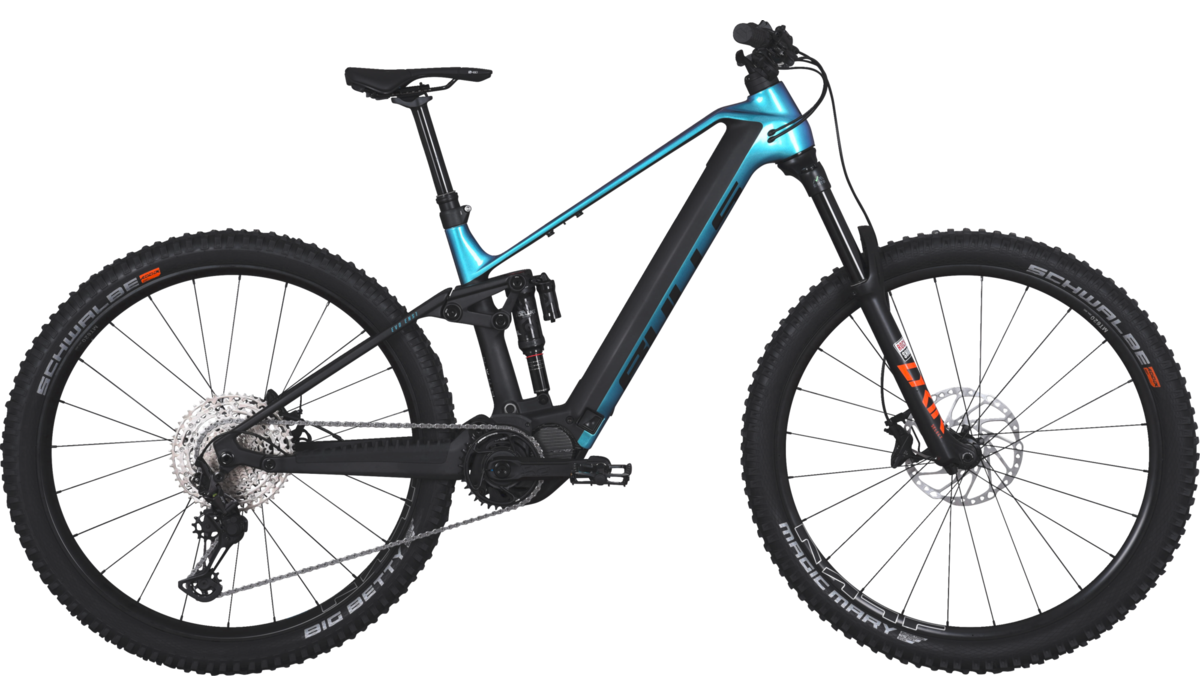

Bulls Sonic EVO EN-SL 2022
EMTB Forums verdict
The Bulls Sonic EVO EN-SL was the lightweight, long-travel enduro member of the 2022 Sonic EVO line, built on a full carbon frame with 160mm up front and 150mm at the rear on 29in wheels. The SL (SuperLight) tag is the point of the bike: it paired a full carbon chassis and Bulls' own semi-integrated 750Wh Sonic V10 pack with the Shimano EP8 motor to keep weight well down for a full-power enduro eMTB, with the EN-SL 2 Carbon coming in at a claimed 22.1kg.
It was sold in three builds. The EN-SL 1 Carbon (around 5,999 euro) ran a RockShox Lyrik Select RC fork, Super Deluxe Select+ shock and a Shimano Deore/XT mix on Shimano WH-MT620 wheels. The EN-SL 2 Carbon (around 6,999 euro) stepped up to a Lyrik Ultimate fork, full Shimano XT 12-speed shifting, XT four-piston brakes and DT Swiss H1900 wheels. Topping the range, the EN-SL Daytona special edition (around 12,999 euro) was a boutique build with Intend Blackline Edge fork and Hover Gamechanger shock, SRAM XX AXS wireless shifting, TRP DH-R Evo brakes, DT Swiss HXC carbon wheels and a RockShox Reverb AXS post.
Geometry was consistent across all four sizes (40 to 51cm, mapped to S to XL): a 65 degree head angle, 450mm chainstays, a 23mm bottom bracket drop and reach growing from 420mm to 481mm. Wheelbases ran from 1202mm to 1271mm, placing it in middle-of-the-road territory for a modern enduro rig rather than the longest in class.
This is a discontinued 2022 model, superseded by the 2023 and later Sonic EVO EN-SL generations (which moved to the Shimano EP801 motor and a 725Wh-rated pack). As a German ZEG brand bike it was priced in euro with no UK RRP, so availability now is limited to remaining stock and the used market.
