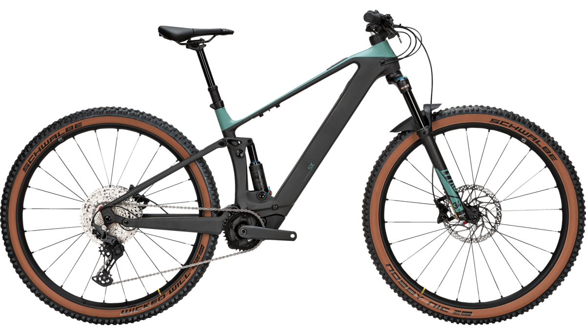

The Bulls Sonic EVA AM SX is the women's-specific (Diamant frame) version of Bulls' light-assist all-mountain platform, built around the lightweight Sonic carbon chassis with 140 mm of fork travel and 130 mm at the rear. It pairs the compact Bosch Performance Line SX motor with a slim 400 Wh Bosch CompactTube battery, so it slots into the lightweight trail category rather than full-power enduro. The women's tuning shows up in the 165 mm cranks, prologo Proxim 400 wide saddle and BULLS riserbar.
It was sold as a single trim, the SX 1, at 5,999 EUR. The build is sensibly value-led rather than flashy: a Shimano Deore 12-speed mechanical drivetrain, Shimano BR-MT420 four-piston hydraulic brakes on 203 mm rotors front and rear, Mavic E-Crossride wheels and Schwalbe Wicked Will / Nobby Nic tyres. A 150 mm LIMOTEC dropper and integrated MonkeyLink lighting round out a practical specification.
Geometry is moderate for the segment, with a 65.5 degree head angle, 75 degree effective seat angle and 450 mm chainstays across all three sizes (S to L). Reach runs 420 to 470 mm, giving a balanced trail feel rather than an aggressive enduro stance. Claimed weight is 19.9 kg.
This is a discontinued 2024 model. The 400 Wh battery is removable and can be supplemented by an optional 250 Wh range extender, and Bulls notes a free Bosch Performance Upgrade from autumn 2025 that raises the SX motor to 60 Nm, 600 W and up to 400 per cent support. It sits alongside the men's-frame Sonic EVO AM SX siblings in the same Sonic carbon range.
