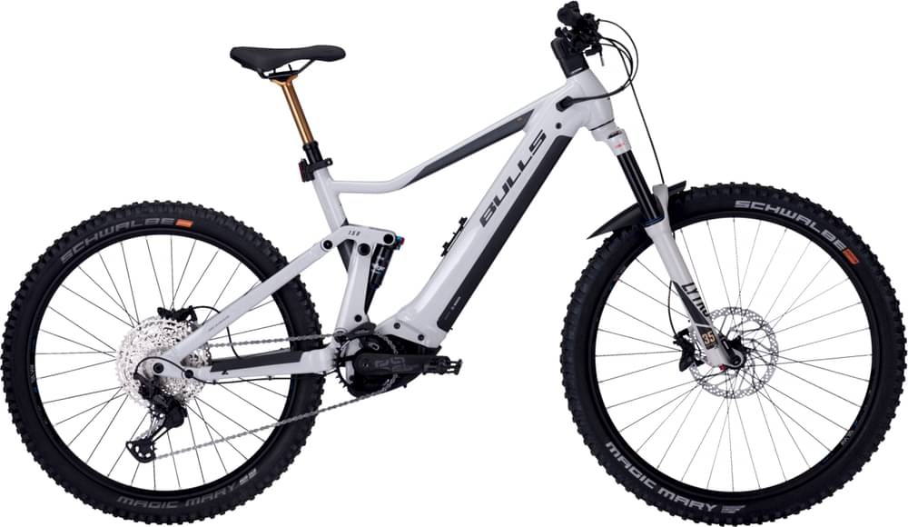

Bulls Copperhead EVO AM 2023
EMTB Forums verdict
The Bulls Copperhead EVO AM is a discontinued 2023 all-mountain e-MTB and, despite carrying the Copperhead name that Bulls otherwise uses for its hardtails, it is genuinely full suspension. A four-bar rear linkage with an SR Suntour shock gives 140 mm of travel front and rear on the AM 1 and AM 2, rising to 150 mm on the AM 3, all driven by Bosch's Smart System Performance Line CX motor (85 Nm) and a removable Bosch PowerTube battery, 500 Wh on the base AM 1 and 750 Wh on the '750' versions.
The trim ladder is value engineering on a shared alloy chassis. The AM 1 runs a 10-speed Shimano Deore drivetrain, Tektro brakes, an SR Suntour Unair fork and a rigid post; the AM 2 750 steps up to 11-speed Deore, Shimano brakes, a Limotec dropper and Schwalbe Nobby Nic tyres; and the flagship AM 3 750 gets a 12-speed Deore XT mech, a 150 mm Bulls Lytro 35 Supreme fork, an SR Suntour Edge shock and aggressive Schwalbe Magic Mary / Hans Dampf Super Gravity tyres. Geometry is moderately slack for its era at a 66 degree head angle, with reach running from 419 mm on the smallest 41 cm frame to 484 mm on the 54 cm, and 445 mm chainstays throughout.
Bulls discontinued the Copperhead EVO AM after 2023; within the current Bulls line-up the closest equivalent is the all-mountain Vuca EVO AM range.

MotorBosch Performance Line CX Gen 4 · 85 Nm · all trims
BatteryBosch PowerTube Horizontal (500Wh base / 750Wh on '750' trims) · 750 Wh · all trims
Travel F/R150/150 mm · all trims
FrameAluminium · all trims
ForkBULLS Lytro 34 Air Boost RLR DS, 140 mm (air)BULLS Lytro 34 Air Boost RLR DS, 140 mm (air)BULLS Lytro 34 Air Boost RLR DS, 140 mm (air)BULLS Lytro 35 SL Supreme LOR Air CTS Boost, 150 mm (air)
ShockSR SUNTOUR Unair TR LO-R8, 140 mmSR SUNTOUR Unair TR LO-R8, 140 mmSR SUNTOUR Unair TR LO-R8-Z11, 140 mmSR SUNTOUR Edge LOR8, 150 mm
HeadsetFSA No.57SCFSA No.57SCFSA No.55RFSA No.55R
StemMTB-SL, CCS Slot Mount readyMTB-SL, CCS Slot Mount readyMTBi, CCS Slot Mount readyMTBi, CCS Slot Mount ready
HandlebarBULLS MTB alloy · all trims
SaddleBULLS Sportive ErgoBULLS Sportive ErgoSELLE ROYAL Vivo ErgoSELLE ROYAL Vivo Ergo
SeatpostBULLS alloy 30.9, 350 mm (rigid - non-dropper)BULLS alloy 30.9, 350 mm (rigid - non-dropper)LIMOTEC A1-Z dropper post, 30.9 mmLIMOTEC A1-Z dropper post, 30.9 mm
BrakesHydraulic disc brake; TEKTRO HD-M390 leversHydraulic disc brake; TEKTRO HD-M390 leversHydraulic disc brake; SHIMANO BL-MT4100 leversHydraulic disc brake; SHIMANO BL-M6100 levers
Rear derailleurSHIMANO Deore RD-M5120-SGS Shadow PlusSHIMANO Deore RD-M5120-SGS Shadow PlusSHIMANO Deore RD-M5100-SGS Shadow PlusSHIMANO Deore XT RD-M8100-12-SGS Shadow Plus
CrankFSA 165 mmFSA 165 mmFSA 165 mmE-Thirteen 165 mm
ShiftersSHIMANO Deore SL-M4100-RSHIMANO Deore SL-M4100-RSHIMANO Deore SL-M5100-IR I-Spec EVSHIMANO Deore XT SL-M6100-IR I-Spec EV
CassetteSHIMANO Deore CS-M4100-10 11-46T (10-speed)SHIMANO Deore CS-M4100-10 11-46T (10-speed)SHIMANO Deore CS-M5100-11 11-51T (11-speed)SHIMANO Deore CS-M6100-12 10-51T (12-speed)
ChainKMC E10SKMC E10SKMC E11SSHIMANO CN-M6100
DrivetrainSHIMANO Deore RD-M5120-SGS Shadow Plus; FSA 165 mm; SHIMANO Deore SL-M4100-R; SHIMANO Deore CS-M4100-10 11-46T (10-speed); KMC E10SSHIMANO Deore RD-M5120-SGS Shadow Plus; FSA 165 mm; SHIMANO Deore SL-M4100-R; SHIMANO Deore CS-M4100-10 11-46T (10-speed); KMC E10SSHIMANO Deore RD-M5100-SGS Shadow Plus; FSA 165 mm; SHIMANO Deore SL-M5100-IR I-Spec EV; SHIMANO Deore CS-M5100-11 11-51T (11-speed); KMC E11SSHIMANO Deore XT RD-M8100-12-SGS Shadow Plus; E-Thirteen 165 mm; SHIMANO Deore XT SL-M6100-IR I-Spec EV; SHIMANO Deore CS-M6100-12 10-51T (12-speed); SHIMANO CN-M6100
WheelsRYDE Disc 30 (SHIMANO HB-MT400-B front / FH-MT400-B rear hubs)RYDE Disc 30 (SHIMANO HB-MT400-B front / FH-MT400-B rear hubs)RYDE Disc 30 (SHIMANO HB-MT400-B front / FH-MT400-B rear hubs)RYDE Disc 30 (SHIMANO HB-MT400-B front / FH-MT510-B rear hubs)
TyresVeeTire Crown GemVeeTire Crown GemSCHWALBE Nobby Nic PerformanceSCHWALBE Magic Mary Super Gravity (front) / Hans Dampf Super Gravity (rear)
