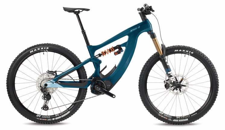

The BH Xtep Lynx Carbon was BH's MY2022 carbon eMTB range, built on the patented 'X System' carbon front triangle it shared with the Atom X line but powered by Shimano's EP8 motor (85 Nm) and a 720Wh battery for a claimed range of up to 155km. Suspension is BH's Split Pivot layout on 29in wheels throughout.
BH sold the same frame in two flavours. The Enduro builds run 160mm front and rear: the 9.7 (FOX 36 Performance fork, FOX Float DPS shock, Shimano MT520 brakes, carbon front / alloy rear) at GBP 7,199.90; the 9.8 (FOX 36 Performance, FOX Float X shock, Shimano XT brakes) at GBP 7,899.90; and the flagship 9.9 (FOX 38 Factory fork, FOX Float DHX2 Factory coil shock, full carbon frame, DT Swiss H1700 wheels) at GBP 8,999.90. The Trail builds drop to a 140mm fork: the 8.7 (FOX 34 Rhythm) at GBP 6,999.90 and the 8.8 (FOX 36 Performance, full carbon, FOX Float X, XT brakes) at GBP 7,799.90.
Geometry is aggressive trail to enduro: a 65.1 to 65.6 degree head angle, a steep 73.7 degree effective seat angle, a notably short 465mm chainstay across all sizes, and reach from 421mm (S) to 461mm (L and XL). The XL is a tall-rider size that shares the L's reach and stack, extending only the seat and head tubes. Note BH's own published wheelbase column is corrupt; the plausible figures here (1213 to 1264mm) come from mtb-news.de geometrics, which cross-checks the rest of the table to the millimetre.
The Xtep Lynx Carbon name was later retired as BH consolidated its eMTB range under the iLYNX naming, so this model is discontinued. It should not be confused with the BH Atom X Lynx Carbon of the same era, which is a separate trail line on a Brose Drive S Mag motor.

Bike geometry diagram
SMLXL
Reach421 mm431 mm461 mm461 mm
Stack608 mm620 mm647 mm647 mm
Seattube400 mm400 mm440 mm480 mm
Chainstay465 mm465 mm465 mm465 mm
Headtube Angle65.1°65.6°65.6°65.6°
Seattube Angle (eff)73.7°73.7°73.7°73.7°
Wheelbase1213 mm1222 mm1264 mm1264 mm
Headtube100 mm110 mm125 mm140 mm
Front Centre748 mm*757 mm*799 mm*799 mm*
FC:RC1.611.631.721.72
