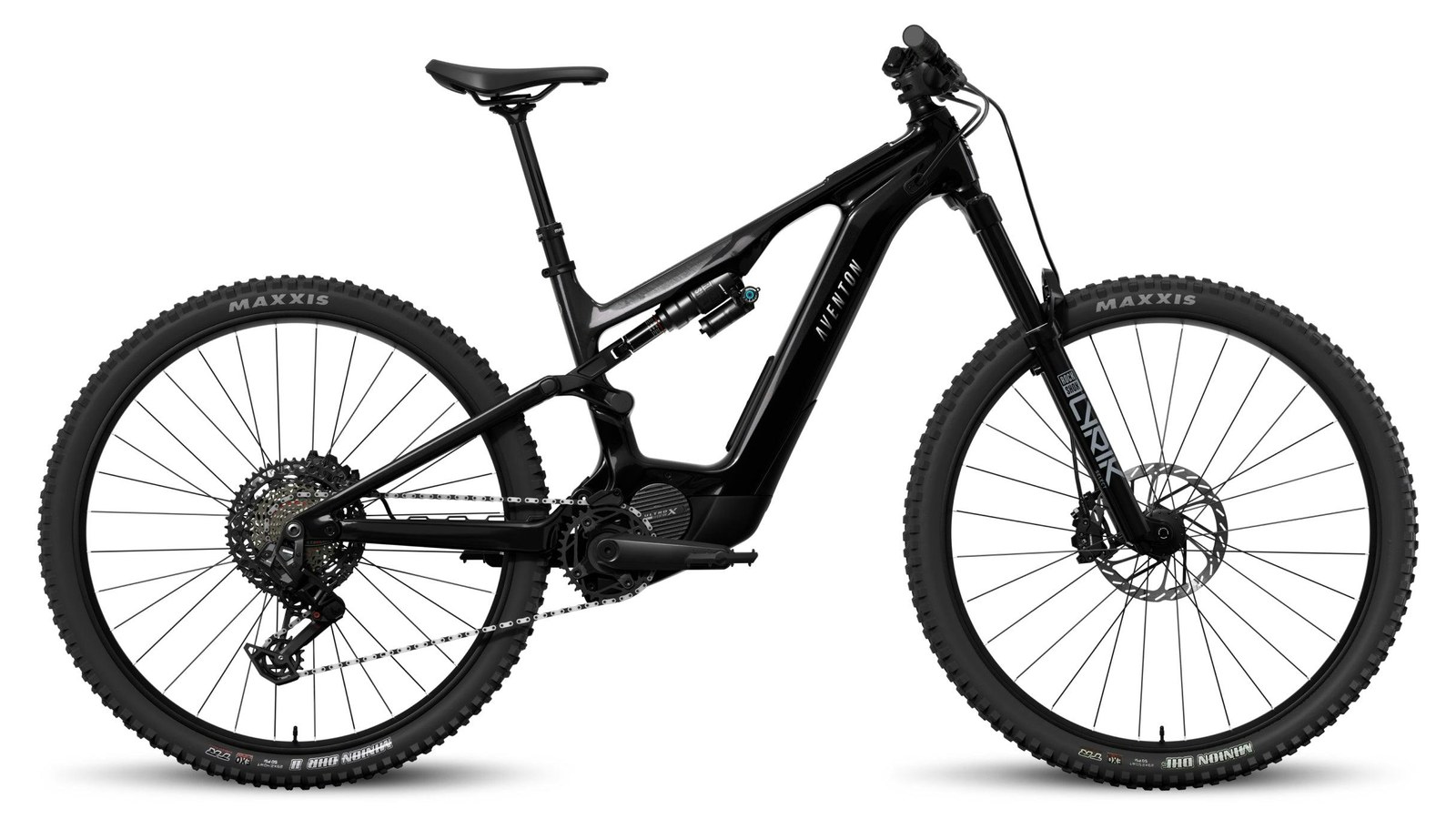

Aventon Current EXP 2026
EMTB Forums verdict
The Aventon Current EXP 2026 is an accessible full-power trail eMTB built around the all-new Aventon UltroX motor and an 800Wh integrated battery. Headline numbers: 150mm fork, 140mm rear, 110Nm sustained with a 120Nm 30-second Boost, 24.0kg claimed, 64.6 degree head angle and 475mm reach in the lone L size. The community read it as a serious value play that punches harder than mainstream Bosch rivals, with @Zrt1200 calling the Gen 4 Bosch at 85Nm "not in the same league" after riding both.
Drive system and range. The UltroX is Aventon's own mid-drive, debuting on Current and aimed straight at Bosch CX and Specialized 3.1 territory. @Zrt1200 describes four main modes (auto, eco, trail, turbo) plus a Boost button that overpowers everything for 30 seconds at 120Nm. Auto mode at 110Nm reads as the equivalent of Bosch's eMTB mode but with measurably more shove, while Trail mode is preferred on tight, technical singletrack where the auto algorithm can feel pushy. The 800Wh battery is integrated into the downtube and removable keylessly via the display. US press testing returned 30.9 trail miles with 3,010ft of climbing, which is competitive with the bigger-name 800Wh full-power bikes at this travel.
Geometry and handling. 64.6 degrees up front is bang on modern trail eMTB convention rather than aggressive enduro territory, and the 445mm chainstay is short for a 24kg bike, which should keep it lively on switchbacks and out of corners. The 475mm reach on L sits in the middle of the modern trail range, but watch the sizing: @Zrt1200 notes the Carbon Large is closer to a Trek Medium, so taller riders waiting on an XL should pause. Travel is also conservative for the segment: @Zrt1200 flags the 150/140mm package as noticeably less than a Trek Rail 7's 170/156mm, which positions Current EXP as fast trail rather than mini-enduro.
Build and value. €5,499 is the base, and the headline US build at $5,999 (~€5,500) is doing real work: @Zach_MTB highlights SRAM Maven Base four-piston brakes, the new SRAM S1000 AXS Transmission driven off the main battery (no derailleur cell to charge), a RockShox Lyrik Select up front and a Super Deluxe Select+ out back. The frame mixes carbon front triangle with alloy rear. For comparable AXS plus Maven kit on a Trek or Specialized you are typically looking at four-figure premiums. The L-only sizing is the conspicuous compromise.
Community-verified strengths.
  • @Zrt1200 rates the motor highly for sustained climbing in hilly terrain, where Auto mode's 110Nm flattens punchy ramps.
  • The Boost mode is genuinely useful rather than a gimmick: 30 seconds of 120Nm clears the steepest tech without forcing a permanent turbo mode commitment.
  • Spec for spend is the clincher: full AXS plus Maven at this price is hard to find from a legacy brand in 2026.
Caveats and known gripes.
  • One size only (L, 475mm reach). Riders under 5'8 or over 6'2 should test fit before buying.
  • 150/140mm travel is on the short side for buyers cross-shopping a Rail 7 or Levo. This is a trail bike, not an enduro tool.
  • Aventon is new to performance eMTB: long-term motor reliability data does not yet exist outside short press loans.
  • Some testers note tyre casing quality is a soft spot relative to the rest of the build.
Verdict. The Current EXP is the most credible challenger to the big brands at the €5,500/$6k mark in years, with a motor that out-torques Bosch CX, an honest 800Wh battery and AXS Transmission as standard. Buyers who fit the L frame and want trail-not-enduro travel get arguably the best spend-per-spec ratio in 2026. Riders needing size options, longer travel or a proven motor warranty story should hold off. Production status: current.
