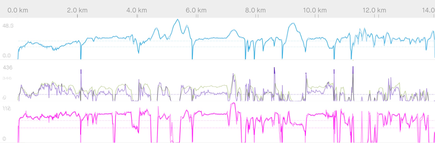

In case anyone wants to know …
Here is the overlapped power data comparison from Strava for a ride recorded with both the Trek Central app and Garmin XC200 pedals (via Edge 1030). Shown top to bottom is speed, power and cadence.
Website plotting functions can be a little ‘vague‘ (see km markers, or the ave. speed lines that should be the same …), so I used the stopping points mid-ride to scale the distance (x) axis so that the timing matched for everything else.
+ The speed data are near enough identical, max. was 48.3 & 48.5km/h. I read somewhere that Trek Central App uses the OS GPS data in the saved file, so this is effectively Edge 1030 vs. iPhone 12.
+ The cadence is also near enough identical, which is what it should be. Any differences are next to negligible.
+ The power comparison is a can of worms! Due to different max. power values, I had to scale vertically as best I could – in general, I had seen that there was wildly varying differences, often factor 2, but there is one short passage at around 8.4km (uphill, speed below TQ cut-off), where both consistently showed approx. 100W, that I used to match the vertical scaling. The margin of error (due to how often I looked to compare) could easily be +/-10% or perhaps more. What is worse,, the average power lines should not overlap (I think 78W vs 117W), and if I had scaled so that they were relatively correct, the following would be much worse!!
The reality is that the TQ values (green) were rarely the same as the XC200 pedals, and in fact usually higher – look at where I hold speed, power and cadence (by accident, all above cut-off): the TQ data was 50-100% higher. Elsewhere the data doesn‘t match much either. The TQ data shows bloated values just about everywhere, but there was also consistent ‚overrun‘ shown ‚real time’ on the display for 1 or 2s, meaning that updating was generally slower. Given that Garmin has had many years to qualify their pedals (ha ha … yes, but we all know Garmin ;-), that TQ freely admits that their power data is a ‚guesstimate‘, and adding that to what I saw while riding, then, frankly, the TQ values are nothing more than ‚ball park‘ … and a fairly big one at that.
Flow81
Oct 27, 2022
41
33
Cape Town
Now we are talking! What would be gold is to try and identify drivetrain losses (drag) or system efficiency at varying outputs. Imagine you could still find hub power meters and combine that with the Garmin pedals. You can then show the cumulative wattage that hits the rear hub. Rider input + motor input - drivetrain losses = total system output
BuzzCanada
Nov 23, 2022
33
62
Canada
I was seeing the same except the motor was low consistently sometimes by a factor of 2. the Garmin pedals are accurate I have compared them with my trainer (NEO) and they were bang on. Side note, has anyone noticed their motor getting noisy? I am now getting much more noise and the not going to say grinding but a grumbling noise when I am not inputting not much for wattage. Usually just spinning lightly around corners.
konamac
Apr 6, 2023
25
13
Namibia
Hey Buzz, set your display to the Watts display (something you clearly do a lot!) and then check when you hear the grumbling at low input to see if the support from the motor is remaining relatively constant or dropping off to 0 and spooling back up repeatedly along with the low growling sound (clutch not disengaging completely I'm led to believe.) If so your motor has an issue. Mine did it from new when rider input was between 80-130 watts and pedalling along smoothly , and the same again with the first replacement motor. Third time lucky it seems, symptoms are gone, motor is quiet and the support is much more consistent. Because simply put if you are pedalling and not coasting, the motor should be giving something (dependent on level selected) but it should never spool down to nothing. Trek and TQ were very helpful in solving my problem. It's a known issue and TQ are busy training their diagnostics software to recognise the problem by using motors returned from the field. One more thing, have you taken your cranks off at all? And if so are you sure they are aligned with the marks as per the service manual, they don't like being out of sync. I can share a video of what mine was doing if you like.
Mteam
Aug 3, 2020
1,797
1,736
gone
it will spool down to nothing when you are over the motor speed limit cut out..... I know its obvious, but worth stating as on the flat (or especially downhill slightly) its quite easy to go over the cut off speed and then wonder why the motor is not doing anything, especially when the motor is as quiet as the TQ.
konamac
Apr 6, 2023
25
13
Namibia
I agree it obviously would do that at assist cut off. So I'll clarify by stating mine always occurred at between 20-23 km/h on a bike with a 32km/h cutoff speed. I could replicate the problem at will by keeping the rider input in the zone mentioned, put in 140watts and it went away.... , it was clearly a flaw and Trek and TQ agreed. Back to back testing with the shops demo bike showed that it was not normal.
BuzzCanada
Nov 23, 2022
33
62
Canada
Thanks a lot. I'll give that a try. Yes I have removed the cranks but I was aware of the alignment of the cranks on the spindle (notch) and they are installed correctly. (as well as properly torqued which is another issue common with these bikes) I am going to try what you said but to be honest I think it is doing exactly what you are describing which is making sense. I'll let you know what I find.
BuzzCanada
Nov 23, 2022
33
62
Canada
Yah, I concur, I noticed the grumble went away with a higher wattage input from me. The clutch disengaging prematurely is most likely the culprit.
