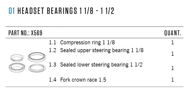

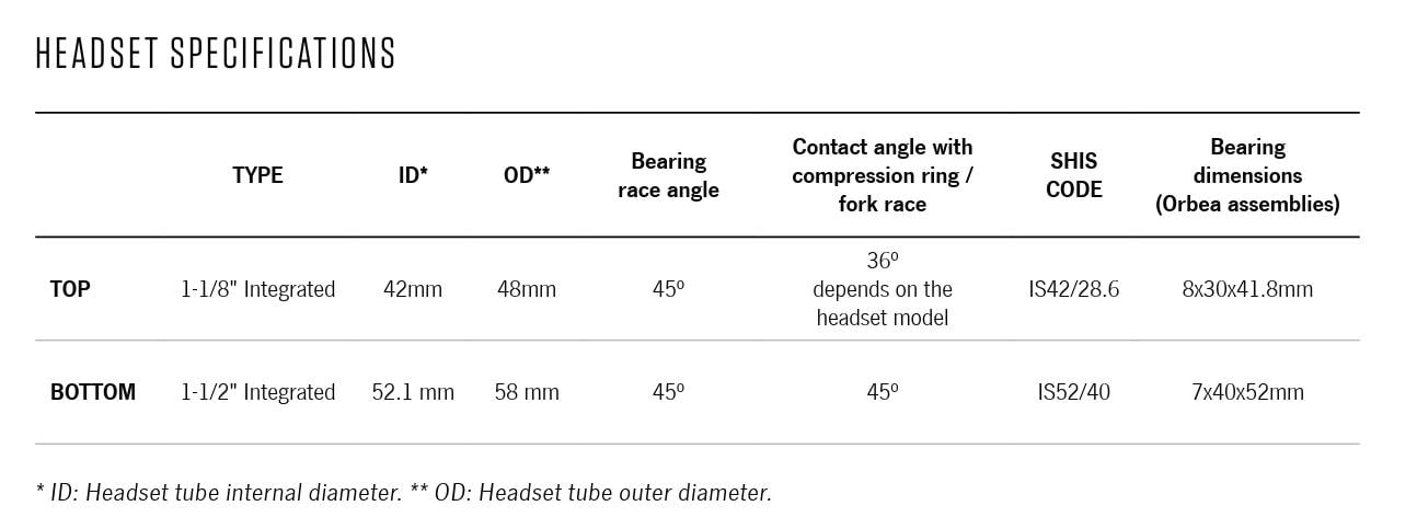

The integrated tapered headset that comes on the 2022 H30 Rise is made by Acros. The headset is your typical budget headset. The upper bearing is a IS-42mm tapered bearing and the lower is a IS-52mm tapered bearing.
The ruggedness of the terrain and you area weather conditions , i.e. repeated exposure to moisture will dictate how long the headset bearings will last. I like to ride rocky terrain and the Acros headset on my Rise lasted about a year before the bearings lost their smoothness and became notchy and stiff.
Often times, a headset bearing need only be serviced for it to perform perfectly. There are some detailed You Tube videos which detail how to service headset bearings. Note, if you do service your headset bearings, be careful to not overpack the bearing with grease. This is a common mistake and it will cause your headset to feel very stiff and resistant to turning.
Depending upon your financial budget, you have several options when it comes to servicing/replacing the headset. The cheapest method is to source and replace the individual bearing that has failed. You can pick up a single IS-42 or IS-52 bearing online via Amazon, eBay, or bike shop.
Orbea sells a complete Acros replacement headset on the "Spare Parts" section of it's website.
