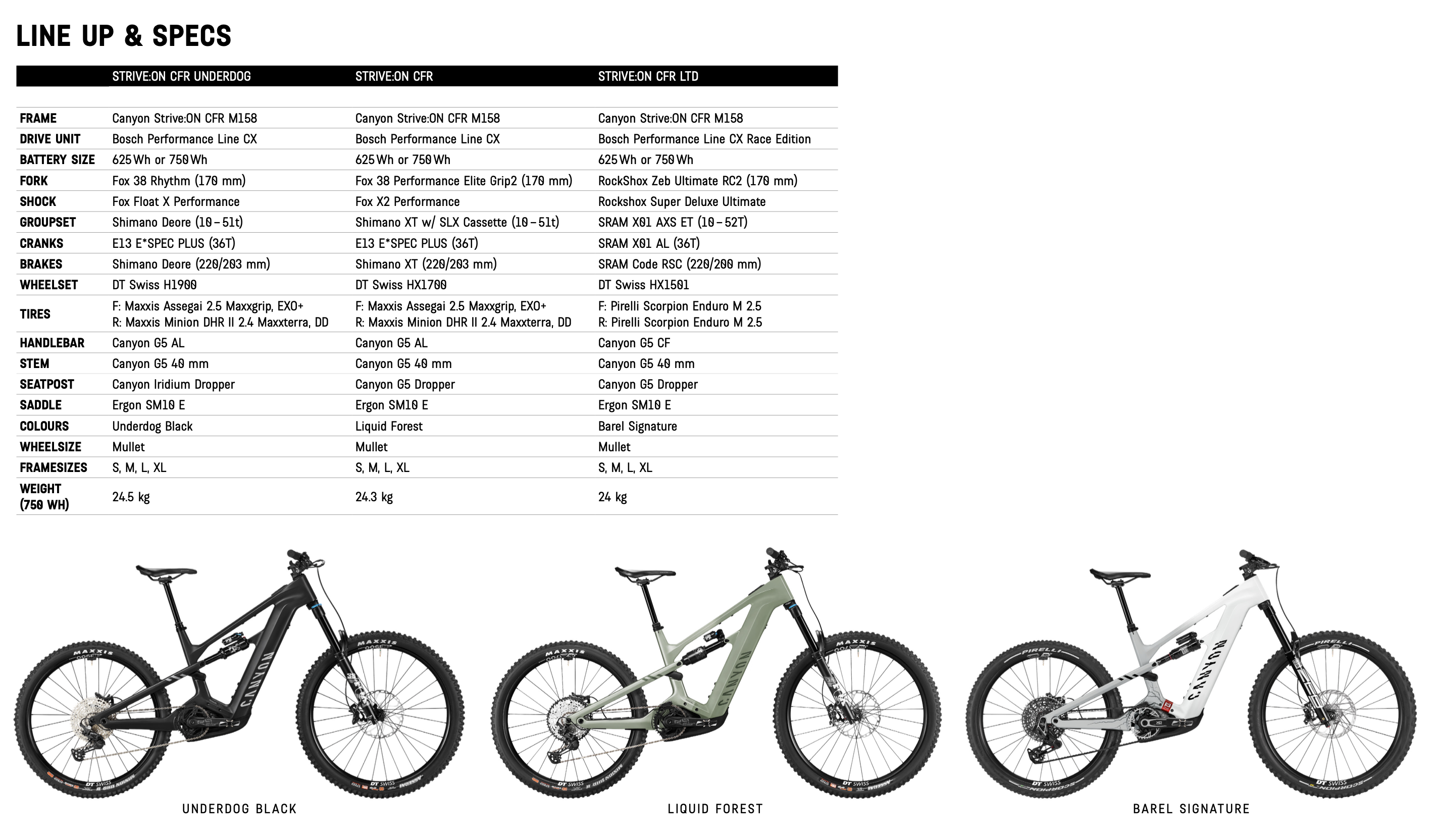

HOW MANY BIKES ARE IN THE STRIVE:ON LINE-UP?
There are 3 models, each available with a choice of 625 Wh or 750 Wh batteries.
• Strive:ON CFR Underdog
• Strive:ON CFR
• Strive:ON CFR LTD
WHAT MOTOR SYSTEM DOES THE STRIVE:ON USE?
The Strive:ON CFR and CFR Underdog come with the Bosch CX Performance motor, and the CFR LTD is kitted with the CX Performance Race. The Bosch CX Performance line was chosen because of its proven e-MTB race pedigree. The additional pedal assist, extra torque, and overdrive features were must-haves for pro riders.

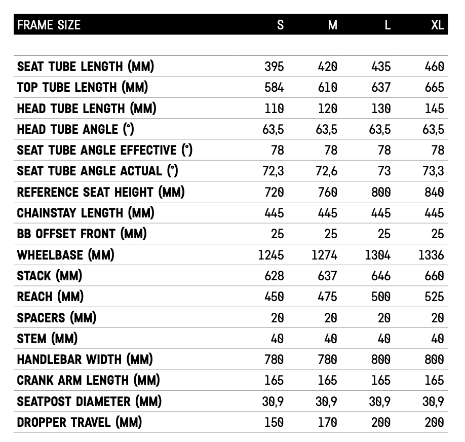

HOW DID CANYON DECIDE ON THIS BIKE'S GEOMETRY?
With the goal of designing an agile e-MTB that is stable at high speed, Canyon's team settled on a combination of the Strive and Spectral geometries. Compared to the non-electric Strive, the Strive:ON has longer chainstays and a steeper seat tube to maximize climbing performance.

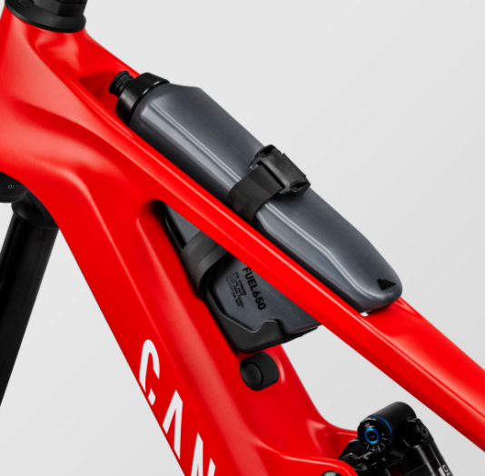

THE STRIVE:ON LOOKS TO FIT A STANDARD 600 ML BOTTLE AND CAGE. IS THAT RIGHT? ARE THERE ANY OTHER STORAGE FEATURES?
A 600ml bottle fits with a side loader, and there is a two-bolt storage mount under the top tube like on Strive and Spectral 125.

WHAT CRANKLENGTH IS SPEC’D ON THE BIKE? WHY DID WE CHOOSE THIS OPTION?
165 mm for a little more pedal clearance. Short cranks also tend to promote higher cadences, which help the motor to perform at its best.
Note: The underdog comes with SRAM DB8 brakes.

Wow what were they thinking with the water bottle storage looks like you have to unclip it to have a drink🤣😳😳
RJUK
Sep 29, 2021
548
287
Neat 😳 I was being sarcastic 😂 that is a terrible design
It's rubbish because you have to use their bottle, but being higher up in the frame I guess makes it easier to grab a drink without stopping. It does put a chunk of weight up high in the frame though, which isn't so good.
I applaud them for thinking outside the box though - it's certainly note-worthy and I'd hope they will devise other things to fit in there, like a storage bag for your tools, energy bars, etc. Maybe even a phone holder.
WHAT BOSCH BATTERY SIZES IS THIS BIKE COMPATIBLE WITH?
625 Wh & 750 Wh Powertube batteries.
View attachment 114180 View attachment 114181
