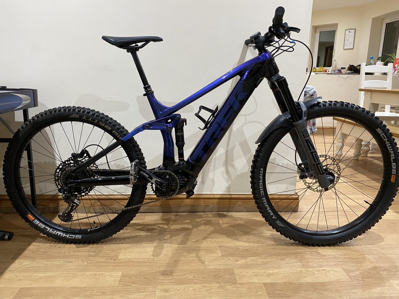

Sorry if this has been covered but searching im finding different answers.
We know a zeb ultimate hits the frame on a medium, what about a large.
Is it also material dependant? if it clears on a large is it carbon and alloy?
Thanks

Yea i know about the trek specific version with the wider crown. I have a set on a levo sl and looking to buy a rail to transfer all my parts too. Looking to know if they clear on a large carbon or aluminium.

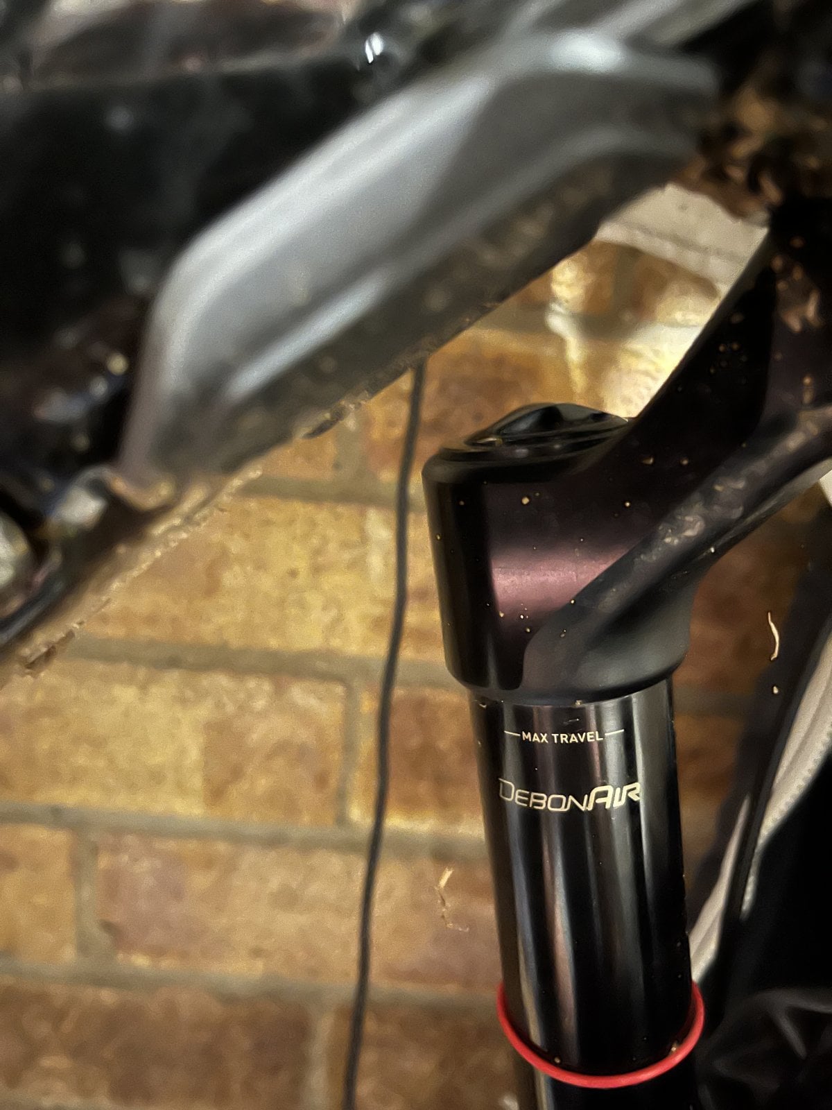

RustyMojo
Oct 30, 2021
166
105
Gloucestershire
I have a large Rail 625 with a pair of aftermarket Zeb Ultimates and there is plenty of clearance. I still run a knock block on mine as I have no reason to remove. Buy it could easily run without on the large.
apologies for the pic quality, the bike is in the rack locked up
