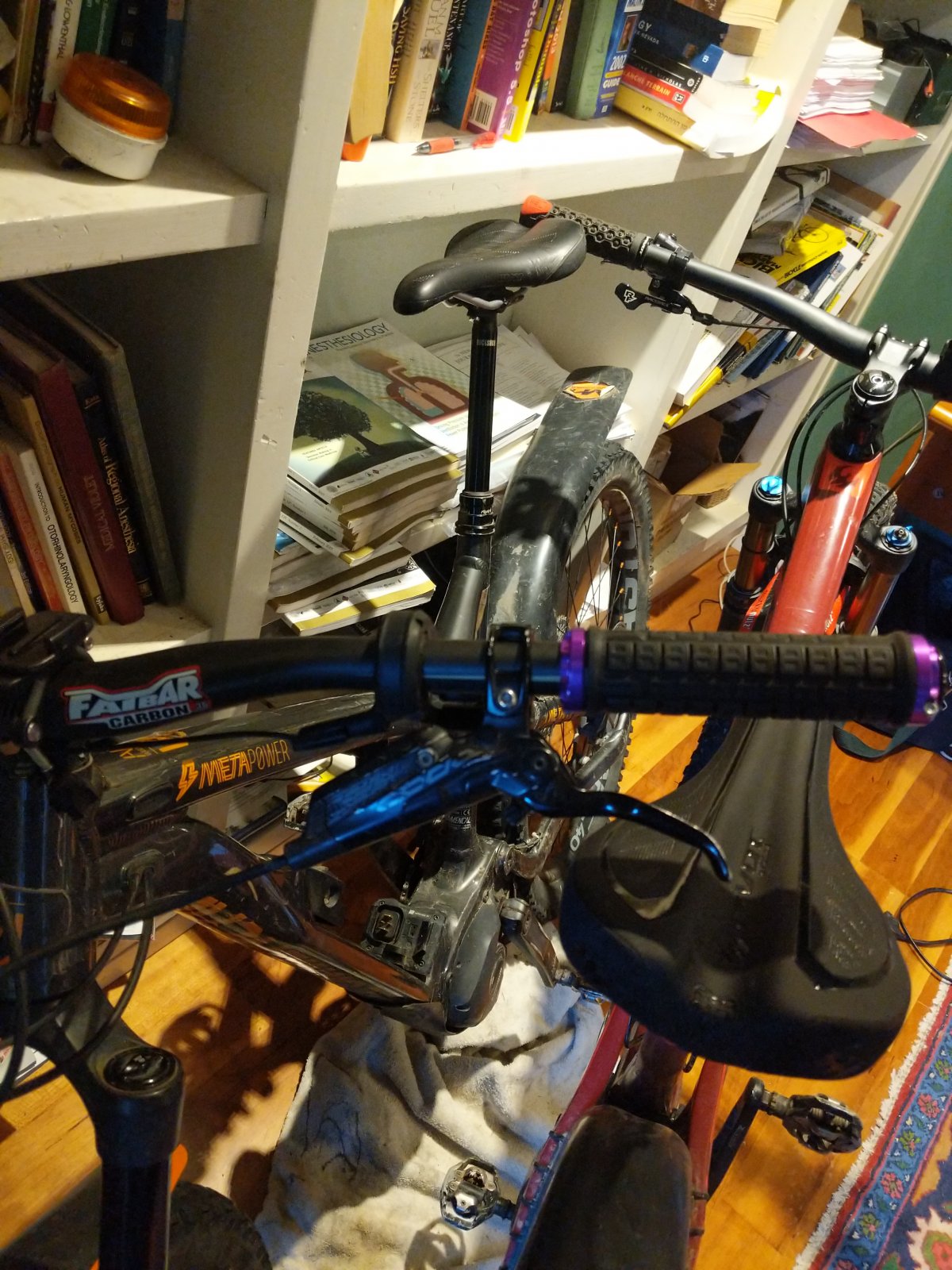

My hands got so thrashed from my stock aluminum bars on my commencal 650b meta that my index metacarpal-phalangeal joints swelled up and we're even catching my flexor tendons. And I'm a physician. X-rays showed no erosions of the joint but it's taken over 6 mo of careful buddy taping and more padded gloves to quiet it down. But a change to a renthal.fattie carbon bar was the most useful of all in addition I added rev grips at yes an insane price. I basically urge anyone with hand pains to do this. It's like night and day.

My hands got so thrashed from my stock aluminum bars on my commencal 650b meta that my index metacarpal-phalangeal joints swelled up and we're even catching my flexor tendons. And I'm a physician. X-rays showed no erosions of the joint but it's taken over 6 mo of careful buddy taping and more padded gloves to quiet it down. But a change to a renthal.fattie carbon bar was the most useful of all in addition I added rev grips at yes an insane price. I basically urge anyone with hand pains to do this. It's like night and day. View attachment 22969
