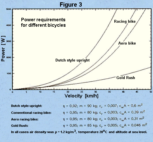

My Amish bikes are all super-draggy past 20 mph.
I never thought it was the bike, and just assumed that's the way wind resistance worked.
Here's a little graph I just bagged off Sheldon Brown's site. You can see that wind resistance really picks up after about 15 km/h. Your bike's curve is going to be close to the Dutch Style. In other words, your bike is like a giant pig with a sail on its back.
