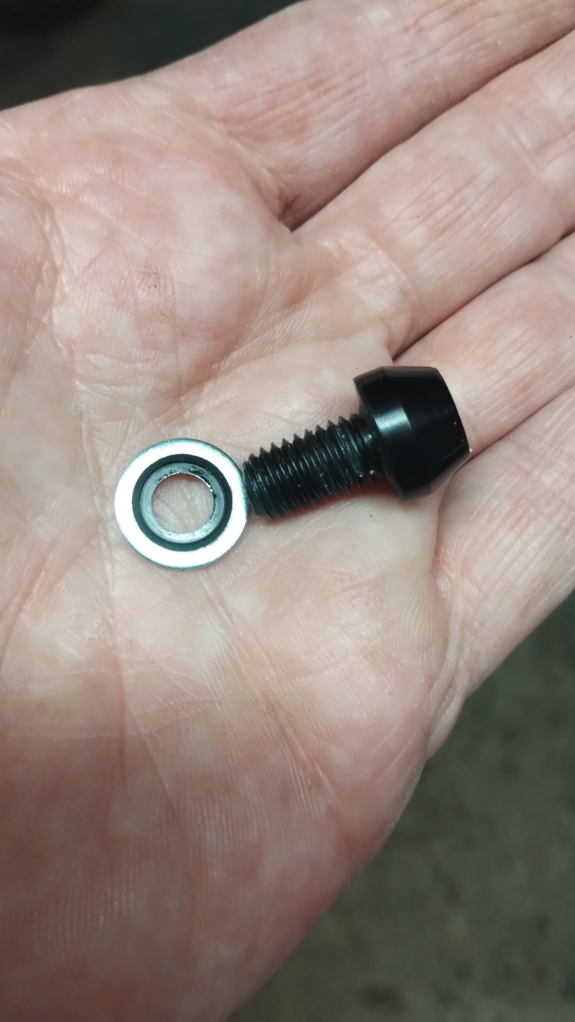

This has come up before & I agree, it is a swizz that they can't be bought separately. Some ideas above, another is dowty washers. I've used them for a few years & so far so good. Pennies to buy.

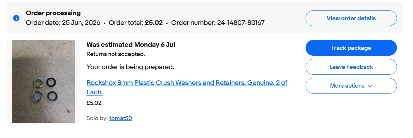

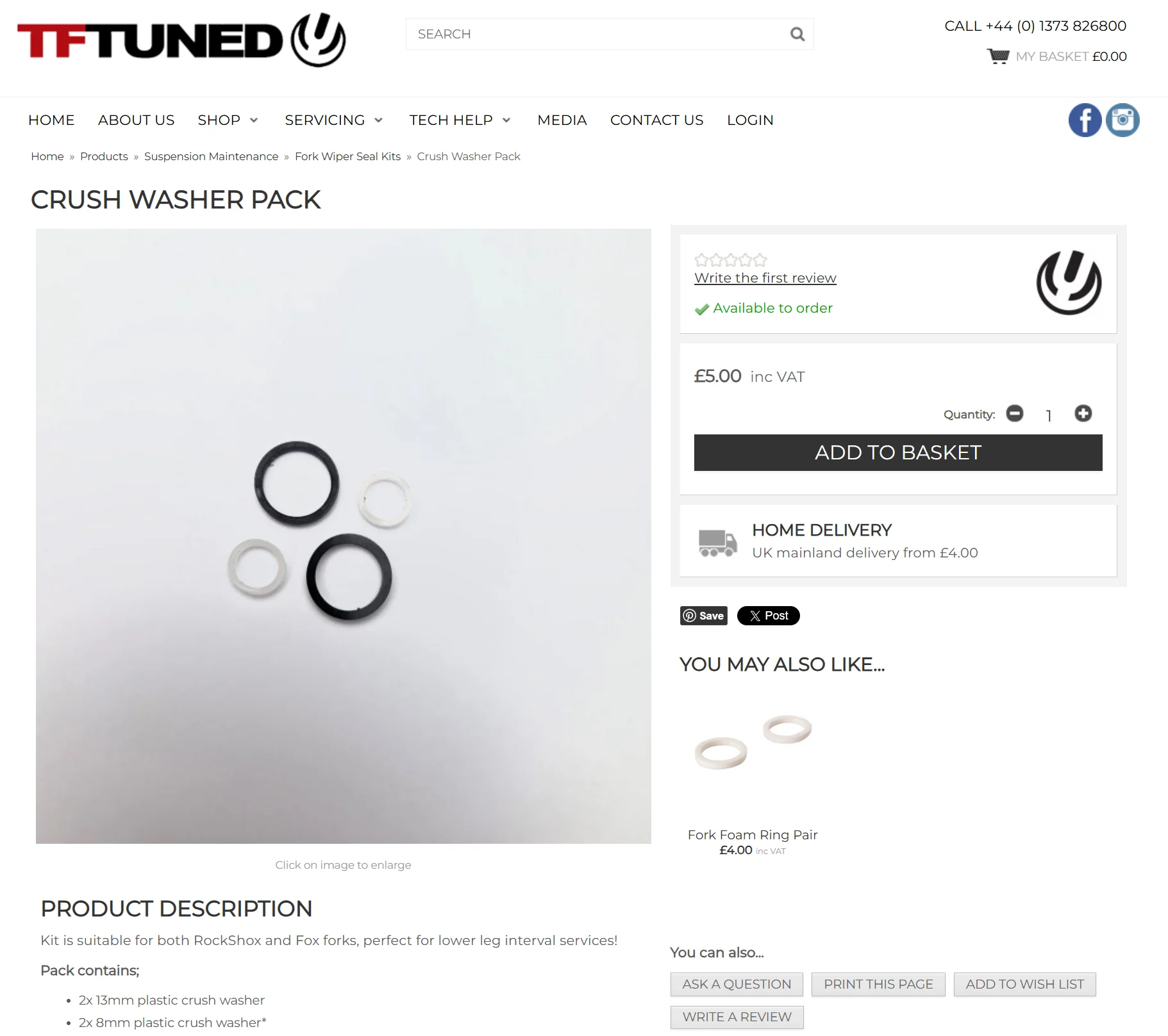

8mm spring-side crush washers are available on ebay for a few quid, and from suspension service centres like Sprung and TF Tuned, and are in the 200h service kits that everyone sells. Sprung told me that you don't need to replace the flanged one on the damper side, at least not at a 50h service. I've reused mine on both sides without issue.
