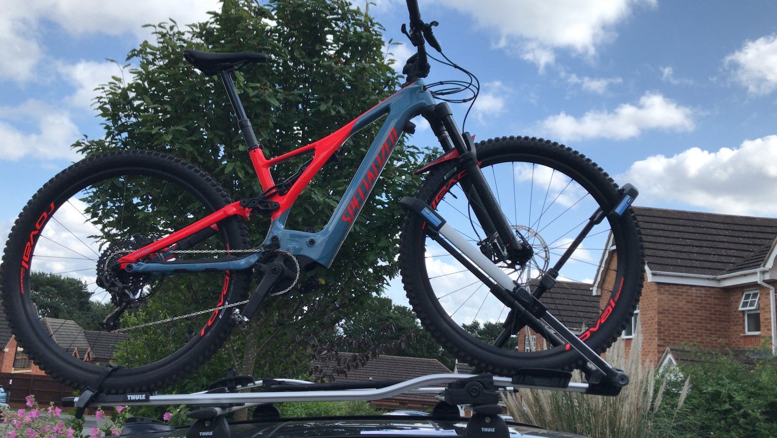

Have you actually weighed the bike? I've looked online but can't see it listed. Our HT Haibikes both weigh less than the Thule 591/598 20kg limit but that's with the batteries removed. Is it possible to remove the Levo's battery easily?
For general info the 598 has a more substantial frame clamp and tyre straps than the 591 and is worth the premium over discounted 591.

Bike weights 20kg without the battery. The problem is the frame which is too wide, the 598 arm seems to fit 8cm wide bike frame, mine is 8.3cm so I am kind of worried (maybe it will fit if pushed in).. the other thing is, isnt it a problem to transport an ebike without the battery on because of the rain?

598 won't fit a Levo (atleast Levo 2017 model). I have occasionally used Thule 565 thru ride with battery removed. It's just a pain to put the bike on the 565 without someone helping. 598 is way better, but won't work with the majority of ebikes.
Roof racks and ebikes are a major pita. Look for alternative ways to transport.

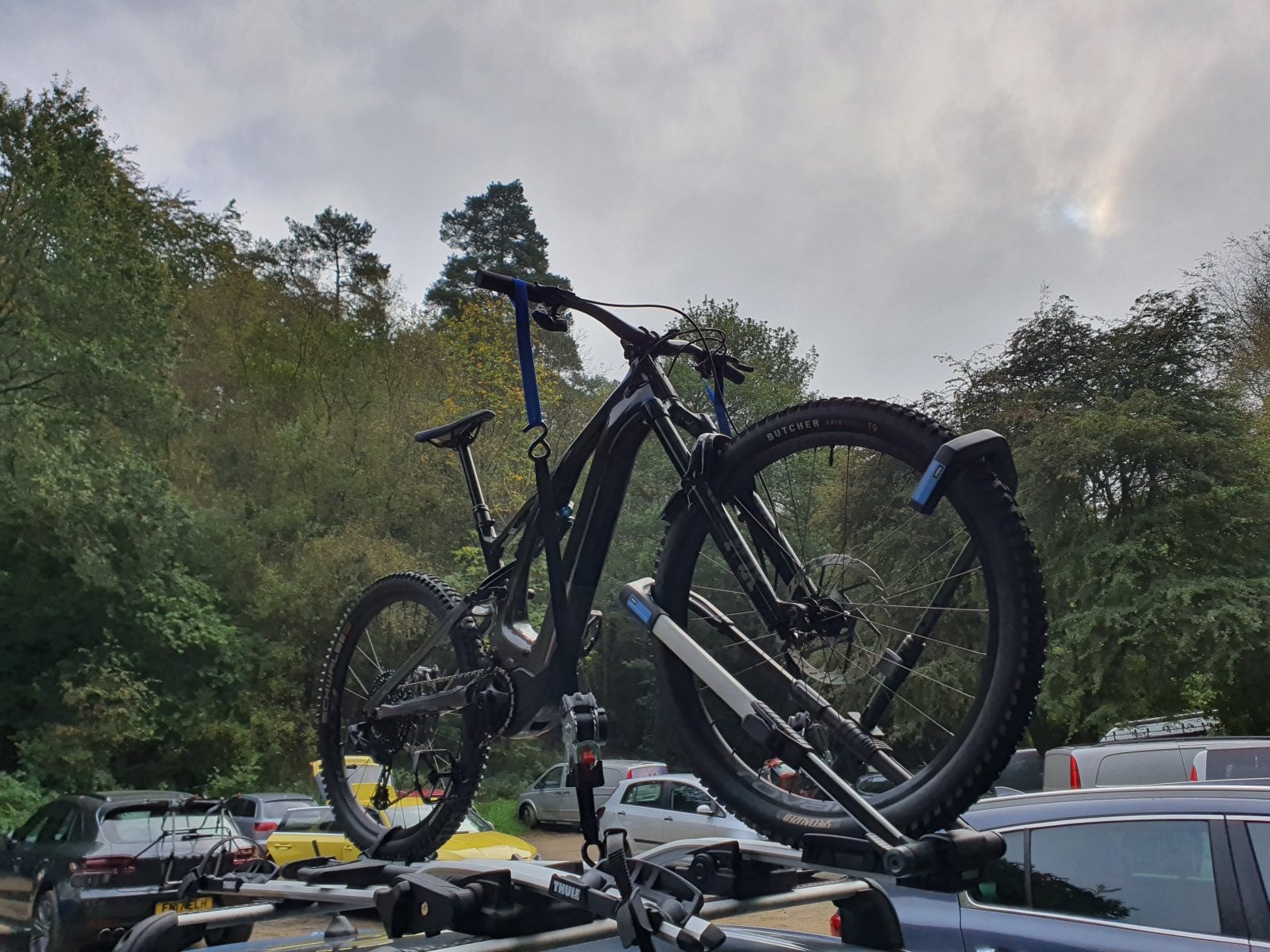

Wouldn't securing with straps help (until Thule updates their models)? MX bikes are held vertically with straps:

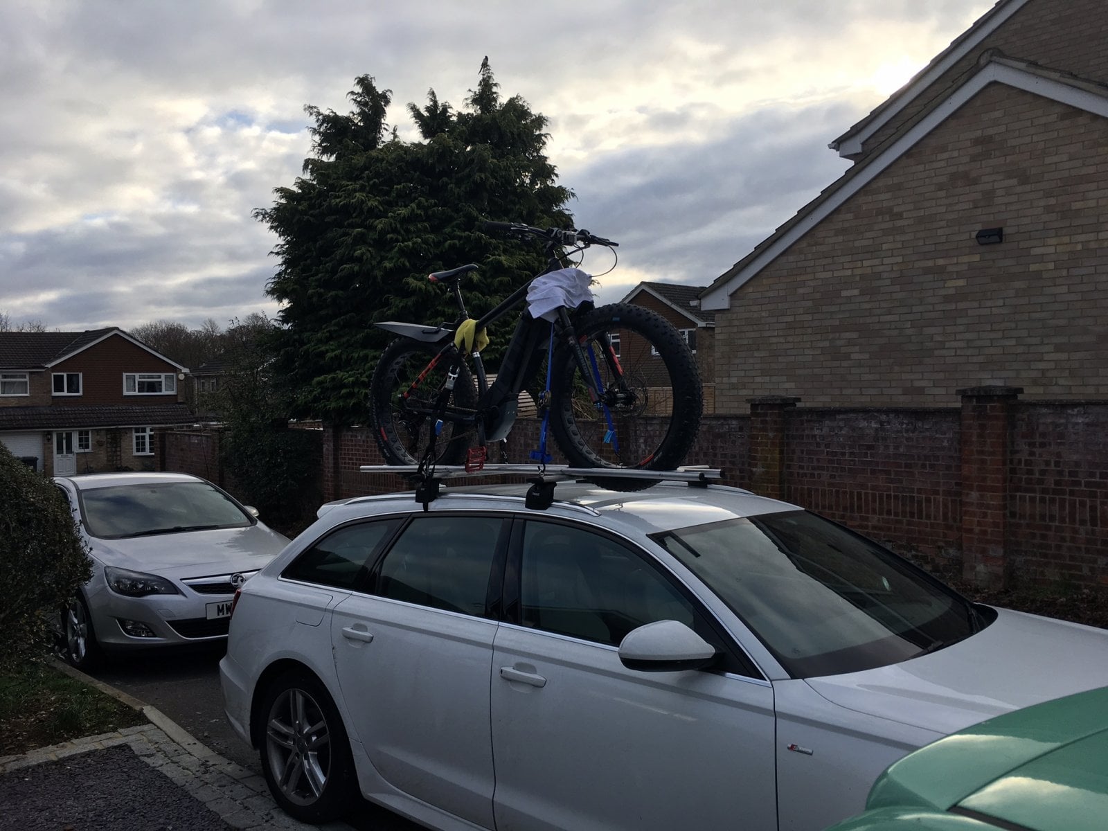

This is my fat bike on a roof rack I made for it, basically secured with ratchet straps. I’ve used the same method to secure my FS and wife’s hard tail on standard 20kg max Thule bike rails. Apart from ratchet straps all you need are some lifting eyes and rail bolts.

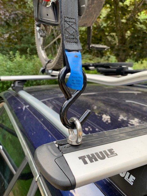

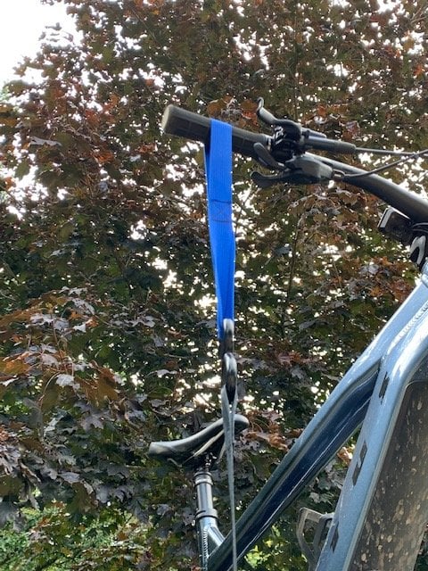

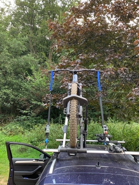

I improved my 599 setup with ratchet straps and eye bolts. The hold is so strong, that there is no sound from the bike/rack when the car goes side to side (it used to creak even with 15kg bikes). You just forget that it's there. I used to pull out the battery, no longer have to do it.
Eyebolts:
Ratchet straps:
Handlebar soft loop for ratchet:

Nice, thanks for this I'll go for the same setup

Worked great (didn't fall off) thank you.
