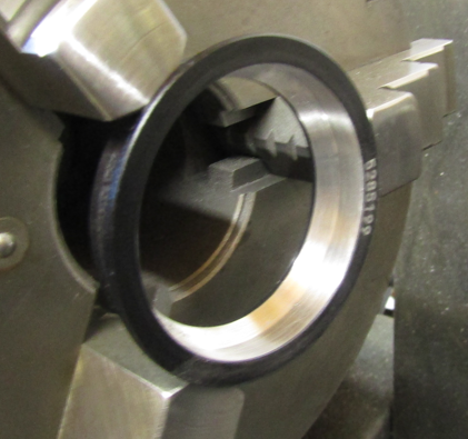

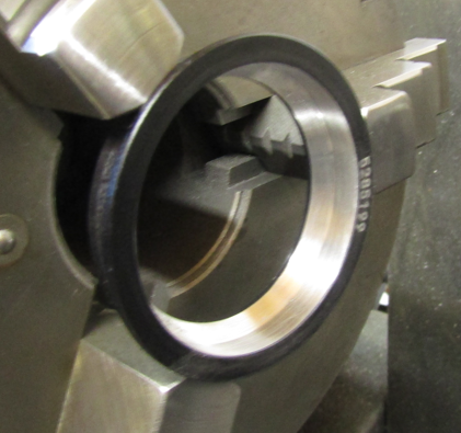

Pic: Smoothing out a rough spot on the lower press in cup for my FEX8g6:
BTW... my FEX8g6 had a horrid creak noise from day 1. Finally traced it to: no grease at the interface between frame head tube and press in bearing cup.

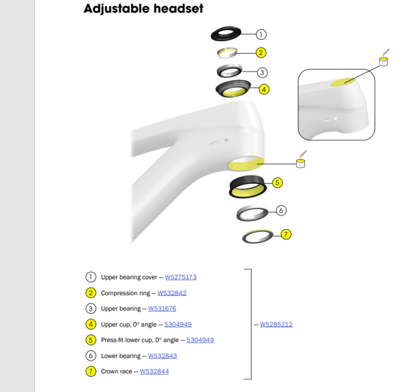

Good question... The online service manual from the Trek site shows that it is to have grease.
In the pic, the press-in cup is #5, and it shows to apply grease.
Now a totally unrelated thing is... that top bearing cup, #4 is not round. It is oval, and is NOT press fit. The one that came in my bike is labeled 0°. Since the headset is called "Adjustable", I assume you can get a 1° cup, and install it one way and kick the rake out 1°, or install it the opposite and pull the rake in 1°. Kindof a guess on my part.
