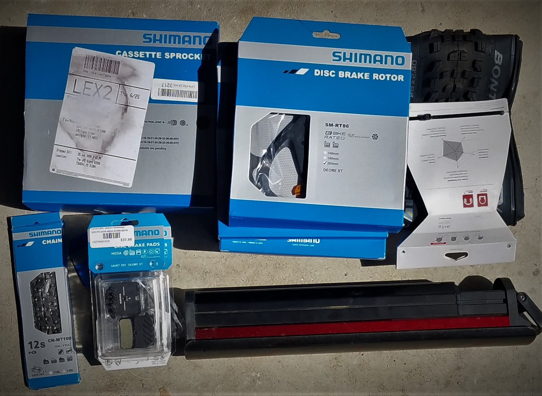

I had no problems with the stock rockshock pumped all the way up, I'm not saying it was ideal...Got about 8500 miles out of it riding mostly medium trails. In my opinion what you should be most concerned about is the stock brakes, on a steep hill my brakes would get super hot and lose power. I went with Shimano Icetec R86 203 mm rotors and Icetec pads, Organic compound in the front to minimize squeal. I lost about 30 pounds the first year and the exercise cured my meniscus pain. Good luck and have fun!
