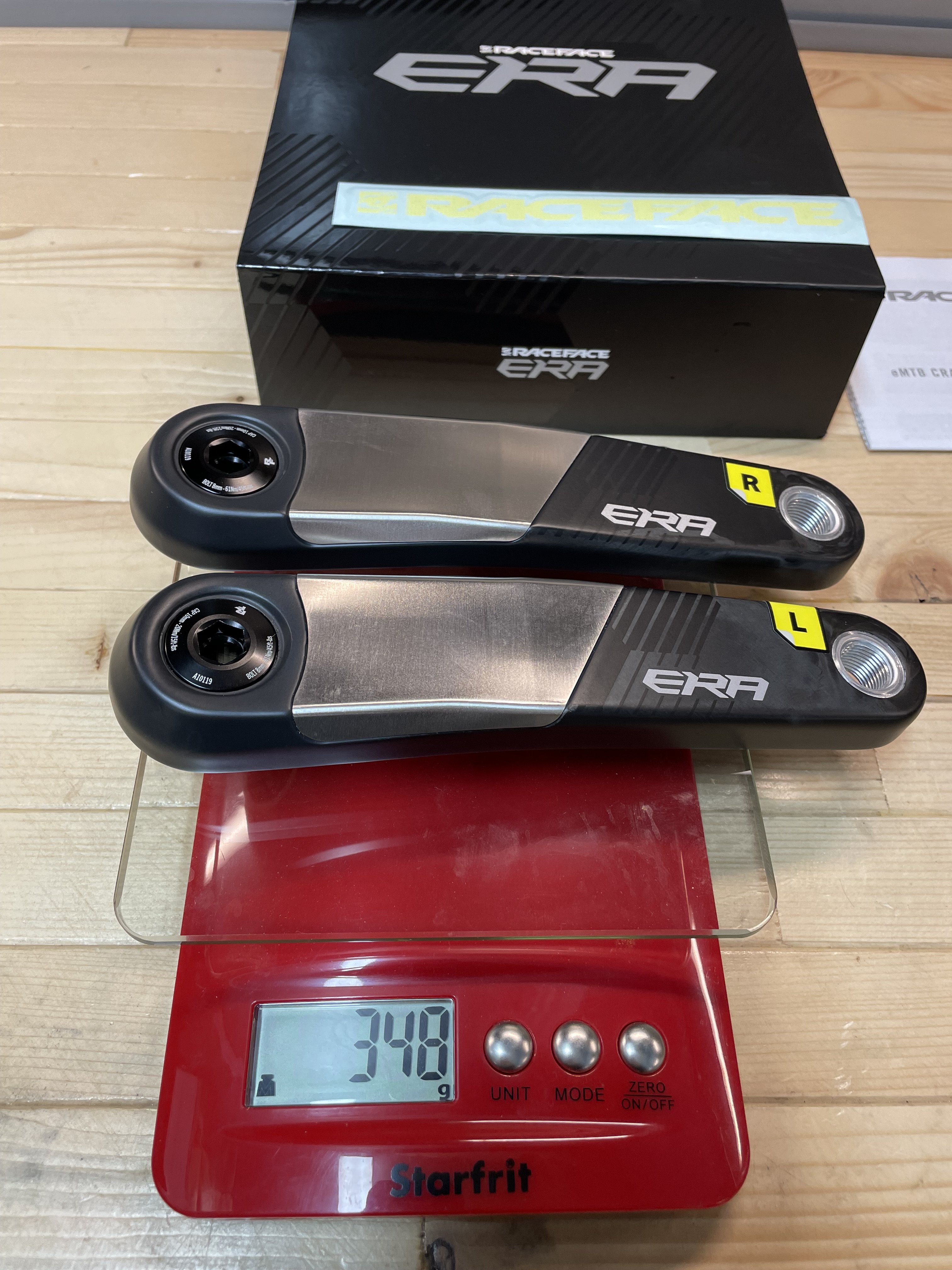

160mm. The bike came with 165mm alloy. I wanted to install 155mm cranks for less pedal strikes but I couldn’t find them in carbon.
I watched a video of some guys destroying carbon cranks. Failures were mainly at the inserts, which to me is a critical weak point. However the Era carbon cranks broke or failed in the middle under more pressure or torque. That made more sense to me.
After a serious peddle strike I don’t want the crank failing at the peddle insert or motor insert. A broken crank near the middle takes more effort. So I was convinced. These ERA cranks are only slightly shorter (5mm) and I never really noticed a difference in my cadence or additional torque required. But they were pricey, but not as pricey as Titanium cranks (holy sh**).

@Zimmerframe did a good review of the 3D printed Titanium cranks. I can’t attest to the strength comparison between these Titanium and Carbon cranks, but the Era carbon cranks seemed to be lighter.
I’ve been using these for several months now.

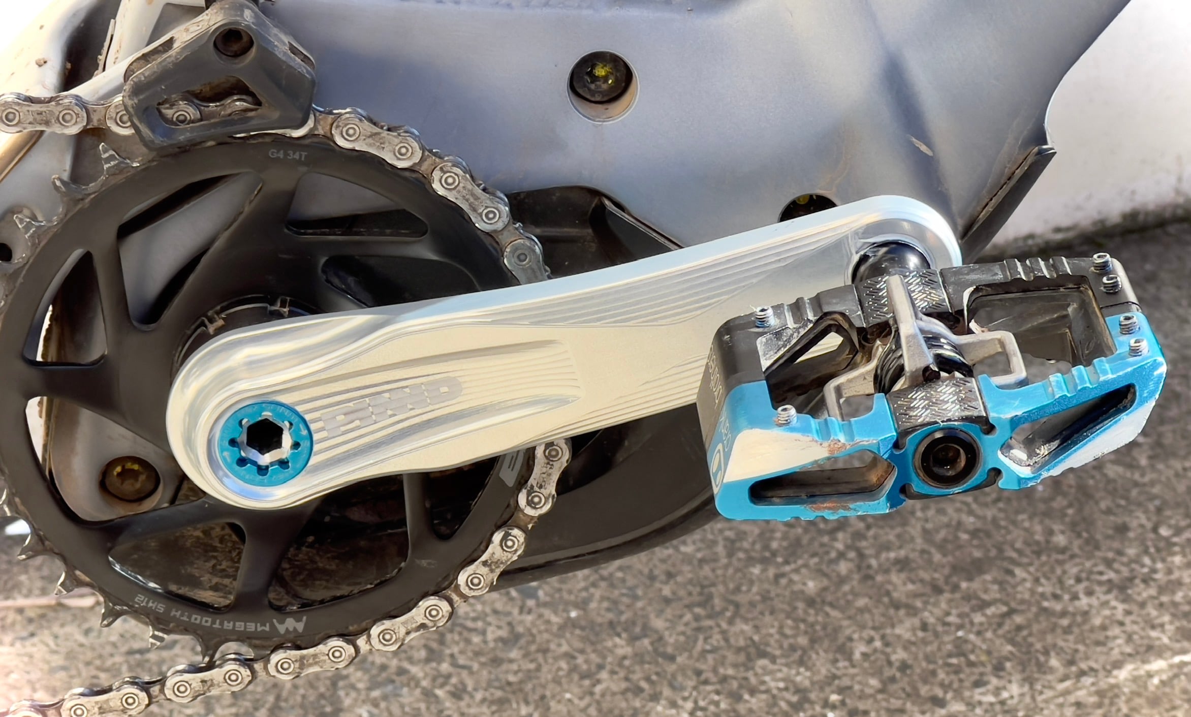

155s for me as well. I replaced the OEM 165s that came on my bike with Miranda 155s and I can't think of any reason to swap back. I'd like to experiment with going even shorter if cheap 145s were available but afaik 150 is as short as Miranda go and I'm not sure that another 5mm would be very noticeable. More expensive 145s are available but I don't really want to spend a lot in case I prefer 155.

I’m running Hope 155mm cranks, even though I’ve only done around half a dozen rides since I bought them I’ve only had a couple of peddle strikes so already it’s been a great buy 😎

After digging my outside 170mm crank arm into the dirt on a corner that was totally unexpected and dropped me like a hot rock I have gone to 155mm Miranda's and never had it happen again. Doesn't do much for unassisted pedaling but works fine as long as the power is on and you can keep a high cadence easily if that is what your bike performs well at.
