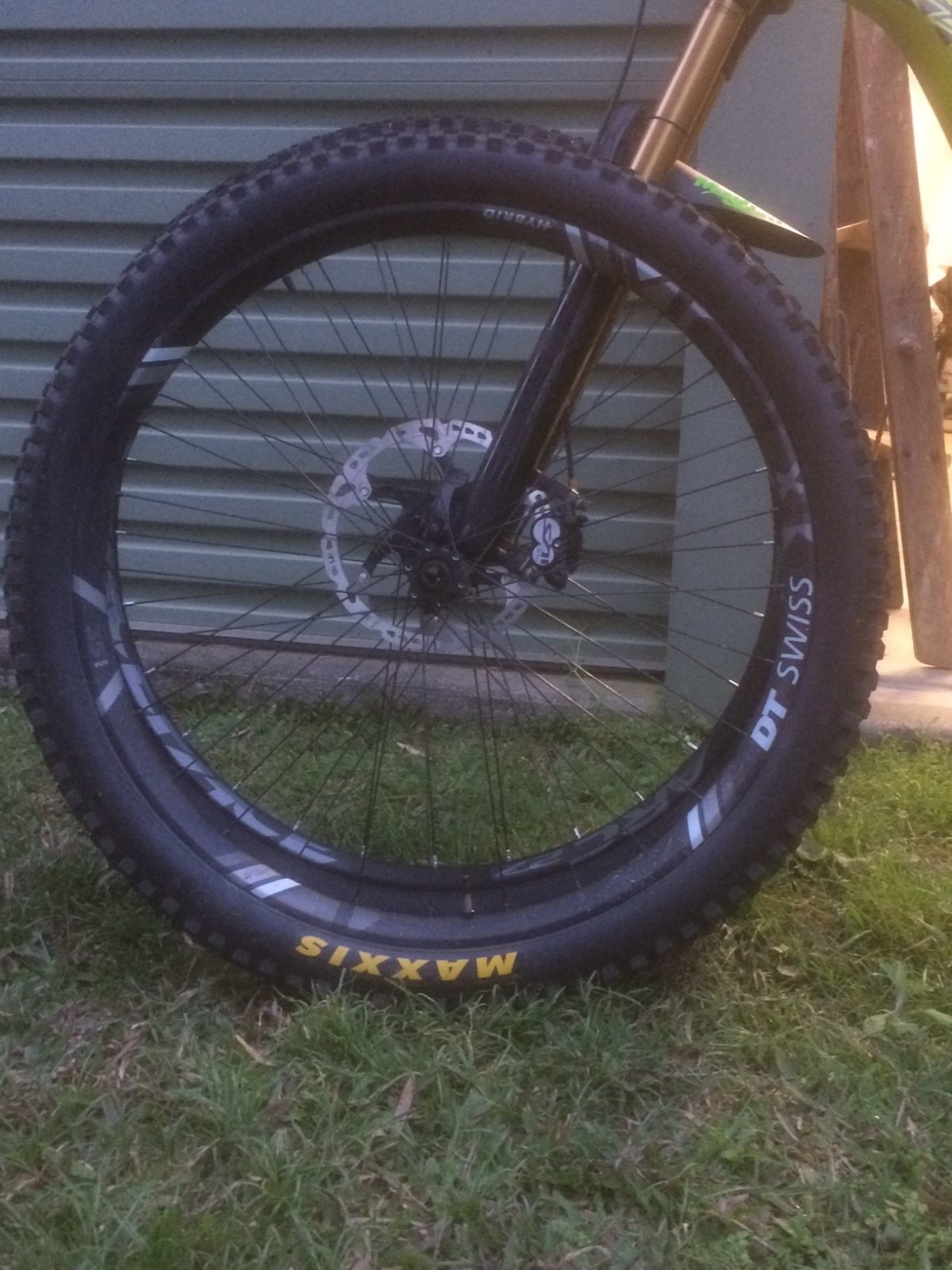

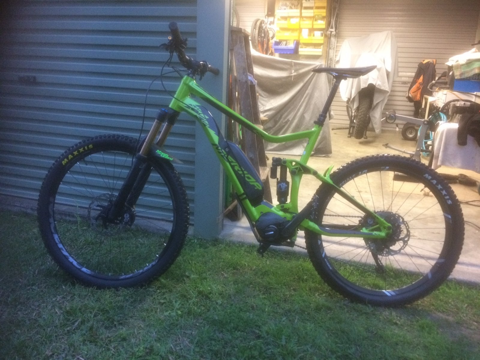

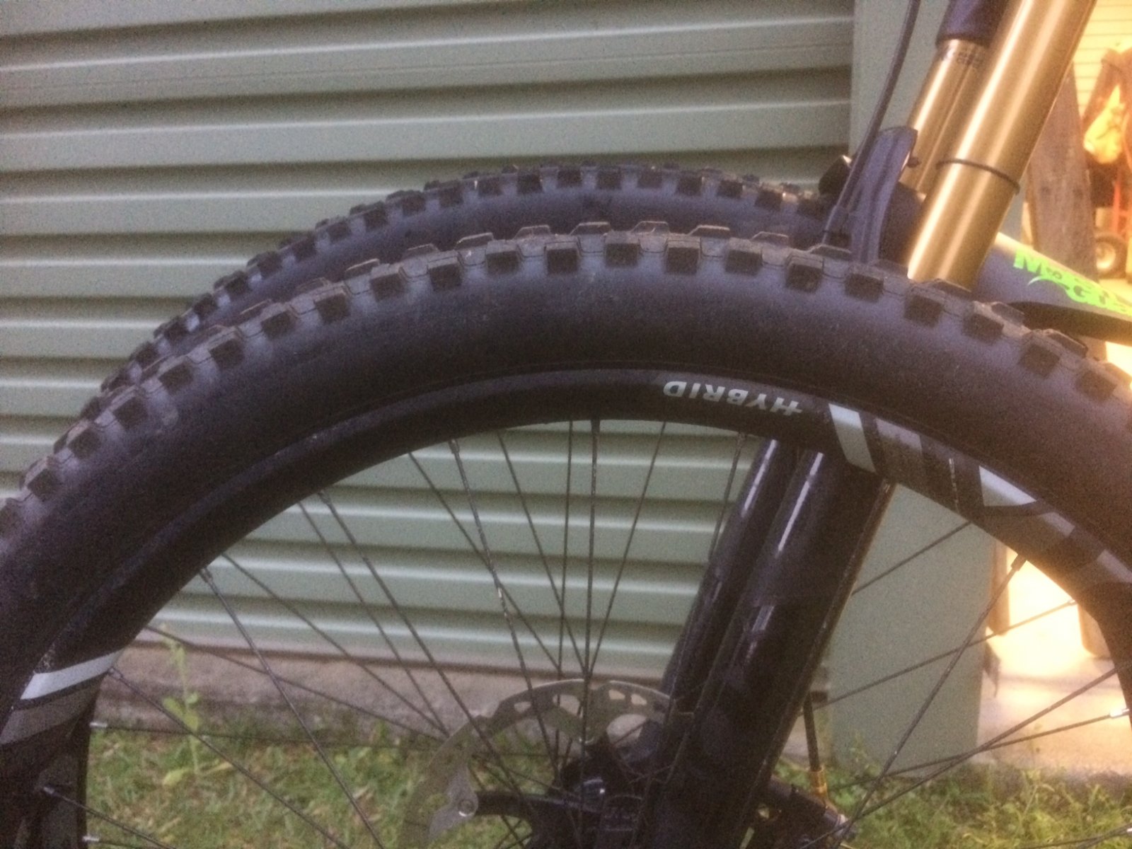

Well first real ride with the new combo on the bike this weekend past, did about 15km both Saturday and Sunday mornings.
First impressions are that the positives outweigh the negatives. Positives are better at rolling over roots, rocks, ruts and rough stuff etc with the larger front wheel, has slightly elevated my pedals as did not get a single pedal strike on either day though that could also be due to changing my pedaling technique as well, plus the bike feels more like it's on rails over the serious stuff on the steep downhills.
The only drawback I could find was that it was turning a little slower and wider around the tighter (read almost and actual hairpins) corners. Loved it though and will keep it for now for a longer test period. Can't wait to get out again mid week for another blast and averaging about 100km a week at the moment and need to get as much riding in now before it's too warm to ride in our summer.
