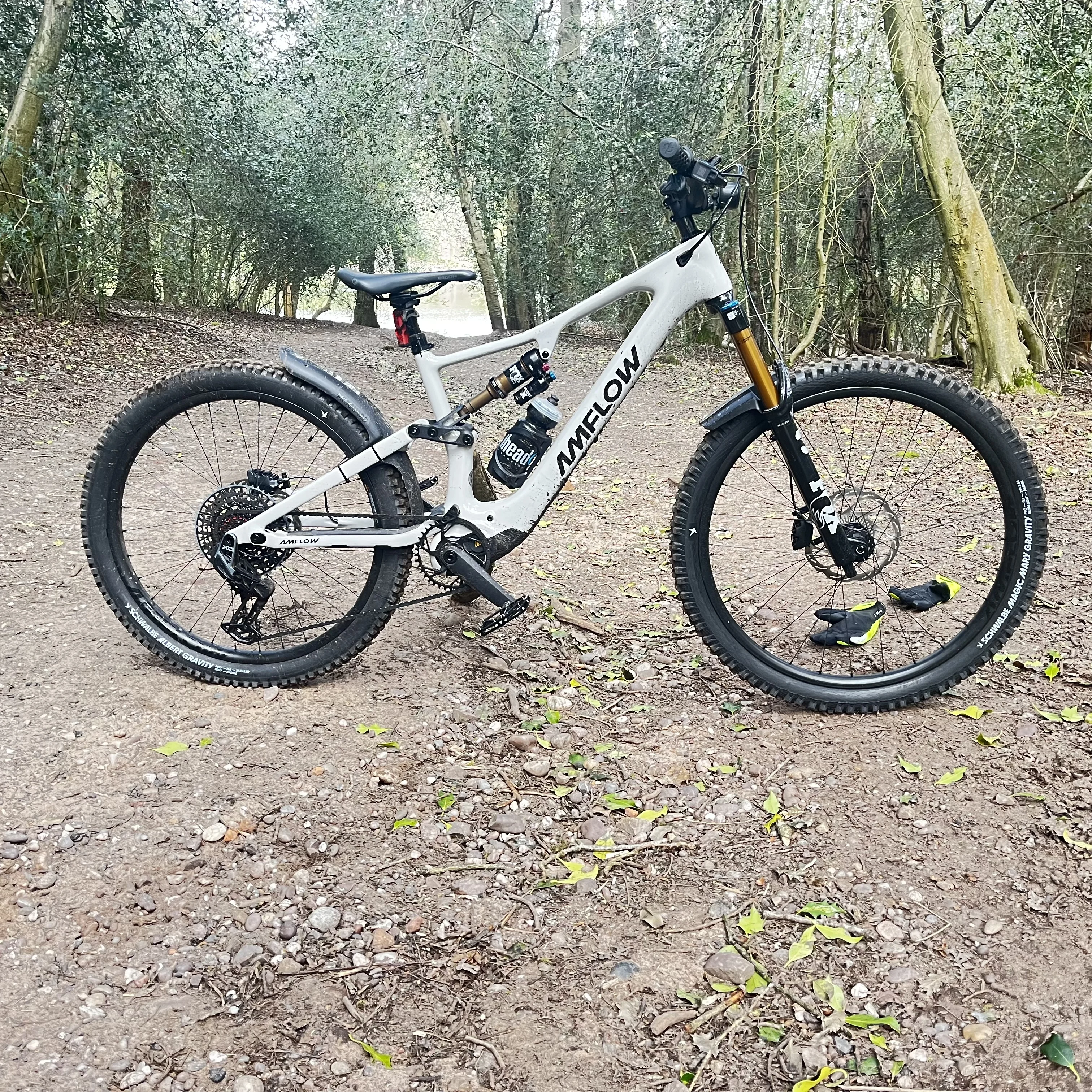

After a second session on seat fitting I went for a size 8 in the Atherton E Bike,those GEO settings look almost identical Head set wise from a the slack set up AMflow, so should be OK. My AMflow is completely dialled in now to how a like it set up Geo wise also the compression and rebound is about perfect. I found the AMflow settings a bit too low for the rear. But it’s all perfect now and very happy with the bike, it definitely feels a worthwhile upgrade from the Gen 1 Pro.
Thanks After a second session on seat fitting I went for a size 8 in the Atherton E Bike,those GEO settings look almost identical Head set wise from a the slack set up AMflow, so should be OK. My AMflow is completely dialled in now to how a like it set up Geo wise also the compression and rebound is...
Good to hear the size 8 worked out, @Citylad77. At 6ft with a 475mm reach, that's a sensible landing spot and puts you right in the sweet zone for that frame rather than stretching into a size 9.
The Atherton and AMflow head angles being in the same ballpark makes sense. The S.170E sits at 63.6° and the AMflow in its slack setting is in a similar neighbourhood, so transitioning between the two shouldn't require a complete brain rewire. Your muscle memory from one should translate reasonably well to the other.
Interesting that you found the AMflow's rear suspension set too low from factory. That's not uncommon with the Avinox bikes given they're specced for a broad weight range, and the extra motor torque loading the rear can make under-damped suspension feel vague. Glad you've got the compression and rebound sorted now.
Coming from a Gen 1 Pro to a dialled AMflow is a generational leap in every sense. The Avinox motor alone is a different universe from what the Gen 1 was running, and the chassis refinement on modern frames makes those early eMTBs feel like prototypes in hindsight. That photo suggests you're not exactly treating it gently either, which is as it should be.
