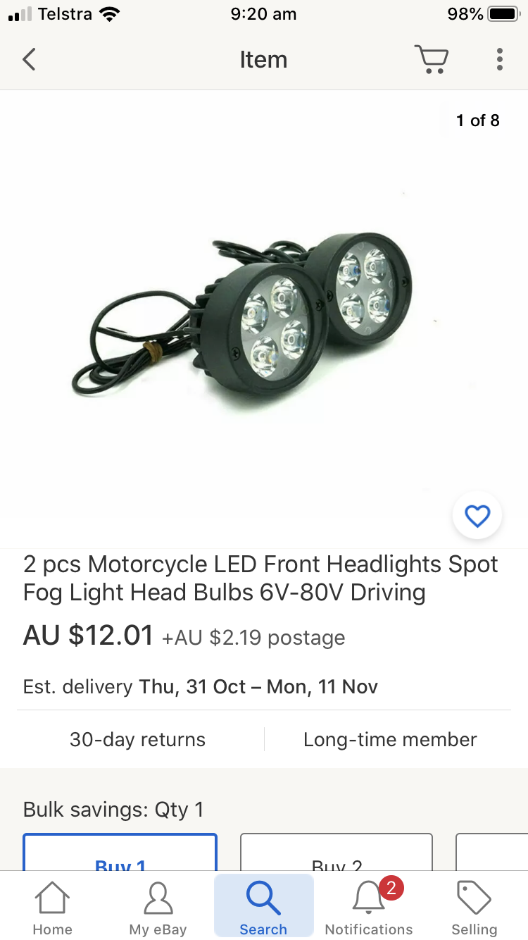

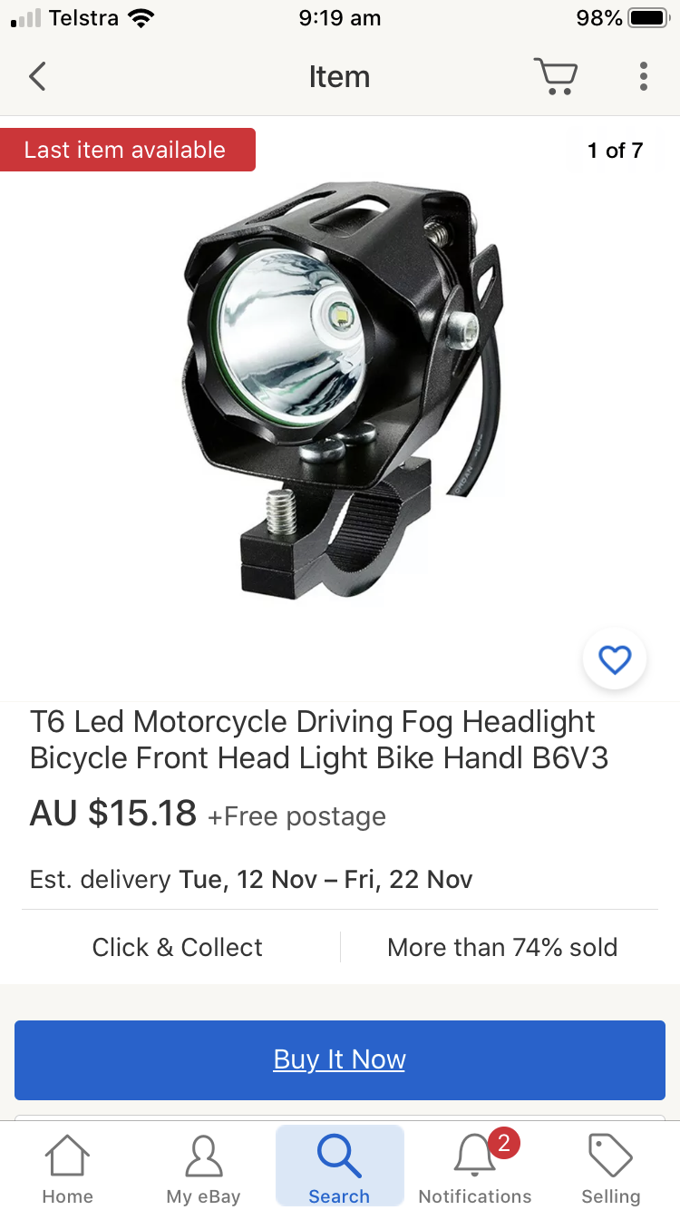

Only tested with the bike turned on, not turning the cranks. I guess it’s constant 6v, don’t know what amps you could draw from it. I briefly looked at motorbike lights as some of them are 6v but they would have to be led and therefore low amp draw.
Cannikin
Oct 15, 2019
36
50
San Marcos, CA
Ahh yeah, I wasn't event thinking of wired ones, that's even easier. Do those have on/off switches on the lights themselves? Other than the whole voiding-your-warranty thing, and how to route the power wire, it seems like a great way to add a light to your bike without worrying about yet another device to charge.

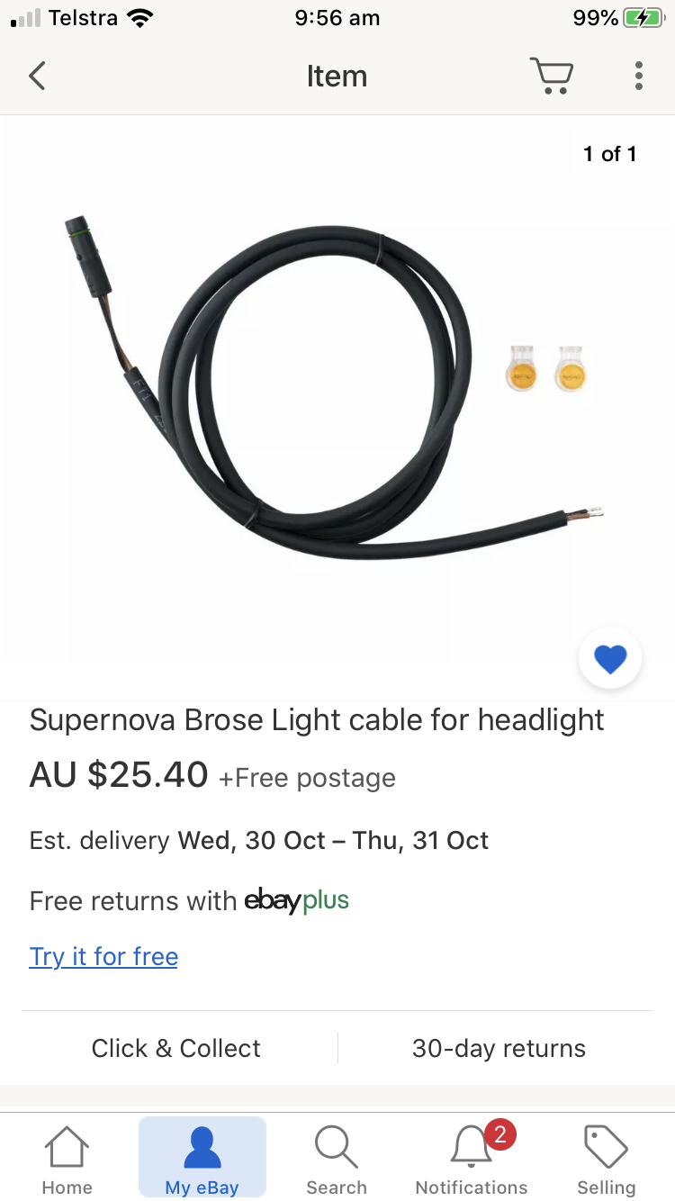

Oh snap that's specifically a Brose light cable...I wonder if there are other Brose bikes already using these ports?
Yeah, it’s what they are for. Some commuters use them, hence why Brose made it this way. You have a front and rear light port and the other I think is for a bar mount display.

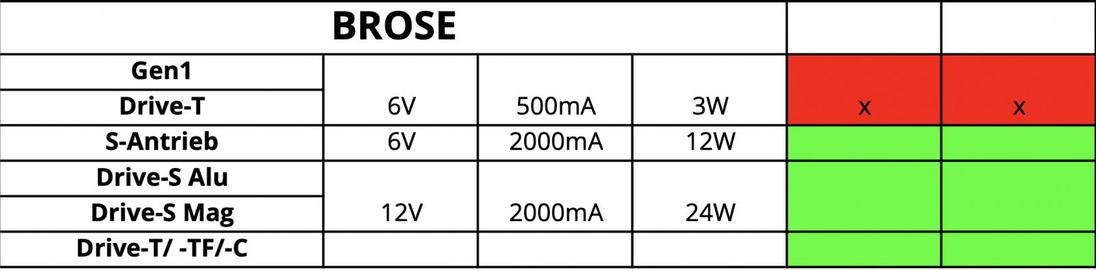

I don't have the source anymore but I have read that front light output in brose 2.1 mag s is 12V and 2A.
Edit: I must be blind. This info was already in post #12 above.

As you've seen from the table above, the light ports are available but limited to 2A max - this is pretty important. We've seen with the Lupine SL SF (for example - with high beam) that the inrush current is way higher than 2A so the motor sometimes shows an error. Same with the Supernova M99 mini (we believe - we're in the process of checking this out). Key point is being sure to keep the inrush and regular use current under 2A if you use these light ports on the Brose motors. Note also that the max current on the Brose 1.1/1.2 motors we used on 2016/17 Levo and on many Vado bikes is 0.5A.
