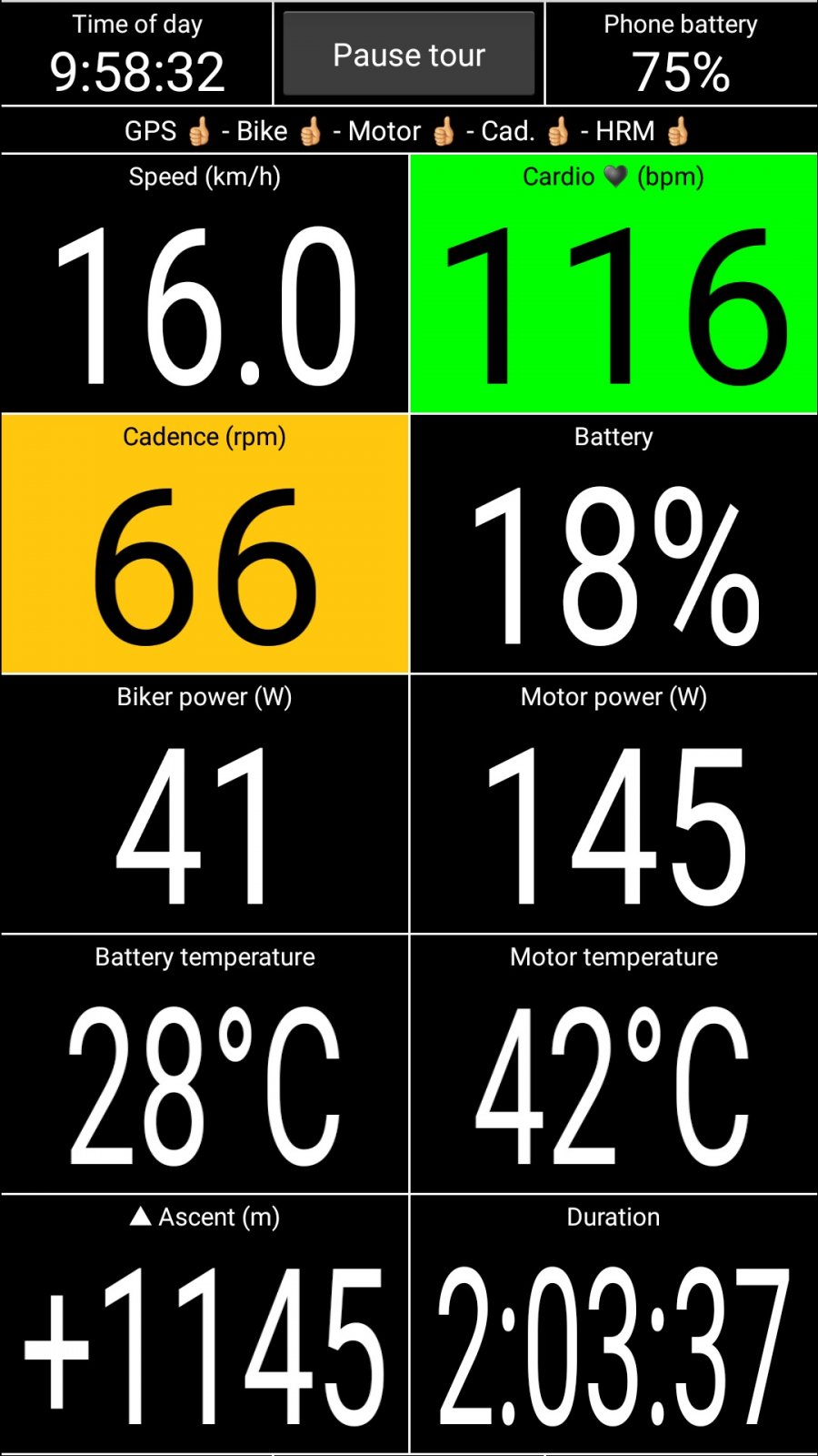

Hi Tim, Blevo already does this and also the Battery temperature ?
See my screenshot below

Not sure where you are getting your figures from Tim but on a 75 degFh day my motor runs quite happily between 30 degC - 86 degFh and 42 degC - 108degFh and higher without losing any power.
I know I am not losing any power as the maximum power output is constantly being displayed ‘live’ on my display on my ride. I have a 1.2 motor and this pushes out between 640-680 Watts while I am riding in Turbo mode. The 1.3 motor, I have seen screen shots from the other forum members of between 720-780 Watts.
The only time I ever see my max output power going down is when I am riding my bike on Turbo and the battery level drops under the 40% mark.
This is why I find Blevo soooooo good, it pumps out all this, and for me, really useful info and loads more.
I need to do some more testing on this so I can capture more accurate info for you.
