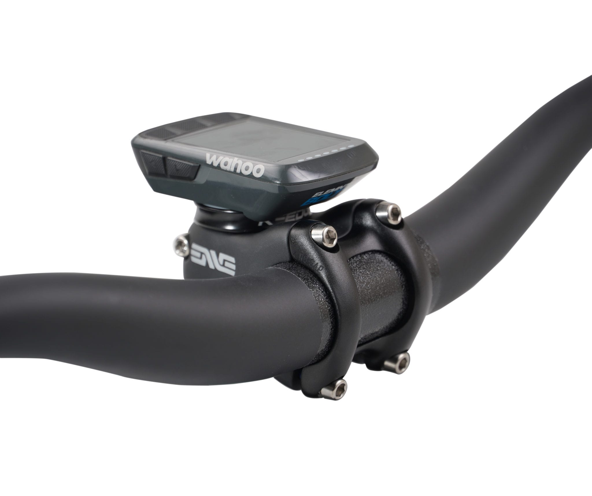

Wahoo Bolt/Roam with a stem mount is better, easier, tidier...

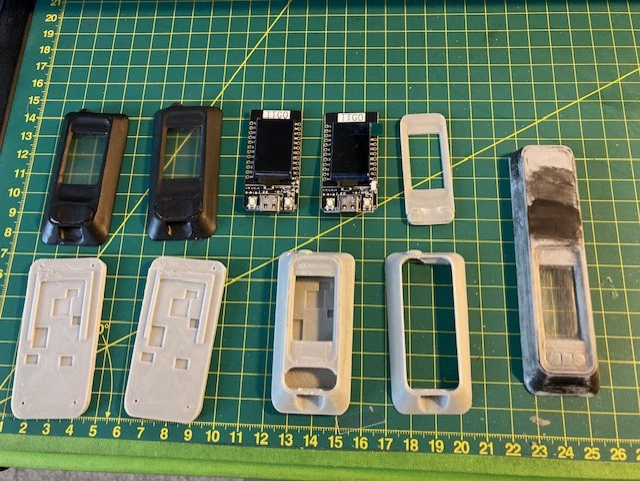

Yeah, I'm running Gen1 Kenevo, just really want to see the very basics so rolled my own display:
Served my well, seems stable enough, useful to in making adjustments to support levels on the fly, but still think I should add a set of pre-set support levels as it's a bit fiddly to set on the trail.
Looking into a few options for devices ... here is the original DEV setup:
A screen and a micro processor, but now these combined modules I'm playing with are cheap as chips ...
LILYGO T-Display-S3 circa 14 pounds, probably a bit to big a screen for my liking, but colour so yay
TTGO T-Display circa 10 pounds, may create the enclosure and test this one on the bike.

I'm still rocking the mono colour Version 1 on my Kenevo ... love it! I'm still messing about with the code wanted to see if I could connect to the old Heart Rate monitor as well (but am a lazy arse!), but if I pull my finger out I'll design an enclosure and send you a unit with basic battery and speed screens ... the electronics are like 20 pounds if that ... let me see if I get some time in the next couple of weeks.

Gen1 people ...
Finally had time to spin up the 3D printer and experiment with a few ideas of a new enclosure ... hopefully ready to test ride in the next week ... just painting inside with latex to give some protection from water entering the enclosure.
