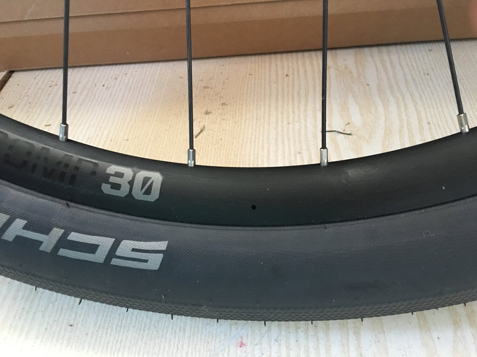

But there are small holes in both my Raceface AR+0 rims which the FinishLine liquid is oozing out of..
LBS claims all tape was good and offer to re do them BUT are these holes acceptable? 192AE005-0262-4FB2-8120-9939A25E40B5.jpeg
Eckythump
Jan 16, 2018
832
680
North Yorkshire
That’s not very helpful is it?
Have you checked if those holes go right through to the rim?
They probably just go to a chamber in the profile. If that is the case the air is getting around or through the tape or around the valve into the chamber the spoke & valve pass through.
If you get it sorted you might want to put a bit of electrical tape over the holes so water doesn’t get in.
