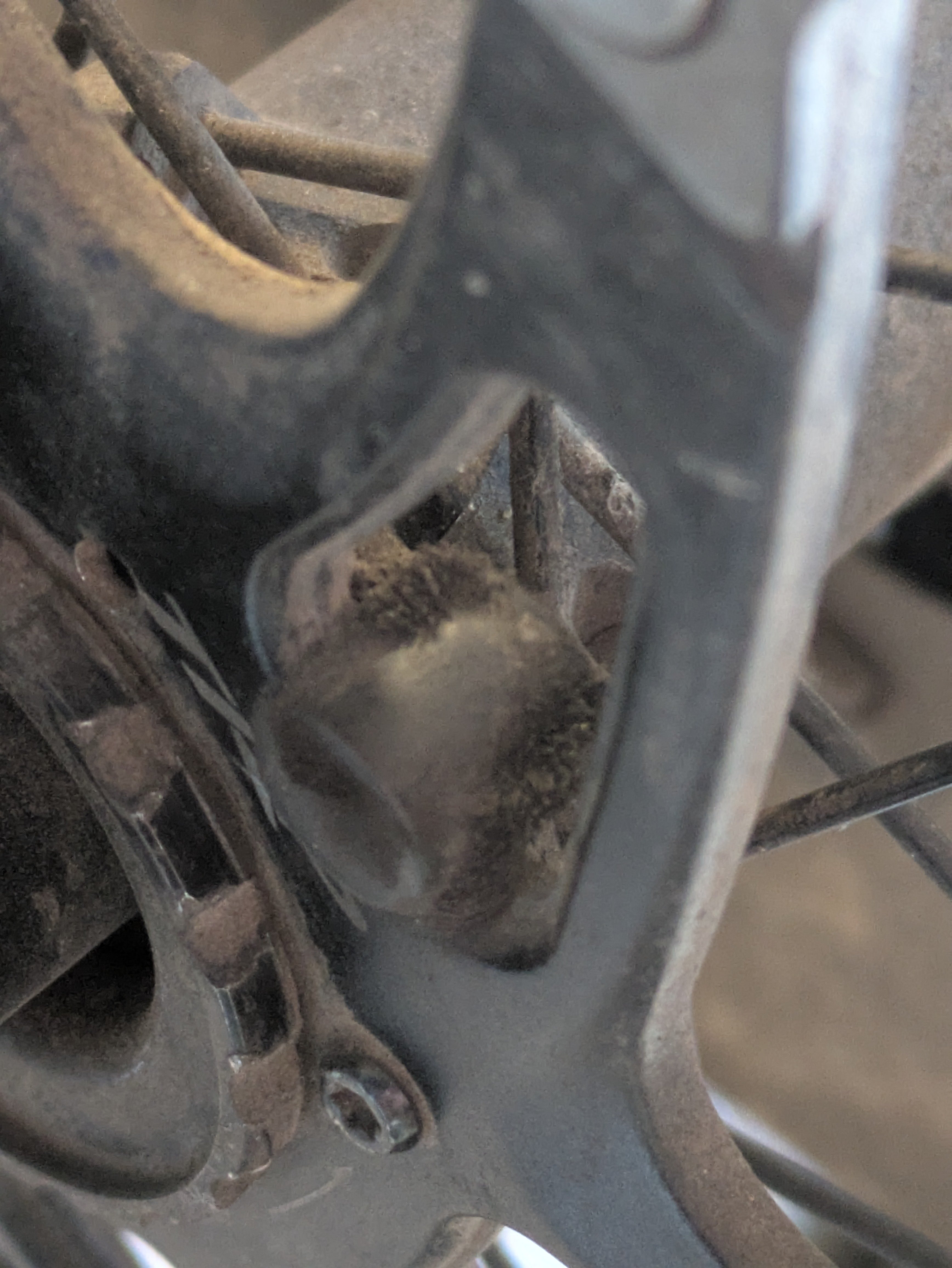

The magnet won't matter as it will work on both motors.
I swapped a Shimano centrelock hub for a DT swiss one and the adapter swopped over ok. Which I assume is a Shimano part
I also fitted a 2.3 disc, but had to file a bit out for the magnet and drill a hole for a securing screw.
Been working fine for a couple of years on my Bosch Gen 4 bike.

Thanks for your reply and your photos.
But I should perhaps have stressed the fact that the Trek Rail has its own proprietary speed sensor and diametric magnet rather than the more common axial magnets whose magnetic field's orientation is different. As such an axial magnet might not work with this speed sensor. I can't say for sure, but it looks to me like the Shimano magnet is an axial type.
Hence my question.... has anyone used the Shimano centrelock magnet with a Trek Rail?
