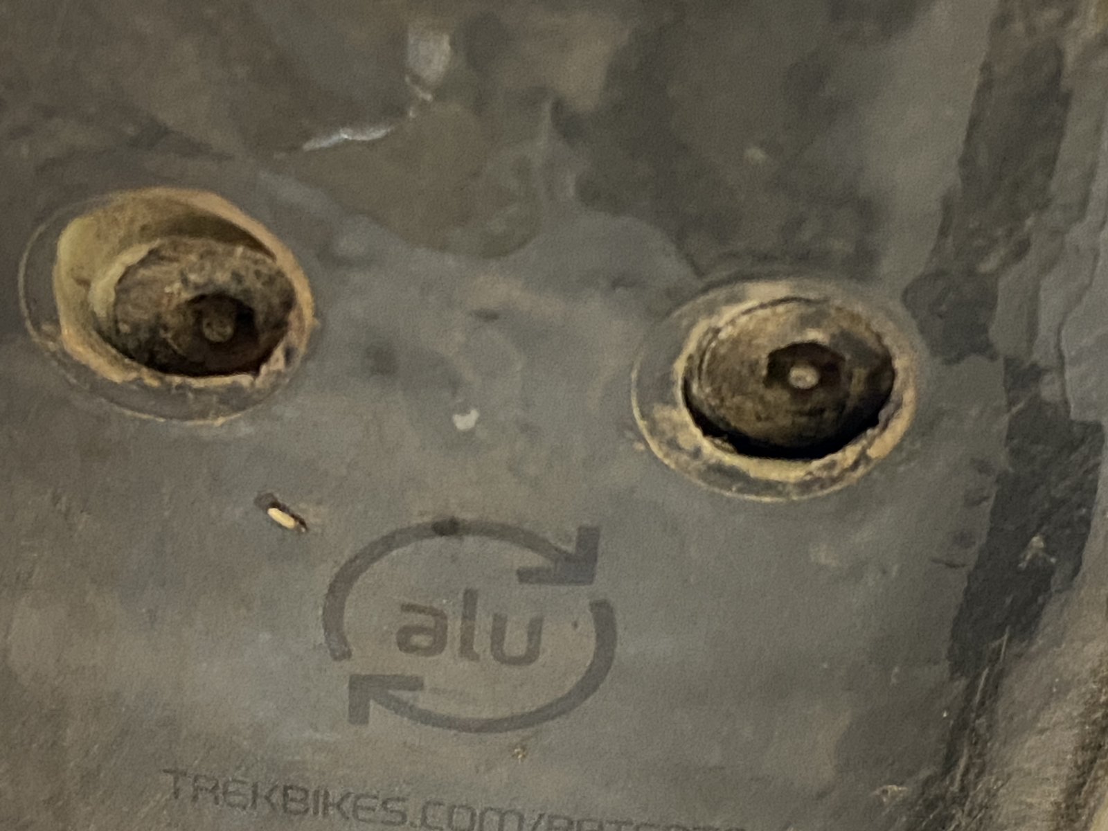

Sooo, I've had this rattle on my bike for the last 4 to 5 weeks, it's got progressively worse, initially I thought it was the mudguards, but recently I took both the front and the back off as it's been so dry, the sound didn't improve at all, rode a small loop last night, I noticed the battery gap at the top was bigger than usual, investigated further tonight.
Looks like the battery mounts that are welded into the frame have both broken off, has anyone else had this?

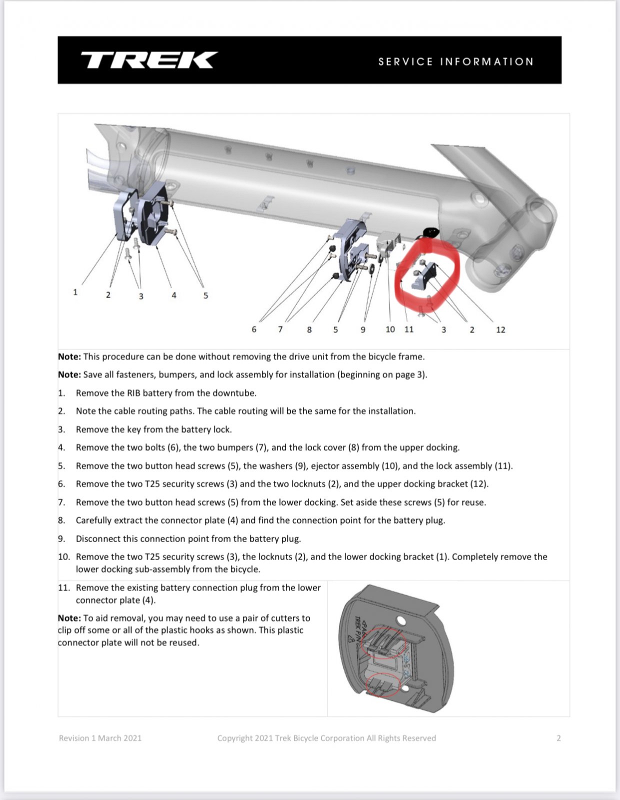

If you are talking about the plate comes with the revised RIB system that came on models after the 2020 model, I had it retrofitted under warranty and this issue still happened to me.

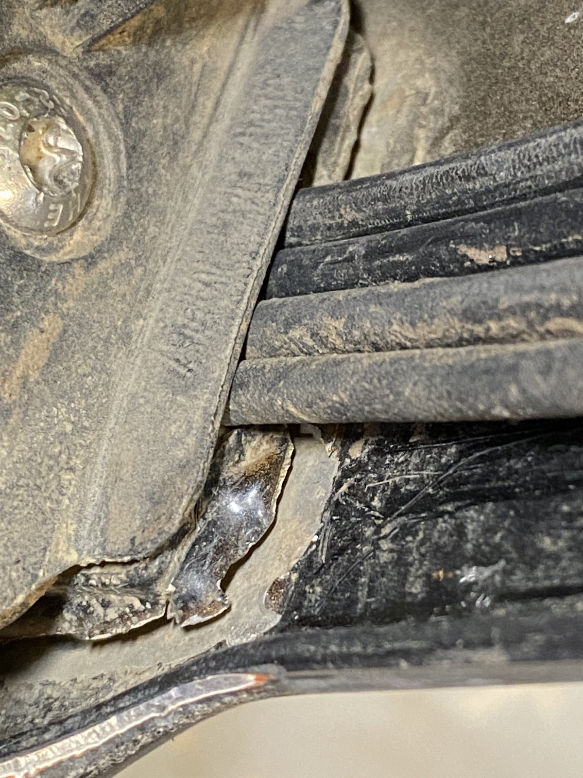

A longer pair of bolts won’t fix it. The problem is that those bolts do not secure to the down tube itself, but to a bracket inside the downtube. The bracket is only epoxied to the downtube and not welded. In my case the bracket broke off. (See attached pic).
If you look at the poster’s 2nd pic you can see the head of the bolts pass through the bolt holes on the downtube and so longer bolts won’t work. You will either need bolts with a larger size heads or washers that are larger than the bolt holes.
