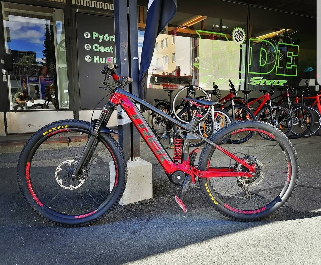

Im wanting a rockshox coil for my trek rail now I've seen a picture on instagram and messaged the guy and he says it fits fine on a large , he fitted a 230x60 and said a 230x57.5 will be fine also anyone else fitted a rockshox super deluxe ultimate coil 230x60 is there much clearance or is it really close

Ok, so I’ve got a Super Deluxe Ultimate coil, test fitted it yesterday on my Large 2021 Rail 9.7. The reservoir definitely hits the frame down tube at full compression. Reaching out to Offsetbushings.com to see if they have experience retrofitting this shock.
