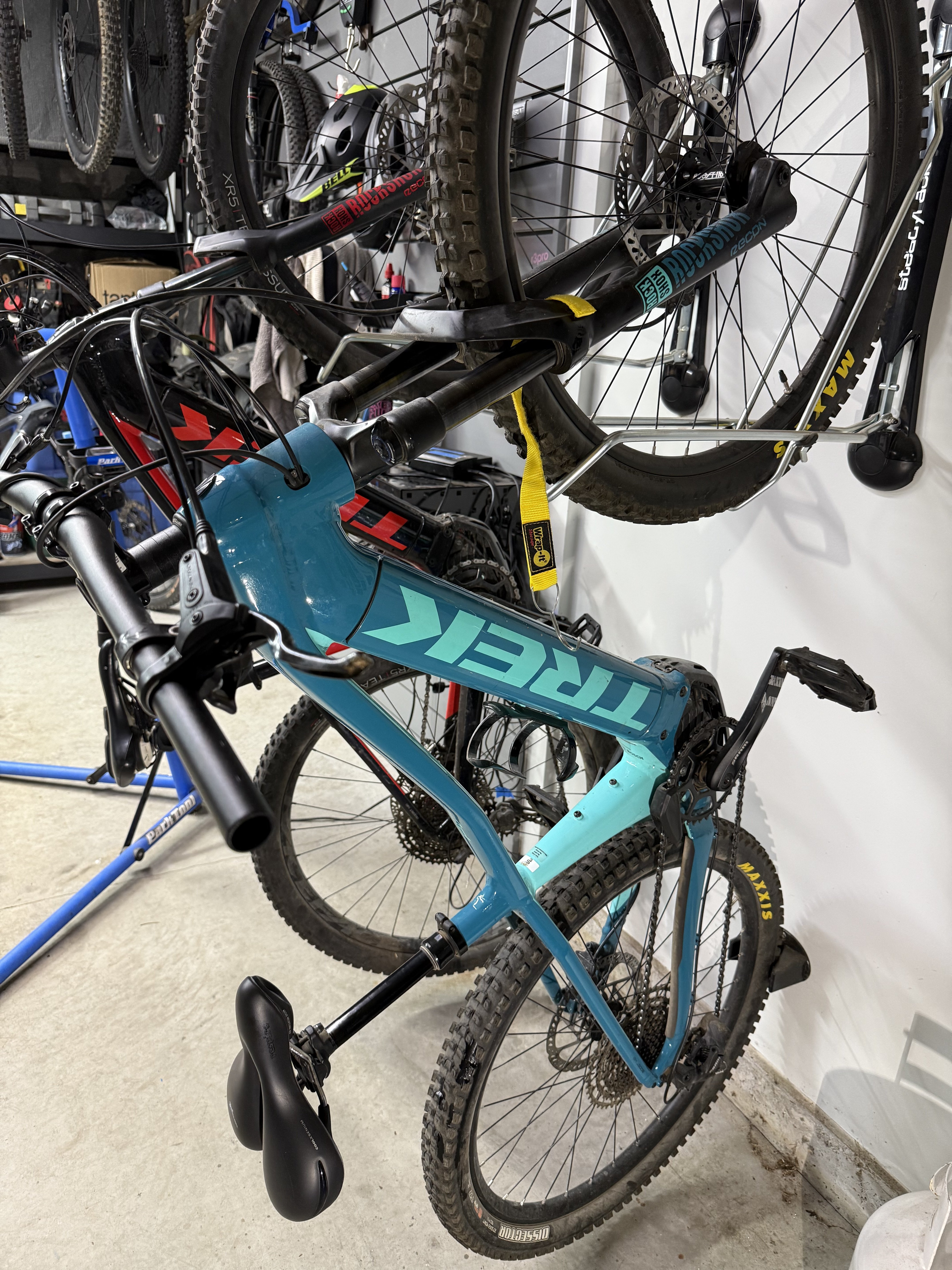

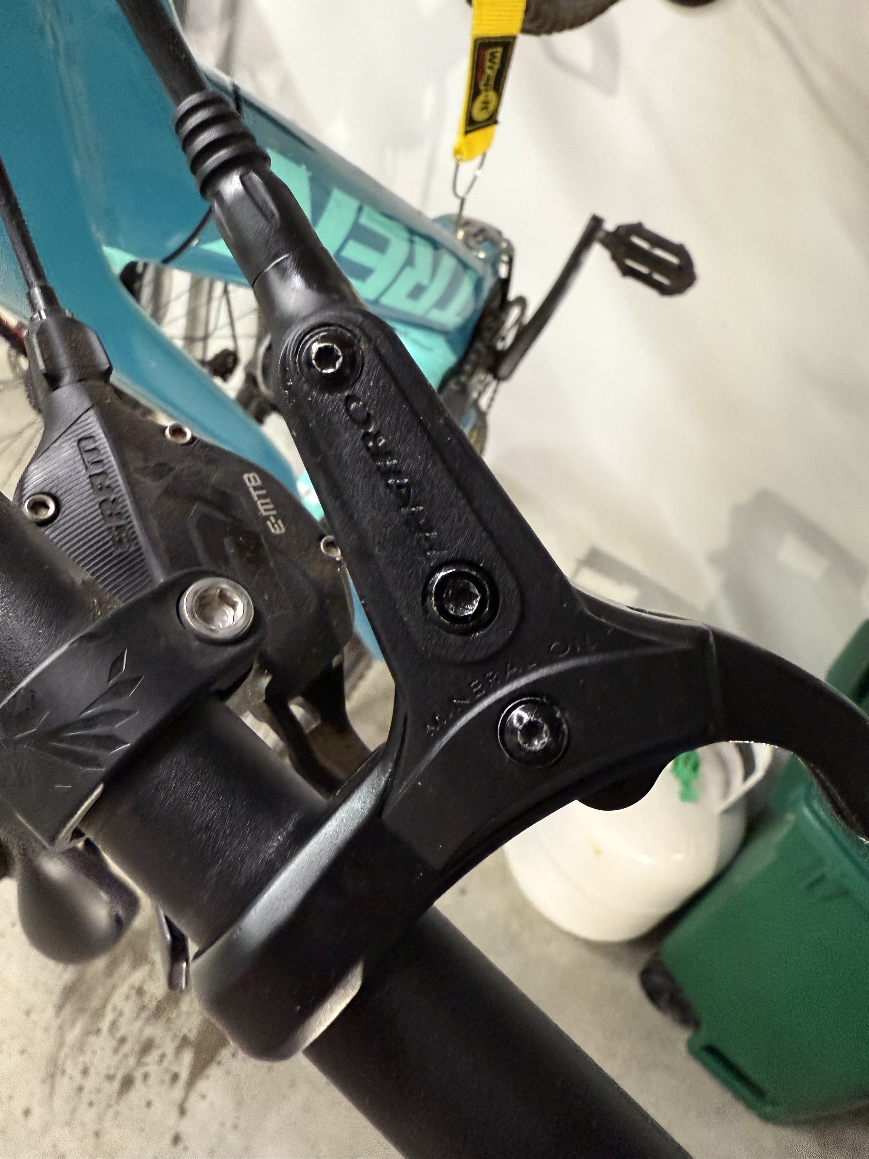

I bought a Trek rail 5 as my first eMTB and now a couple of months later I'm pretty used to it. I love it, it has opened up a new world to me. However. The brake lever travel has started to bug me. Upon investigation and research the Tektro orion 4p brakes are to be matched to 2.3mm rotors and my bike came with 1.8mm rotors. Meaning the brake lever travel before the pads bite the rotor is excessive-1 1/2". Is this common? Should I be expecting the 2.3mm rotors?
Any advice here would be great. Cheers in advance

I have adjusted the reach. It's the length of pull before the pads hit the rotor. It's about 90% of travel.

I've bled them. It was the first thing I did before adjusting the reach. The free stroke is 2 inches/50mm. I have two inches of lever travel before the pads touch the disc. There is no sponginess to the brakes. When they bite to fully locked up is about 5mm. I don't have a problem with the brakes working efficiently, they do. But I have to have the reach adjustment fully backed out or the lever travels almost to the bar before the pads touch the rotors. I've bled the system twice and the lever travel remains the same. My pads have at least 2mm clearance from the rotors. By the time they touch the rotors my lever has gone through 50mm of travel before the bite point.
