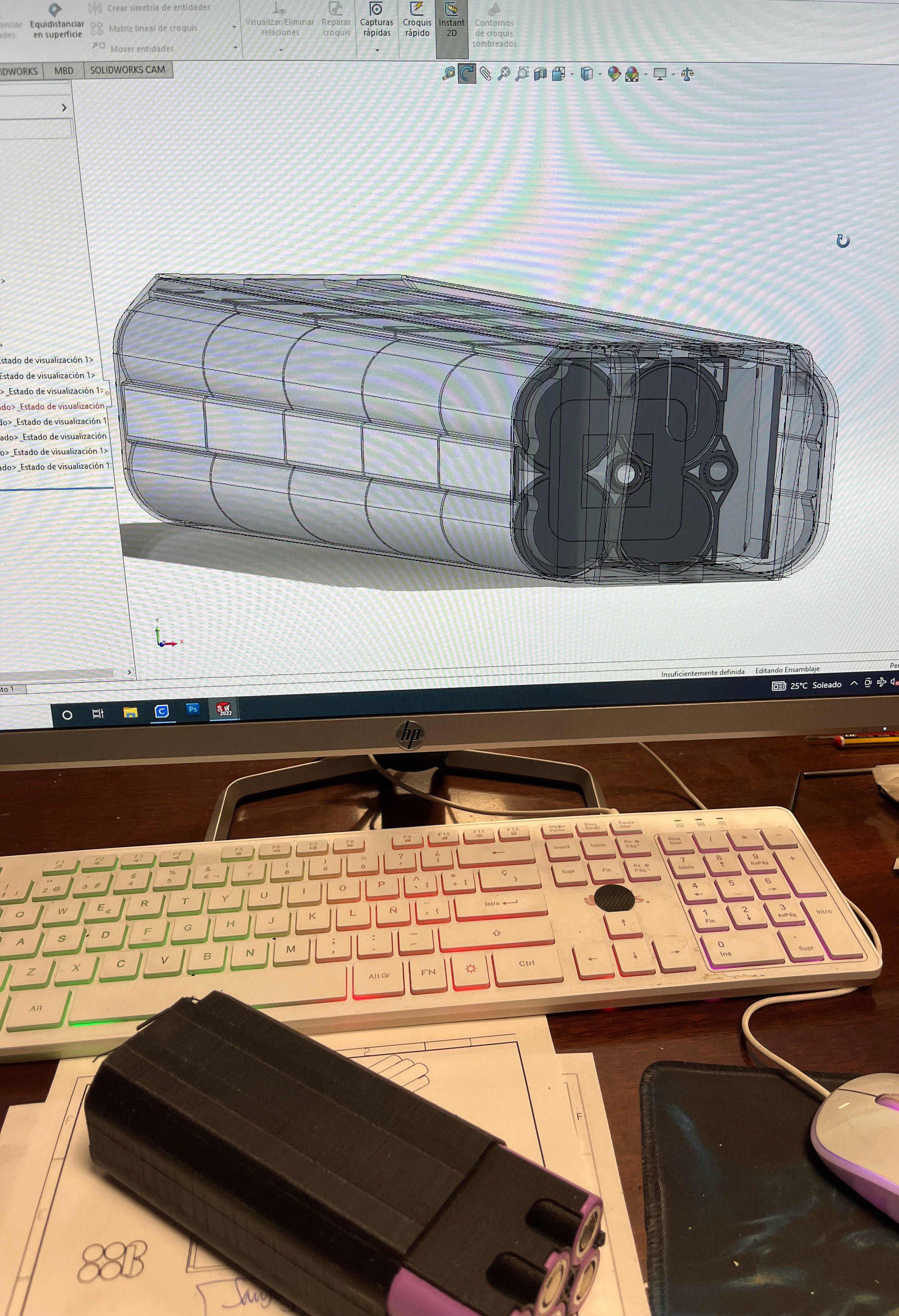

The NLS delimiter has been tested to see how it affects the calculation of the algorithm, it affects negatively by understanding the bike that you are doing fewer kilometers than the real ones, surely the use of a mullet system benefits the calculation of the algorithm.
I'm going to disassemble the prototype to reassemble the original battery and sell the bike, if anyone is interested in it before I disassemble it, tell me something by PM. The exchange for an original battery or the amount that it is worth is contemplated so that I can buy one and deliver it with the bike.
Thanks for all the help received, it has been an exciting project that would not have been possible without you.

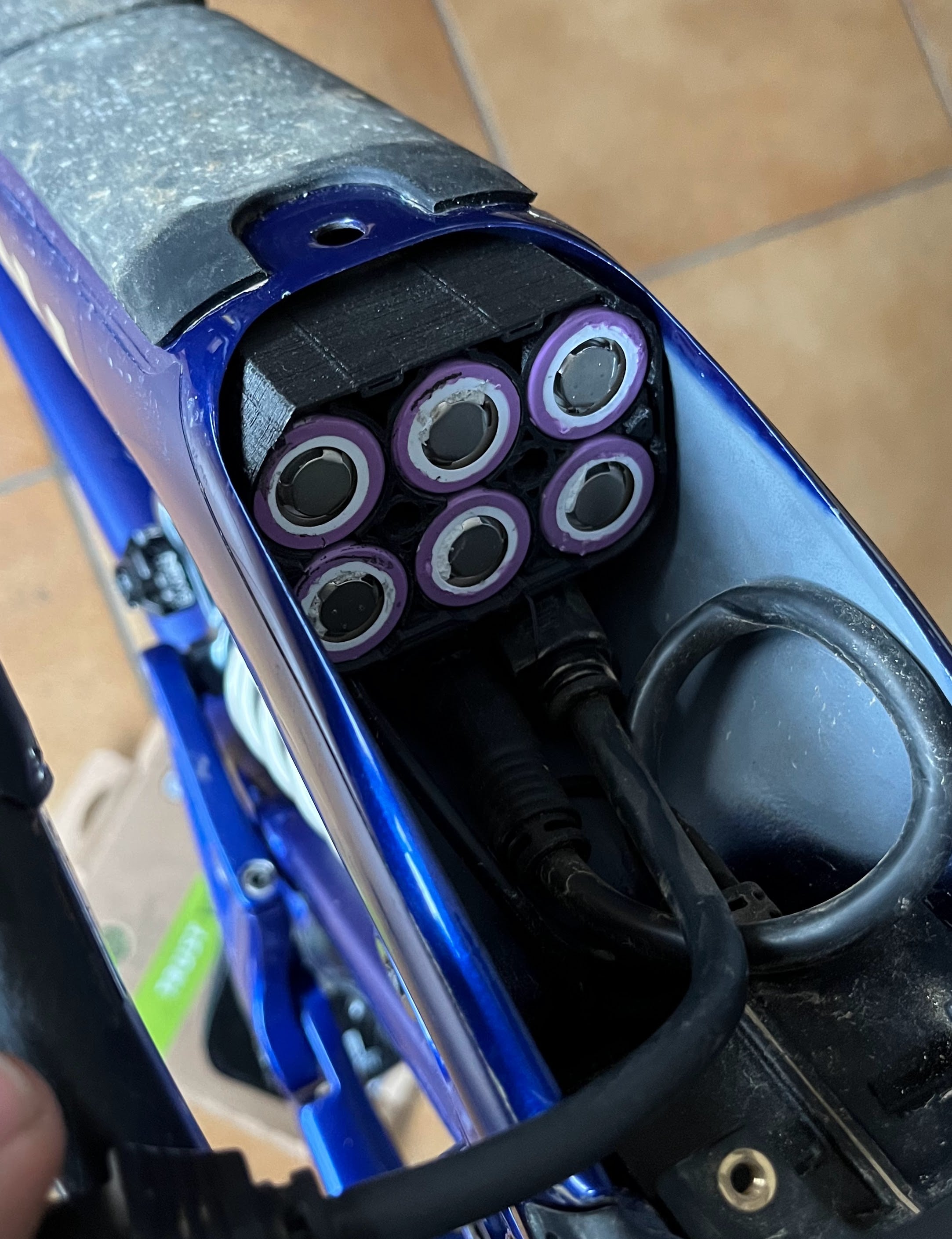

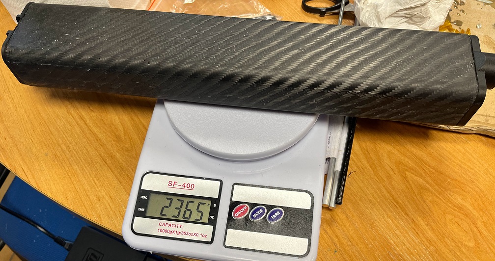

It's called the eXTenderMod. It is an adapter that allows an Ego 2.5Ah battery to securely and safely mount to the frame. The battery is easily removed to be charged separately, and connects to the charging socket. It drains with the main battery, and in testing gives around 34-38% extra range (140Wh). It possibly gives close to as much as the TQ Range Extender due to the way it works, but I don't have a TQ Range Extender to test.
It is wider and heavier than the TQ Range Extender (1020g vs 1650g), but all up the system will cost around half as much. There are more advantages and disadvantages which I'll release by 8th Feb (sorry taking an extra day to test).
I have been refining and testing this system for months, and using the Ego batteries in other applications for years, but I have a few more isolated tests to perform before I release more details.
