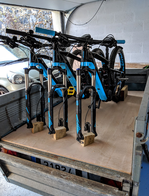

The longest of the JAM2s going in there is 1950mm, so current intention is to reverse them in, front wheel off, and use the front axles to mount to floor blocks, as we currently do in the van. This should allow them to be staggered in a line, while still allowing 12"-14" of useable space in two opposing corners of the load area. In theory....

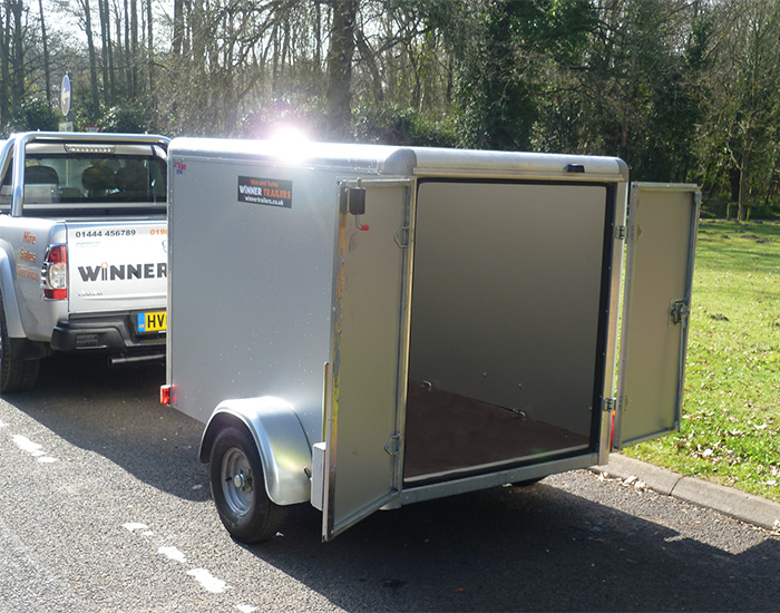

I'd definitely be wanting a full solid cover for the trailer if you plan on stopping anywhere with the bikes out of view for more than 30seconds.
Cool project but you might be cheaper just selling the trailer you have and buying a small S/H box trailer and bolting all your stuff inside that. (it'd give you way more storage space for clean and manky biking kit etc. too)
Thanks Gary. We did considering selling / buying, but the trailer needs to be disassembled on return from trips, at least to a certain extent, so it can keep a low profile in the garden. This almost rules out a full box unless it could be collapsed into panels when we get back. Were thinking of an angled front panel to take the worst of the weather, with canvas back section, but no what you mean about stressing over security. Bikes will be chained down to large welded eyes on the box, but security for us is more going to be a question of location than anti-theft devices.
The axle mounts we've made before from wood, screwed to a WBP baseboard. Doesn't damage the forks / axles and is both light & strong.

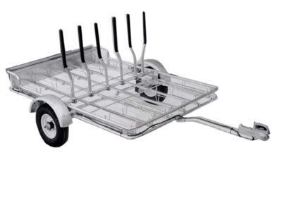

I looked into one of these a long time ago, or something similar, I like your thinking on one you can dismantle.
Trailer Cycle Carriers WhyCycle? - The impartial cycling advice site
at the moment toying with the idea of some sort of trailer box, as I don't like the bikes being exposed to road crap, and am currently vanless.

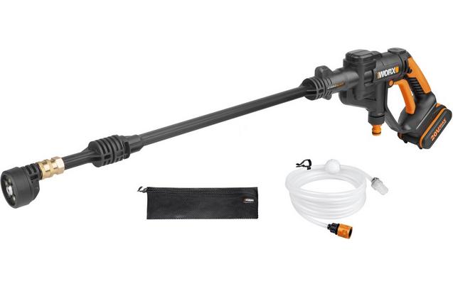

I have a Worx Hydroshot, with a 20 later jerry can. Great bit of kit for a quick clean on the go.
