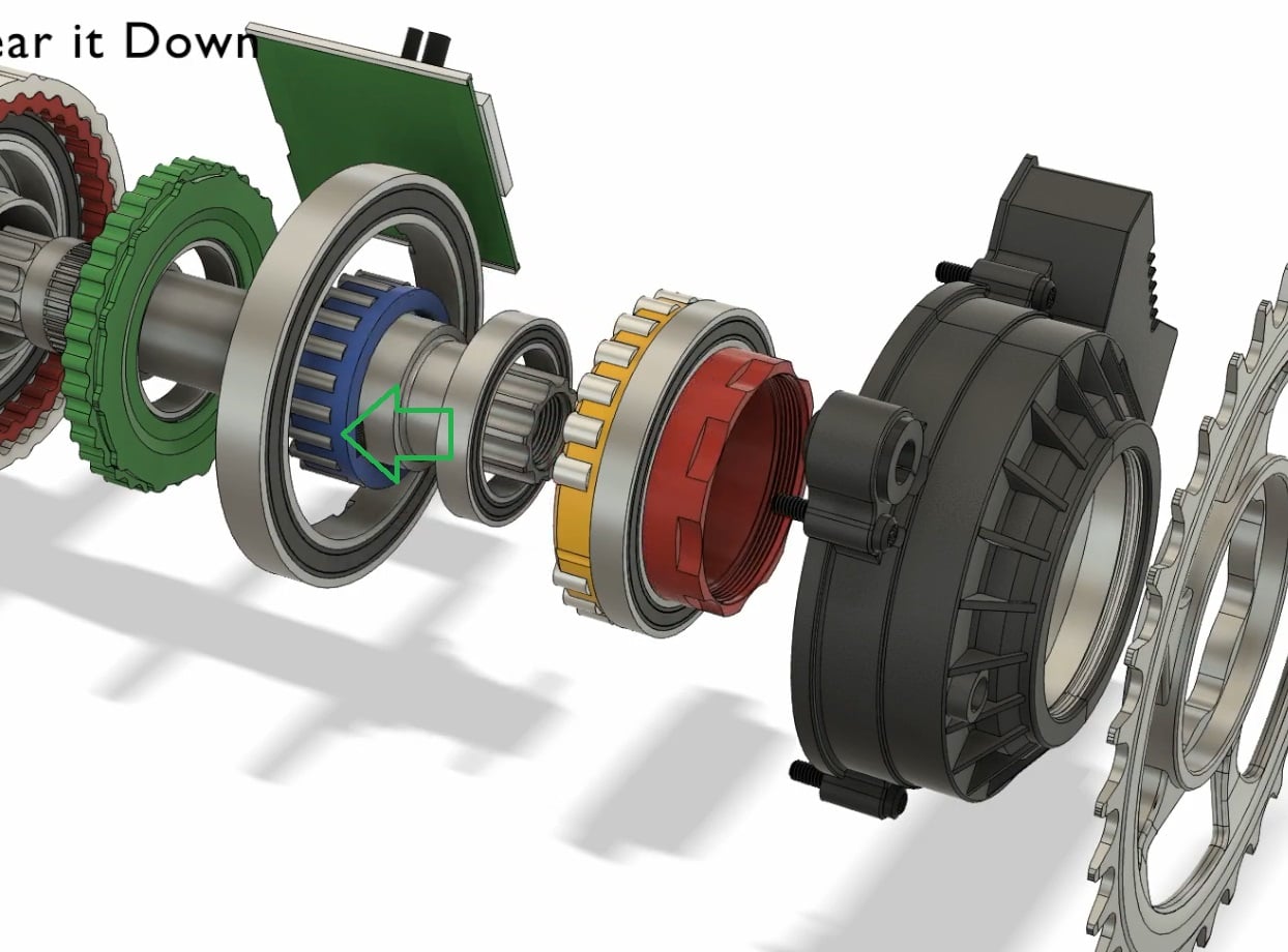

Hi all,wondering if anyone else has had this problem, I'm guessing it means I need a new motor,but thought I'd put it out there anyway.
The bike turns on fine,no errors etc,but when you turn the pedals there is no resistance at all,they just spin without turning the chain ring,it's as if the clutch mechanism that engages or disengages to motor is stuck in a disengaged state.
The last time I rode it it was all fine with no issues, then I put it away in the garage,came back to it today a few days later and I have this problem.
Anyone got any ideas how I can sort it? Have tried engaging walk mode which works fine and propels the bike forward but doesn't engage the clutch, have tried bouncing the bike just in case it's mechanically stuck,but no joy.

The one-way clutch bearing should be the problem that causes the shaft not engaging the chain ring sleeve.
Picture is captured from the video.

Yep, tried all the usual basics,it feels to me like the one way clutch mechanism has failed, the cranks just spin in either direction with no resistance at all.
The motor itself works if you engage walk mode, so it just looks like the cranks/the crank axle have become mechanically disconnected from the rest of the motor.
When you spin the cranks ,the motor registers a cadence,so all the electronics look fine,just looks like a mechanical failure.

Curious to see if there is a water/dirt intrusion that is jamming the clutch. It would not take much to foul the mechanism.

By looking at parts in video, I recon the design of that one way clutch uses two springs to rotate the rollers cage back to normal contact position. It may not have sufficient tension to do the job if there is little jam.
Secondly, I also suspect your weather might freeze the grease there such that there is drag to stop the roller wedging back. You might try to warm the motor with hot hair blower to see if it works when the lubs are in normal working temperature. Warm the shaft, housing, it may take sometime to let heat getting thru.
I did try warming the motor, no success
